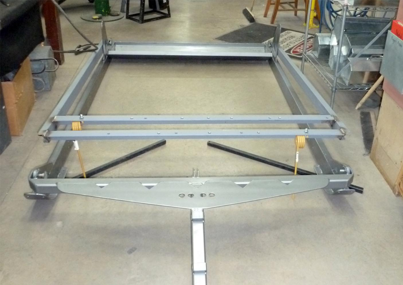

Better picture of the harrow tooth frame.
/ XC drag build #112
Using siderake/harrow teeth to loosen the moguls is brilliant!

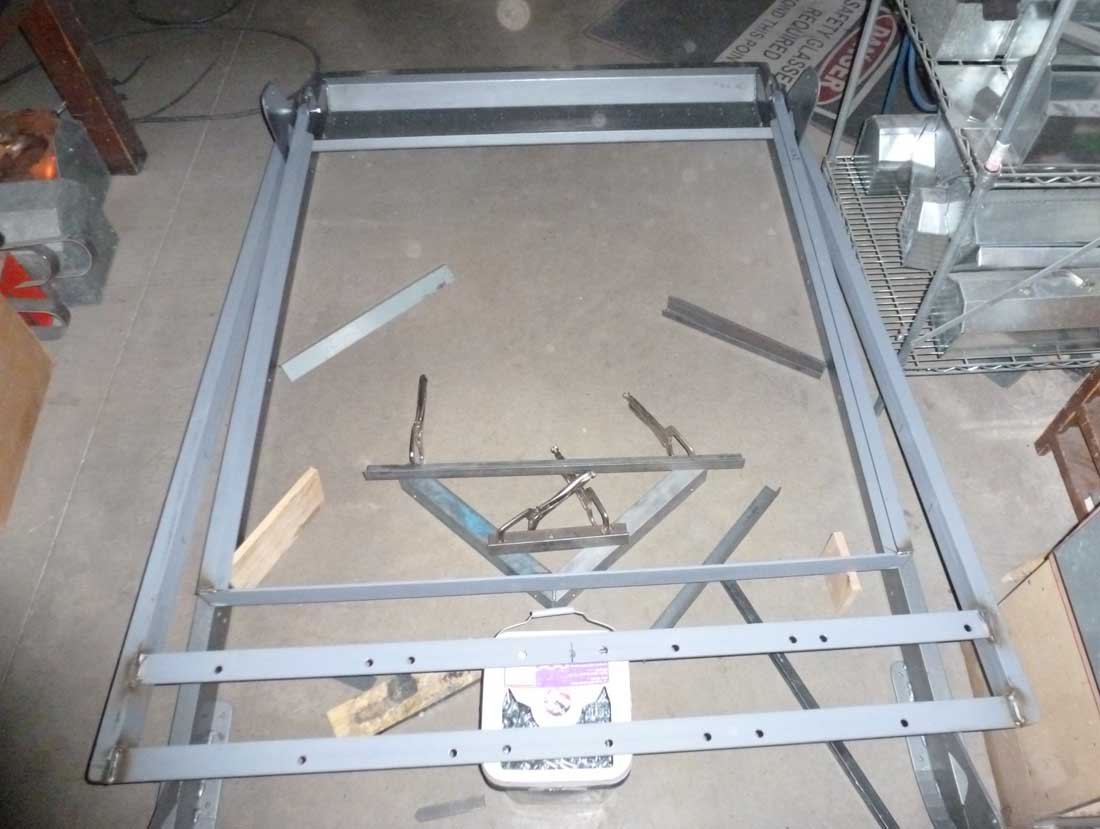

Now the smaller, secondary frame is being added that will have tooth cutting bars inside it. The angles seen on the floor will hold the hardned steel flats with teeth and some diagonal supports for them.
/ XC drag build
#114
I should have added (slow thinker :)) If I get the plastic mounted onto it and the hallow frame painted, I could test it out next week. I'd need some system to lift or hold the frame up for turnaround locations, or if there is a problem with it. What do you think?

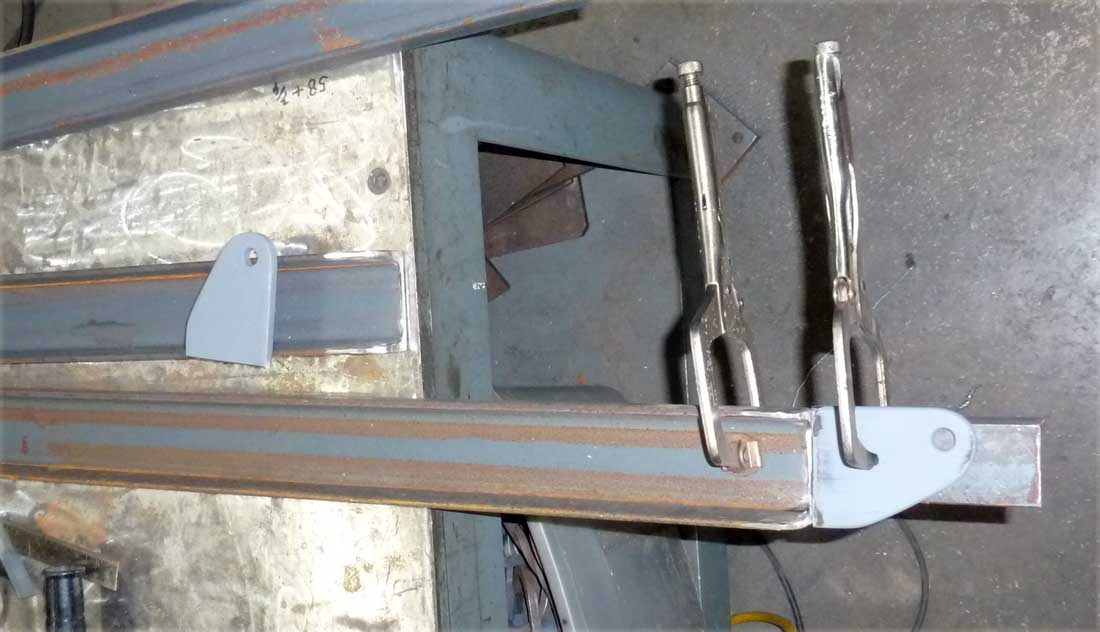

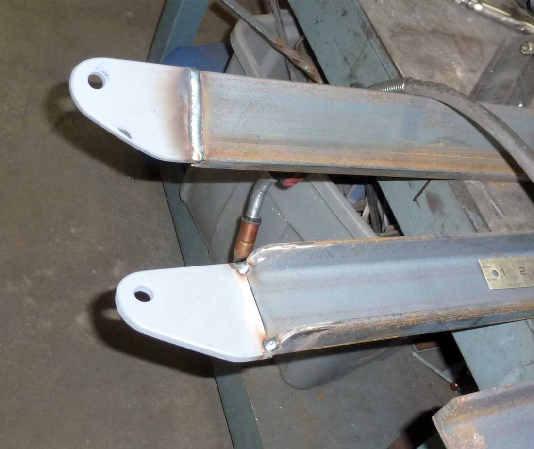

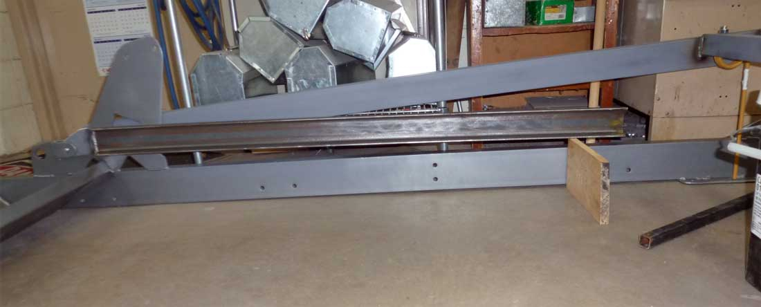

More pics I found in my camera. This is the frames and how they fit in together.
.250 inche plate will be attached in-between them. Plastic wear sheets will be mounted on the frames to go against this plate.
Frames being welded. The primed tabs be attached are 3/8 thick. Any questions?

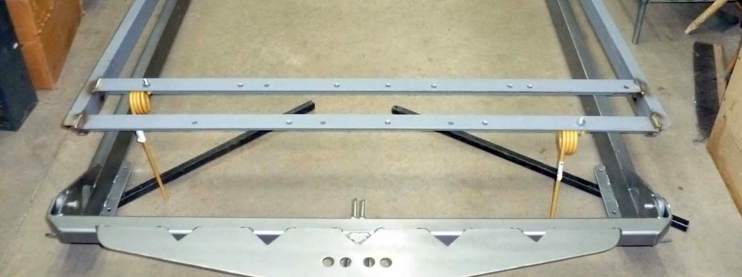

I'm kind of surpized no one has asked why the holes drilled for the harrow teeth, there spacing looks so goofy?
