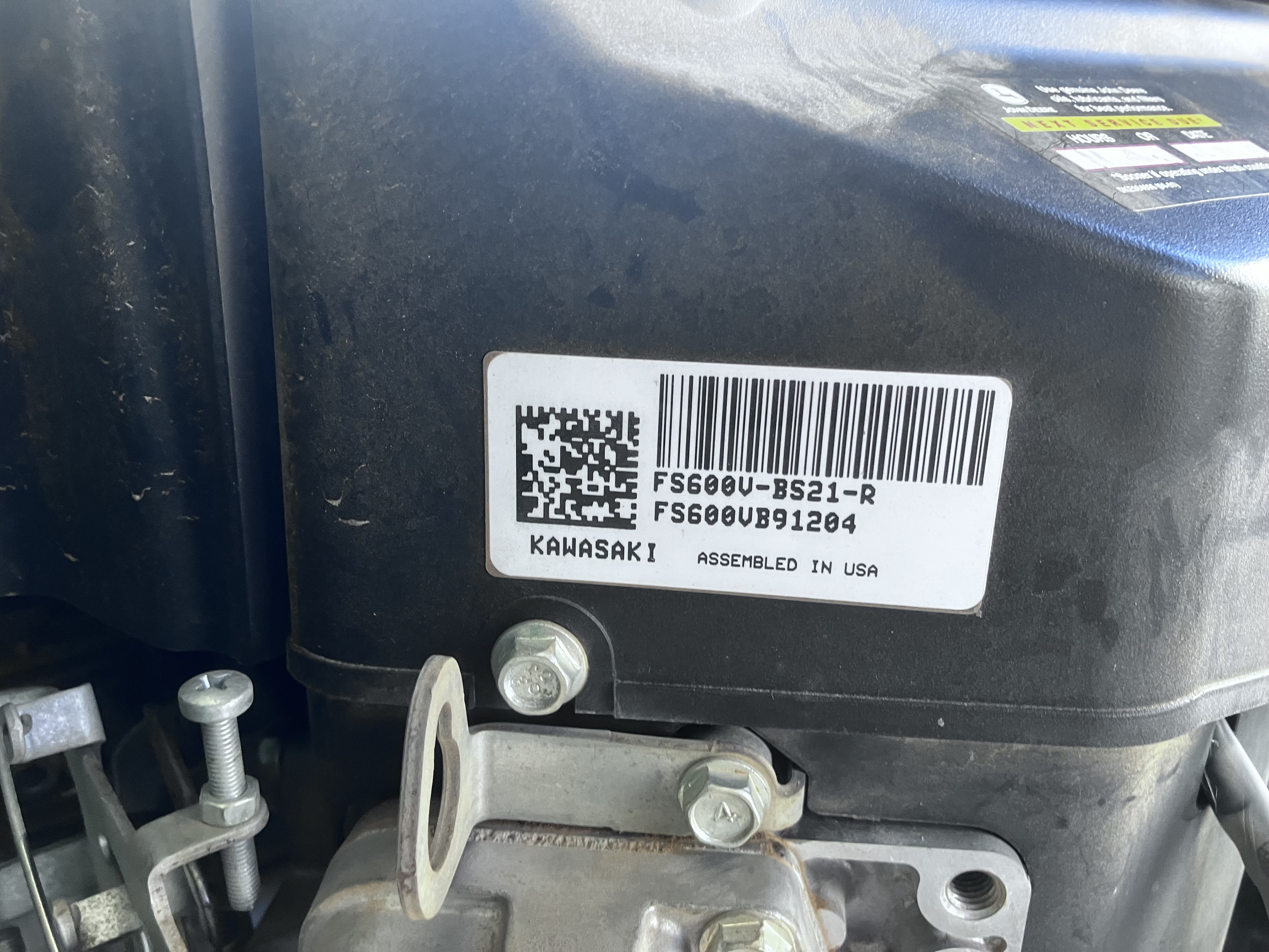

On my third module (AM141075) failure in 6 years. First two times only the ignition kill failed. Third time the module failure caused the 15a fuse to blow, that module was an Amazon module that only lasted two months and they refunded my money. I have an OEM module in route from JD and tractor is running with one of the old modules in place with no kill circuit. Is there a root cause to the failure I should be chasing?

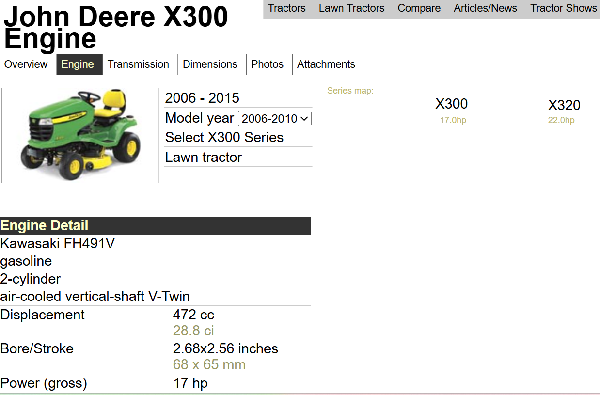

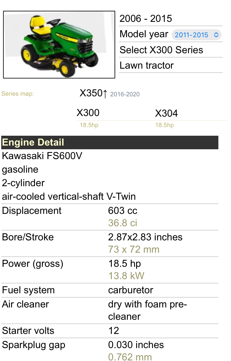

/ X300 Module Failure #4
FH491V }
FS541V } are all fitted to various X300 machines at various ages.
FS600V }
I think moisture is a possible culprit in these module failures.
The casing is filled with a 'latex/silicon' resin and if you look carefully at the very edge often a small crack/gap can be seen where the seal has separated which, I think, can wick moisture in to corrupt the electronics.
We're in a seaside location (moist atmosphere) and I've replaced several of these modules for customers. The early ones were prone to failure and replaced under warranty.
I'd only purchase the genuine JD part to avoid your Amazon experience.
The AM141075 revision is more reliable than its predecessors (AM13661 & AN135490) IMO
