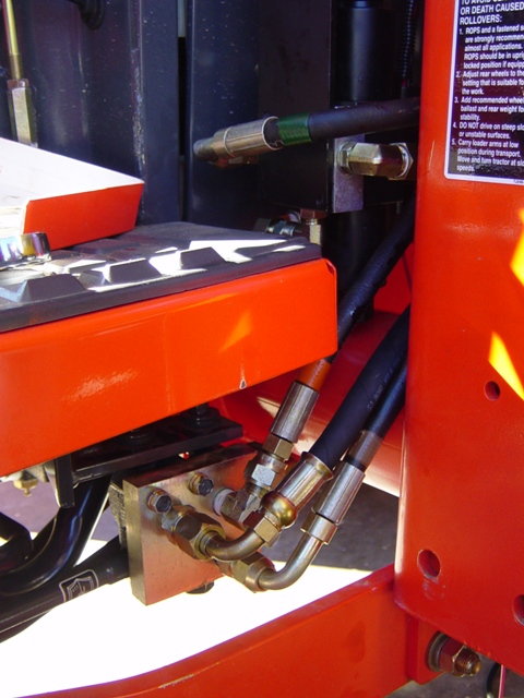

I haven't read thru this thread in a very long time but I DO have the 853 loader and my dealer ordered the WR-Long 3rd-function valve for me. With some minor hydraulics help from them I was able to install it and i use it all the time with my grapple. So I know it works. This was two dealers ago - they seem to go out of business a lot around here.

Hi I checked for a WR Long dealer in Canada and the nearest one is 1000 miles away in Ontario.
I talked to my local Kubota dealer again today and they are now recommending a diverter valve to run off of my dump / curl lines at an estimated cost of $1000 installed. I was really hoping for a true 3rd function valve. Any thoughts on this????
I have another fellow dropping in on his way home some evening this week. He works for a hydraulic shop. Says its an easy job. We will see.
What do you think about the diverter versus the 3rd function.
Russ

The empty spots have no wires leading from them. I cobbled together a fuse leg socket from a crimp-on spade lug type fitting. The inside column of slots are all connected to the main buss and have a socket for one leg of the fuse. The outside of the blank fuse spots have nothing but a place for the other fuse connector. That was where I used a crimp on connector and rigged it to get it to stay put there to accept a new fuse. I have a 3130, so the fuse block should be the same as yours.

Thanks Dave. I actually got it wired last night and never had time to update the thread yet. I had a 2 wire plug behind the seat that is in the cigaret lighter circuit. I don't know why there is an extra plug but I used it. There is also a rubber plug in the bottom of the cab beside the electrical plug. I fished my wires out through the rubber plug. Everything is soldered and shrink tube installed then placed in a wire loom like on your car and secured by wire ties. I already bought the blade it is a HLA 3000 7 foot power angle blade (Horst Industries). It is rated for 30-80 hp and up to 10,000 lb vehicle weight. It makes me a little bouncy on the road as it weighs 900 lbs. All I have left to do is the hydraulic aspect. I am still waiting for a guy to show up on the weekend to do it. I don't have a crimper for the hoses. I already have the second wire harness made up and there is a 2 wire quick disconnect at the loader valve in case I remove the loader. I will solder in a 6 amp diode at the coil to increase switch life as recommended by the manufacturer of the handle (Sure Grip).
Should be good and should be done this weekend,,,, if it doesn't snow.
Russ
/ WR long valve installed #69
Cool. I had the hoses made in a shop. I used 2 short ones to the diverter to "break into the system" and then had them make me 2 long hoses with only one end on them. Then I got everything laid out properly and brought them back for them to put the other ends on so they fit well.

You lucked out;the WR Long kit is a better set-up than Kubota's.Kubota has had problems with theirs,I know I have one.
/ WR long valve installed #73
Kubota's is not a diverter, as I understand it. Just a straight solenoid. The Diveter just switches the curl circuit to the grapple circuit, so you use the joystick to control rate, force etc. It sounds like Kubota's is just open/close so if so, I like the diverter better.
/ WR long valve installed #74
I've had the WR Long diverter valve for a 3rd function grapple for 7yrs without any problems. Great equipment!
