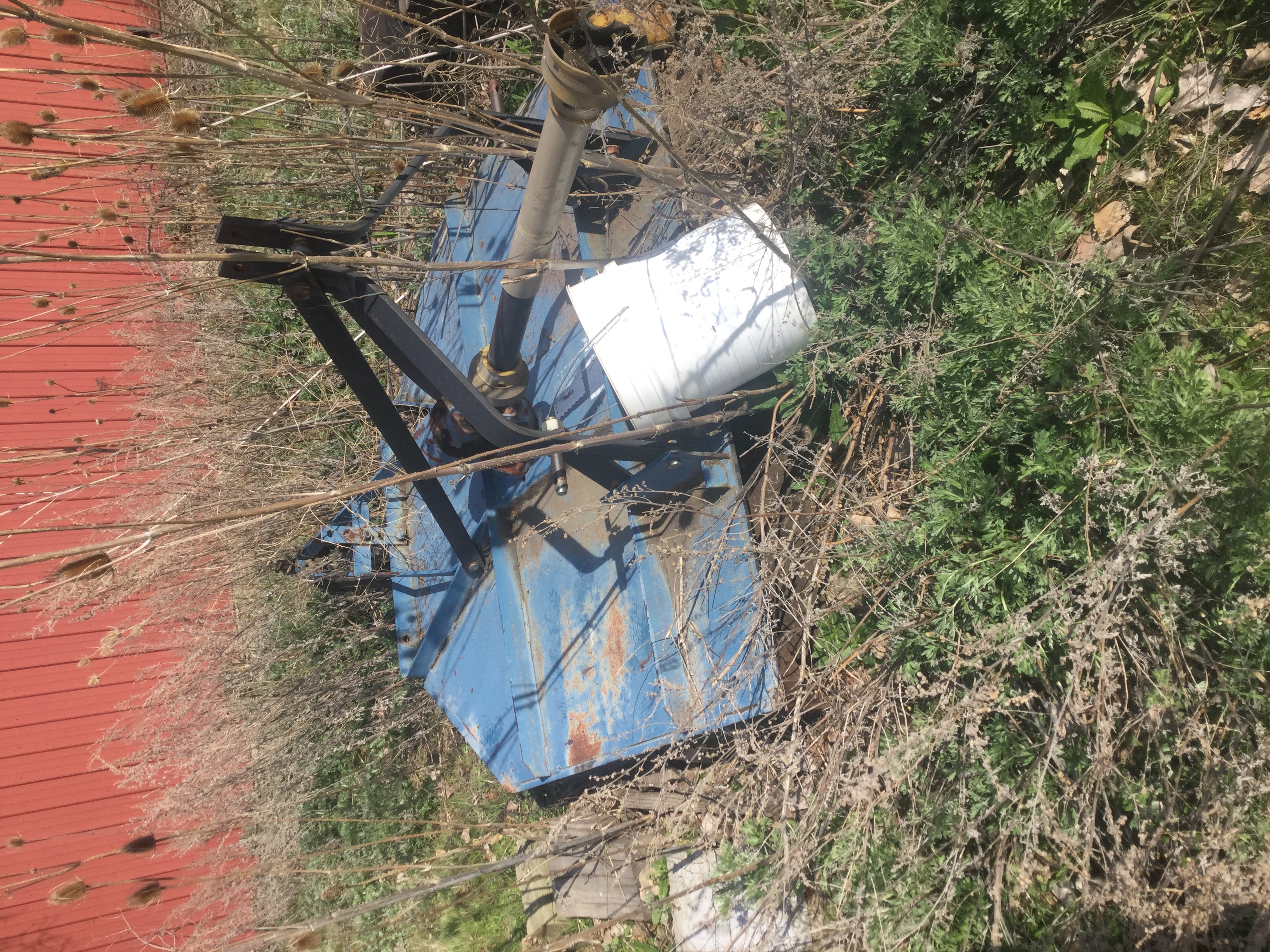

Previous owner of our property left this 5 bush hog behind. I can make out Kutter on the side, barely. I have never used one and I noticed this one has no bolt holes for safety chains or any obvious way to attach something to the front.
Should I try to use this thing, or just sell it and finance a new one with a new tractor purchase? I am looking at an L2501 or similar tractor.

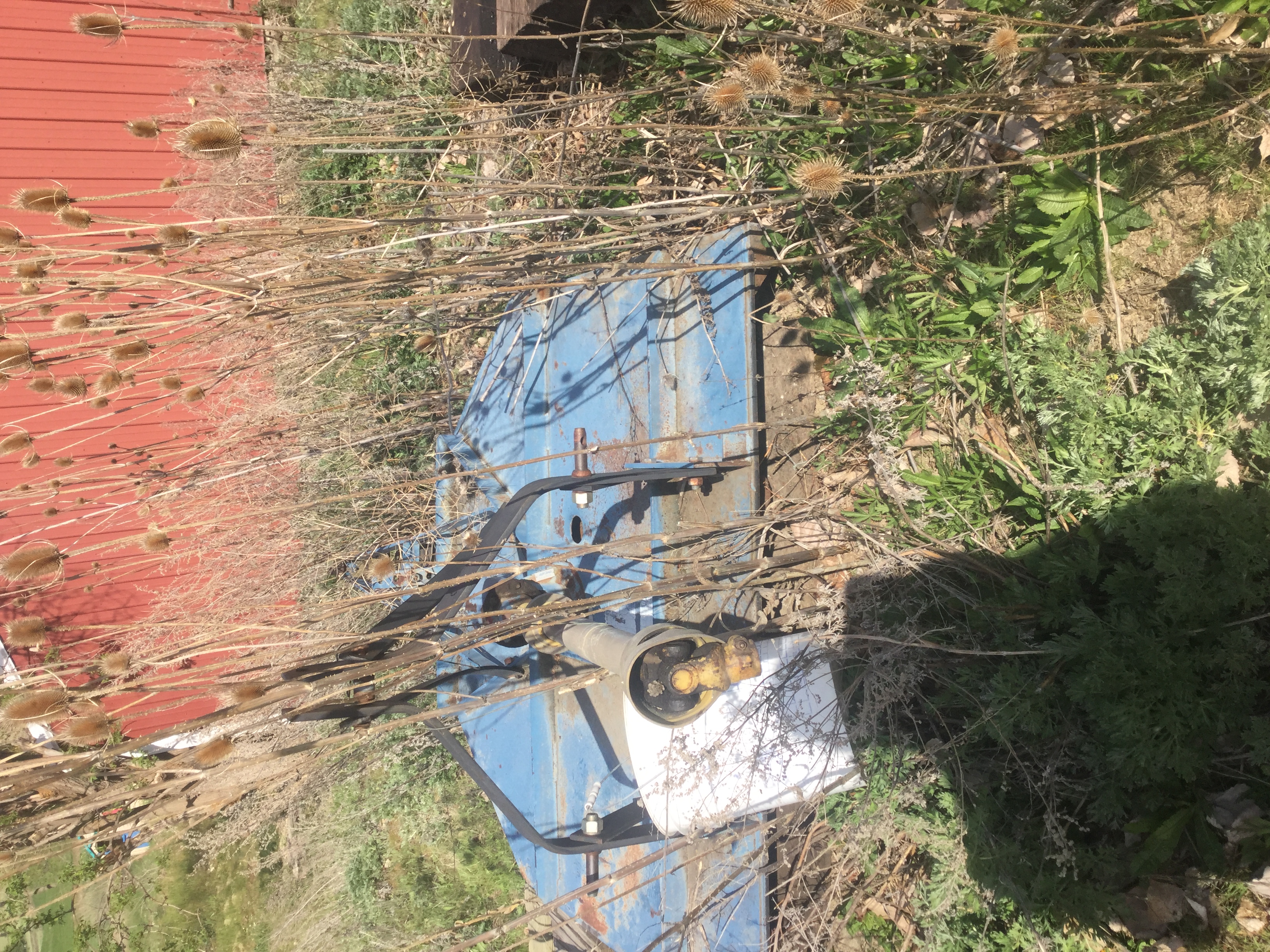

another pic

I would, dig it out and check it out looks in good shape from the pic..

thanks guys. is there a way to attach a front guard to this thing, chains or rubber belting?

make sure the gearbox has oil. make sure the blades bolts are tight.

Looks to be in about as good condition as most. Most don't have any guarding on the front. See if you can raise it off the ground some, and then see if you can rotate the PTO shaft by hand. If the blades turn smoothly, you're good to go. Make sure there is oil in the gearbox.

i can rotate the shaft now. ok, i will try it out, if too much stuff gets thrown out i will rig something up.

I had a King Kutter, looked somewhat similar and also the color. Mine was a light duty unit but OK for grass etc. Not big saplings

Okay, so I cut through 8' tall brush with a 4' King Kutter rotary cutter and a 15hp Shibaura. No guard on the front. Most rough cut mowers do not have a guard on the front.
Power that cutter up with your Oliver. If it spins without much vibration, you're good to go.

I would use it. Make sure to check the gear box grease before spinning it up.
/ would you use this bush hog? #15
I would try it out first with my new tractor, and if it isn't any good- then finance a new one. From the pics it looks fine. I certainly would drain and fill the gearbox....
/ would you use this bush hog? #16
For sure - lift it up - clean it up - change oil in the gear box - give it a try on your new tractor.

5’ running hogs in decent condition go for 500-800 here (more of course if you want like-new). Not chump change but shouldn’t break the bank. And if you want to buy you a used tractor many/most come with serviceable shredders.

As other already said for checking also try remove the blade before attaching to tractor maybe add little anti size to threads.
/ would you use this bush hog? #19
Heck of nice gift ex owner left. :thumbsup:
+1 on the never seize.
will do. maybe i can loctite the bolts
I wouldn't recommend using locktite.
