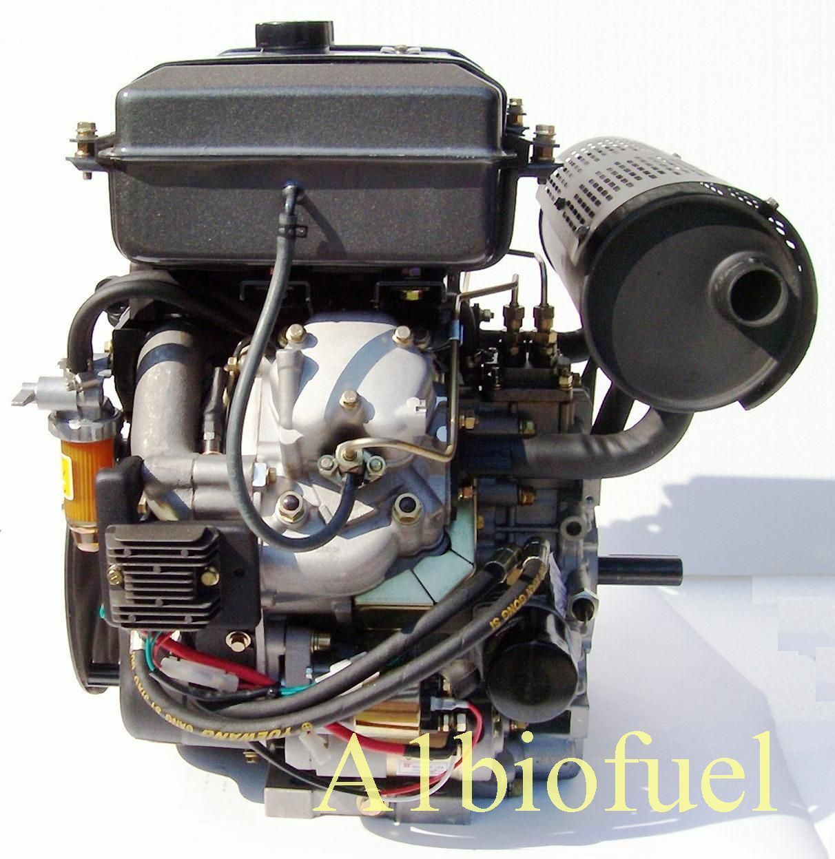

Well, I'm approaching 1,0000 hours on my CH-25 powered one, similar to what MossRoad has. I'll have to say that it is the single best investment in tools that I have ever made. There's no way I'd attempt to maintain my current hillside property without one...
I'm waiting on someone to install and try one of these Chinese twin cylinder diesels, and report back:
22HP V Twin Small Diesel Engine $1499 New Air Cooled 1" Shaft 2XPOWER of 10HP | eBay
My Kohler is still doing fine, but operating on these hillsides, outside it's design spec, it's now starting to blow a puff of white smoke on start-up. There will come a day when I pay the price for abusing it -- just as I have had to pay the price of increased torque from my huge wheel motors... :laughing:
   / Would you buy another PT? #74
   / Would you buy another PT? #75
   / Would you buy another PT? #76
I'm guessing that is 60 kilograms -- roughly 132 pounds... in fact the Net Weight spec is labeled 59 kg.
As far as peak power, that's common for what's reported on small engines.
   / Would you buy another PT? #77
I believe you are right about the kg.
1 kg = 2.20462 lbs, so 60 kg= 132.27 lbs
