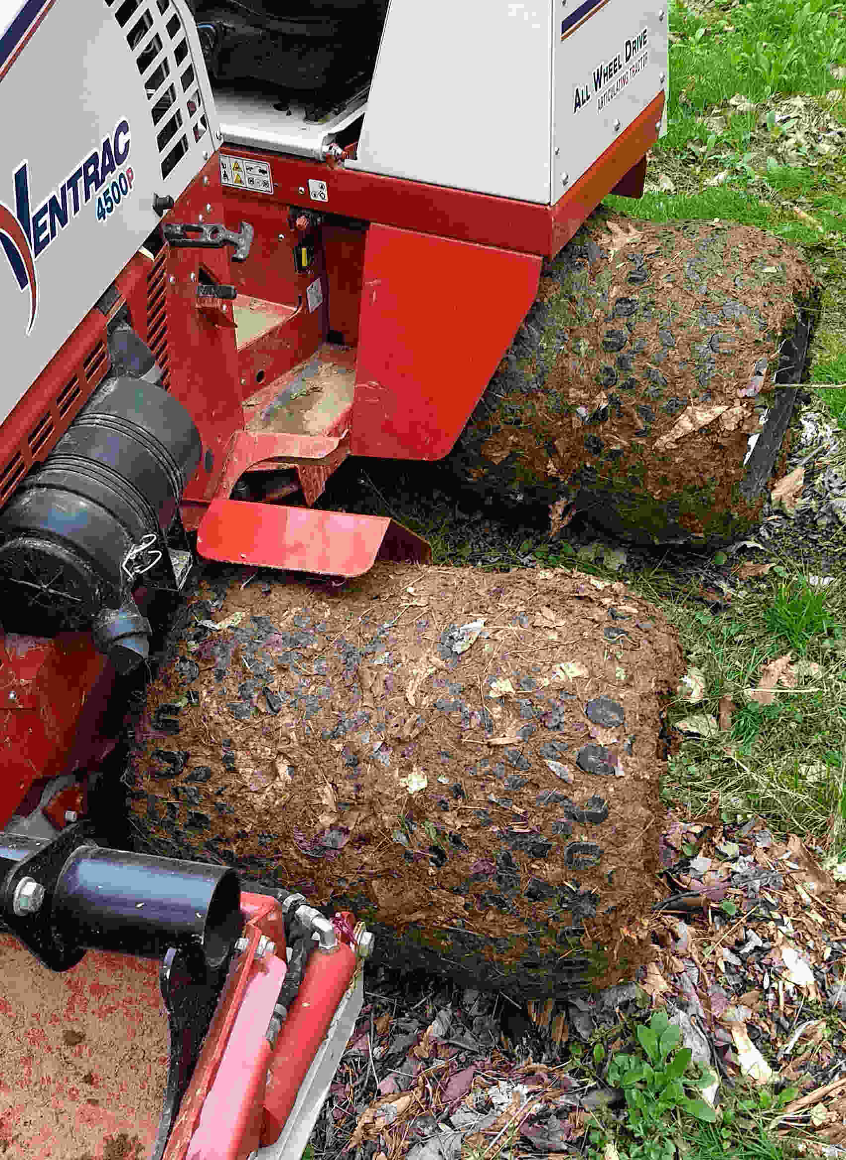

After rain I went out to cut more drainage in my trails when the clay bunched up in between the tires.
This was terrible to clean out using a hose and a stick.
I'd be curious if this has happened to you?
You may be asking why I did this after a rain and the answer is with mostly clay, there is no chance of moving it if it is dry.

We have a lot of clay around my property, and it can be a mess. I usually use a pressure washer to clean things. Works better than the hose.

You need to do like what Rock trucks use between the duels. A bar hangs down between the wheels keeps them clean.... jim

I once did some late, very wet fall, rake work with the extra wheels on the Steiner. Same thing! Funny, because the rims are pressed together, but dirt still gets pressed in there somehow.

the tires move in and out .... no place for the mud to go but in..... jim
