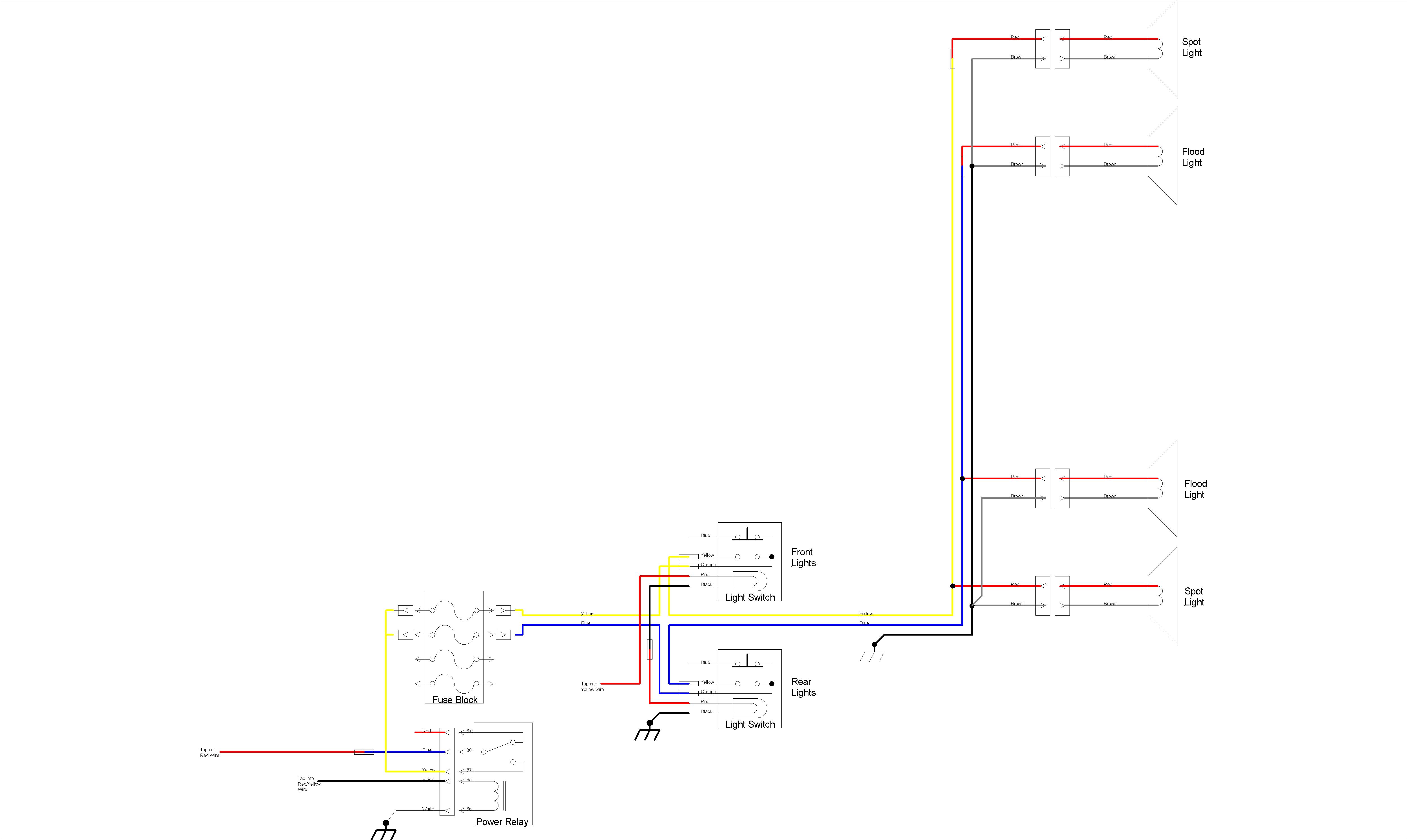

Next is the wire gauge. I am going to wire everything up using this wiring diagram: http://216.77.188.54/coDataImages/p/Groups/183/183657/folders/273951/2227786wiring.JPG
I will run 10ga wire from the battery to the 30amp inputs on each of the 2 relays. I will then run 14ga wire from the switched fuse panel to the new push button switches into Pin 86 on each relay.
2. Can I run 14 ga wire from Pin 87 on the relay to each light, or does it need to be 10ga wire? The short factory power wires on each light are only 14ga wires.

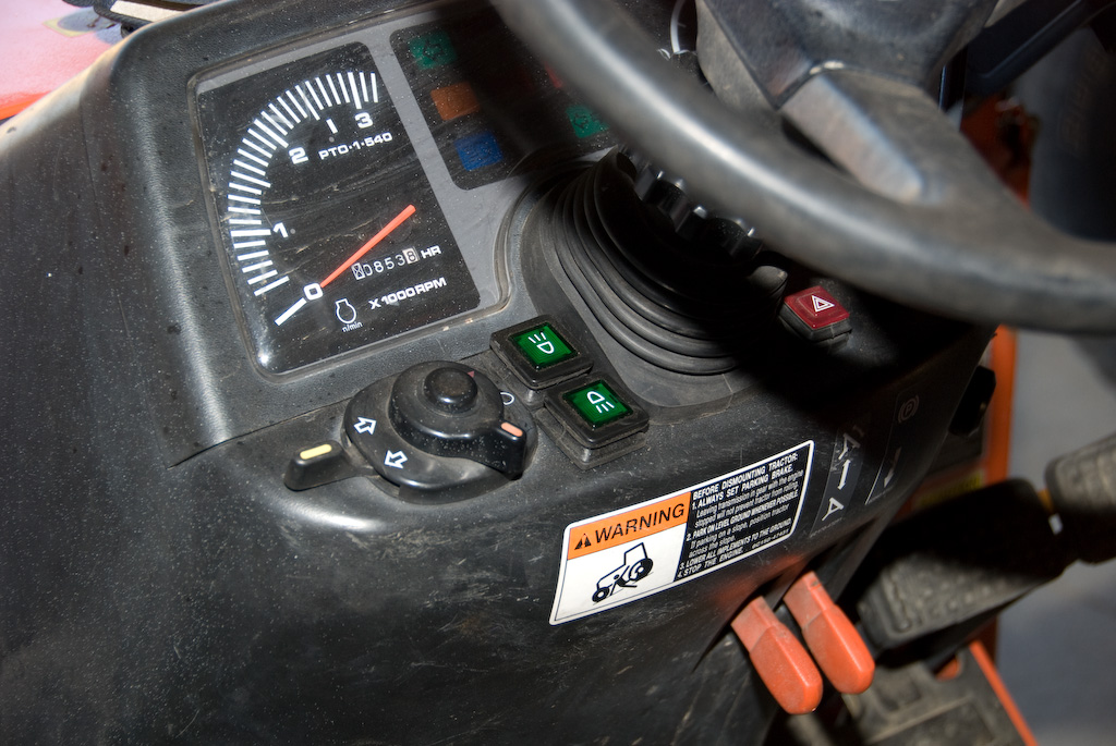

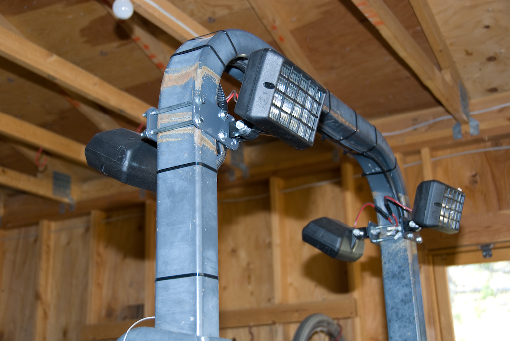

Here are a few photos of my installation. I used some 2 pin inline connectors at each light in case I ever need to remove/replace a light. With the switch lights wired in series they seem to match the brightness of the other dash lights and they will probably last forever. If one light burns out though both will go out (like the old christmas lights).

Check out the diagram. I am putting a 30 amp fuse right behind the battery, and running 10 gauge wire from the fuse to each of 2 relays, then running 14 gauge wire off the 2 relays to the 2 sets of lights. The switches are being used to switch the relays only, so minimal power is running through them. I'm not putting any other fuses inline. As far as I know, I don't need any more fuses than the one before the relays.
/ Worklight wiring questions for you Electrical Gurus #8
Should work fine they way you described it. You could add additional fuses after the relay's to protect them if you wanted to, but they are pretty cheap at 4.99$ for a 12v 30a 'foglamp' relay.. so you are not out much if on'es contacts smoke.. which will not be likely since you are fusing at 30a anyway. so.. yeah.. pretty safe with the supply side fuse.. etc.

I finished wiring everything up and everything worked perfectly, first try.
Switches look good, too. I may dim the bulbs inside the switches if I think they're too bright at night.
I'll probably head out tonight to check the aim of the worklights. I'm interested to see just how bright the factory headlamps plus another 110w front and 110w rear up on the ROPS are going to be. Should be plenty bright, though.

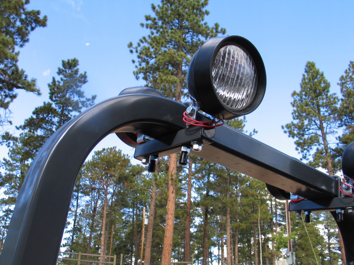

Bandit, that looks really professional! What do you light mounts look like?
Where did you get these Kubota switches and do you have part numbers. I would like to do the same thing on my M 6800. Also what is the source of relays that you used? Thanks!!
#11

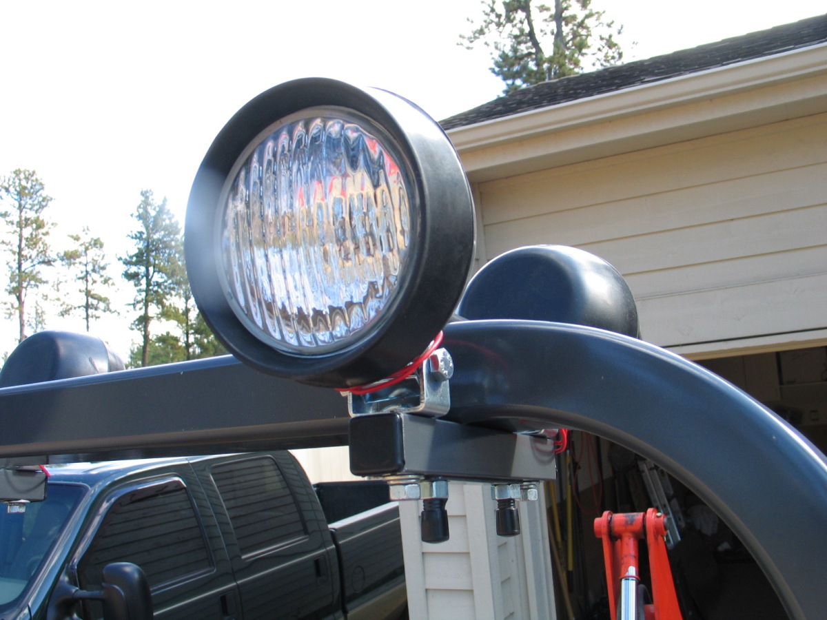

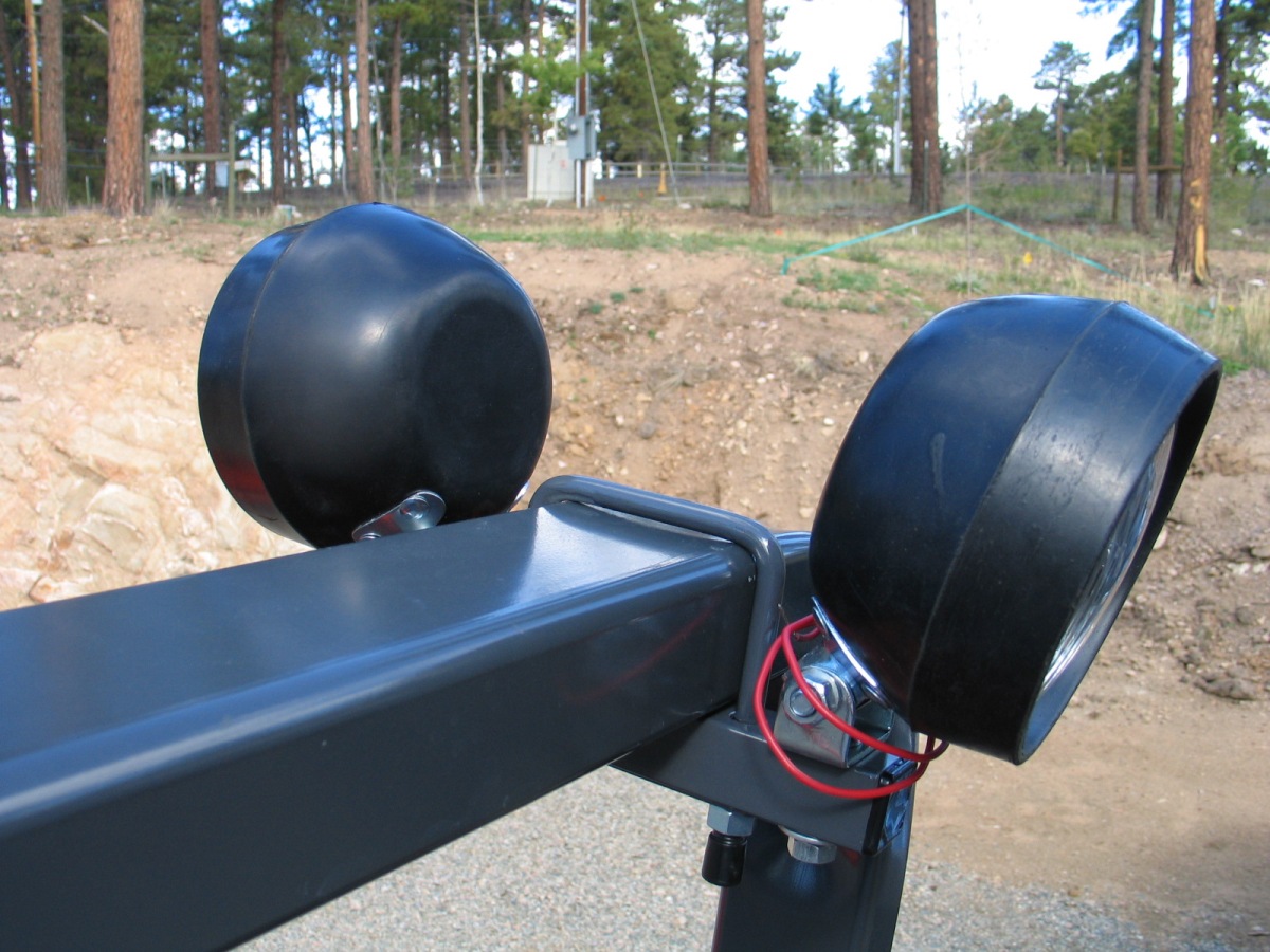

OK, here are some pics of my bolt-on brackets before they were wired.
The 2 light switches are from an L39, I think, and the part number is 36919-54222. I ordered them from my dealer - they were around $33 each.
Relays - I had a local auto parts store order them in - I brought in this wiring diagram I got from another TBN member so we could match up the relays - around $10 each.
http://216.77.188.54/coDataImages/p/...7786wiring.JPG

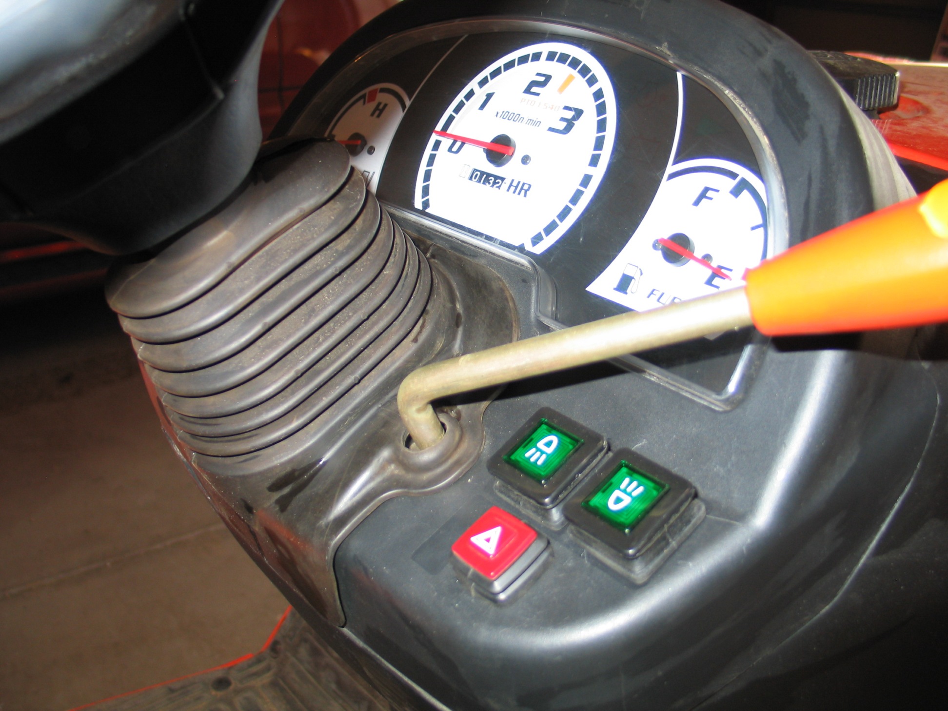

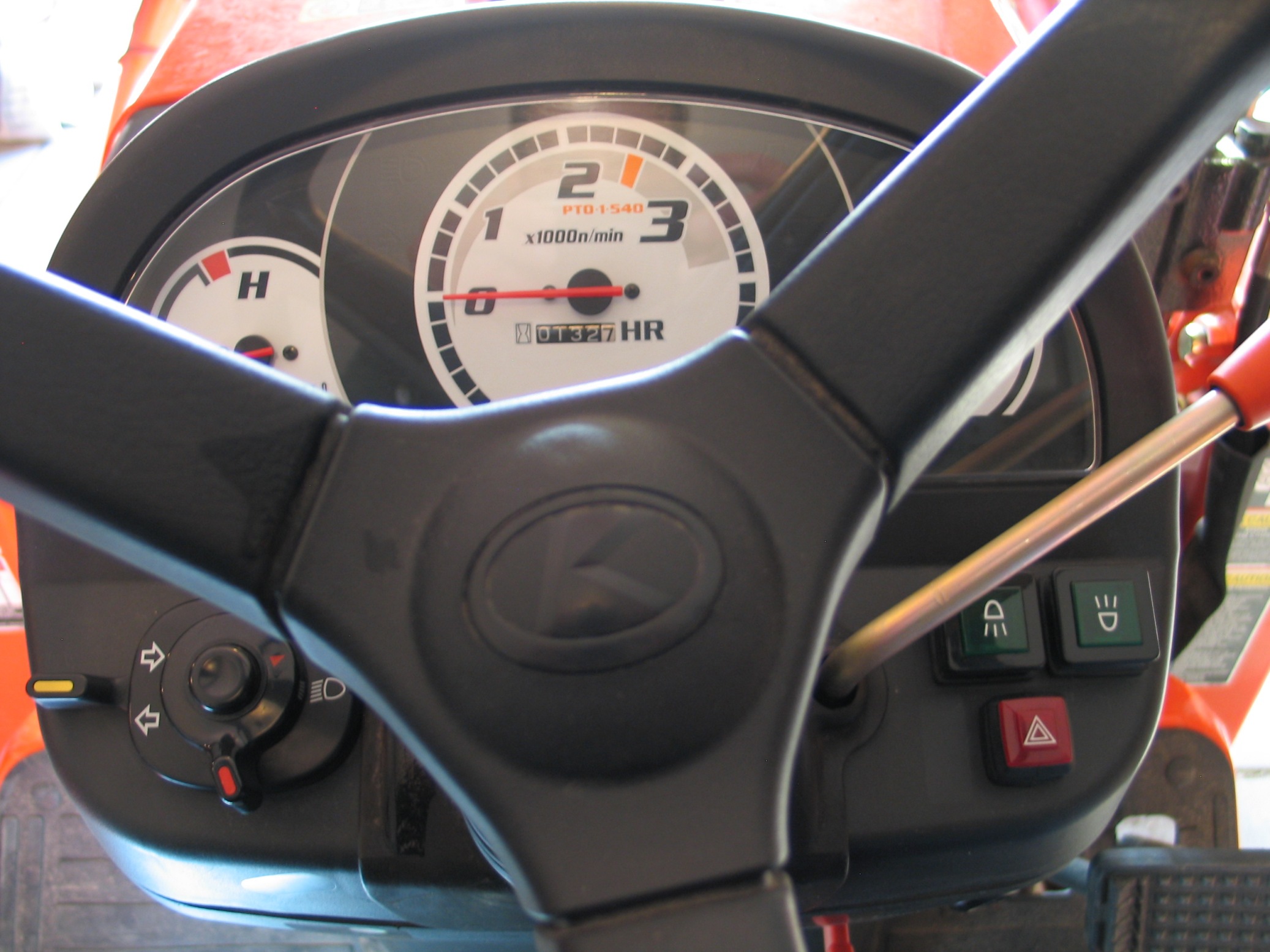

Bandit, I now have the same Kubota switches you have. Can you help me in wiring them? I know the pair of wires ( black and red) are for the ground and power to the bulb on the switch. How about the top three, yellow, orange and blue. I assume I use only two of these. One to the fuse box and the other to Pin 85 and to the red of the first pair I mentioned. Is this right? If so, which two connect to the fuse box and to pin 85? On my switch, the orange one is in the middle. Sorry to trouble you

Yes, the wires are plastic loomed and zip tied to the ROPS. Worked great last winter.
Harold,
I can't remember much of the wiring. I thought I took pics of the connections, but I can't find any, so I must not have done it. I know I had to do some testing with the meter to determine what needed to be connected to what. I would have to pull some of the dash apart to take a look at my wiring.
I remember pulling the switch apart to look at the internal connections on the 3 wires to determine which one was which. Once the switch was apart, it was pretty easy to determine which one was the ground (the switch was connected to that wire both in the on and off position). I remember the other 2 being a bit tricky, and can't remember if all 3 were connected or if only 2 were. Like I said, I'm going to have to pull it all apart to take a look at the connections to re-aquaint myself with what I did.
I did wire the small bulb inside the switch to a wire from the factory lights that only is powered when I turn on the factory lights. However, I powered the relays through a switched ignition wire, so I can turn on the ROPS lights without turning on the factory lights, but only when the key is on so that I don't run the risk of draining the battery.

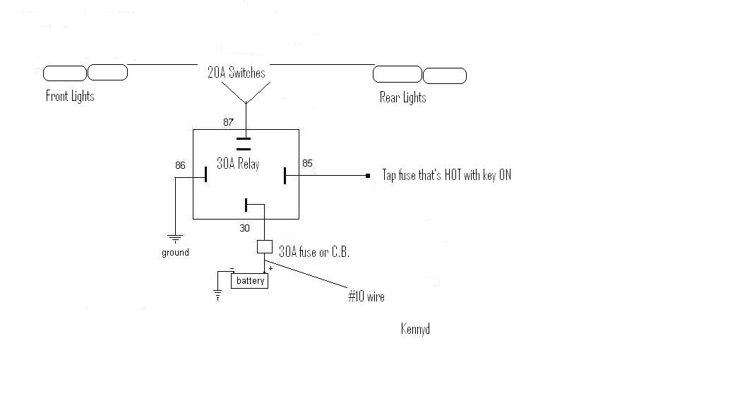

I think some of that may be a bit off.
I ran a 10 gauge wire with a 30 amp inline fuse directly from the battery to the 2 relays' Pin 30, just like in the diagram on the first page of this thread.
Pin 85 is a ground wire - connect that to the tractor.
Pin 87 is a power wire to the lights
Pin 86 comes from the dash mounted switch, so that the relay is only able to pass the 30amp battery power through pin 87 when you activate your green Kubota switch.

I think from what I have read elsewhere, pins 85 and 86 are interchangeable, and it would work both ways. There is another diagram posted many places that show using 86 as a ground. That is the only difference I see between your wiring and what I propose. Again, thanks. I sent you a private e-mail you can disregard. I was not sure you would see this posting.
I am using LED lights by Truck-Lite instead of halogens. They pull very little amps (I think 1.2 each) I tried them out in my yard one night with a 12V source and they look good. I am placing two trapezoid spots on the front and two floods on the rear. I will wire them separately on two different relays.

Here is a diagram I drew for some others...might be of a help to you.
