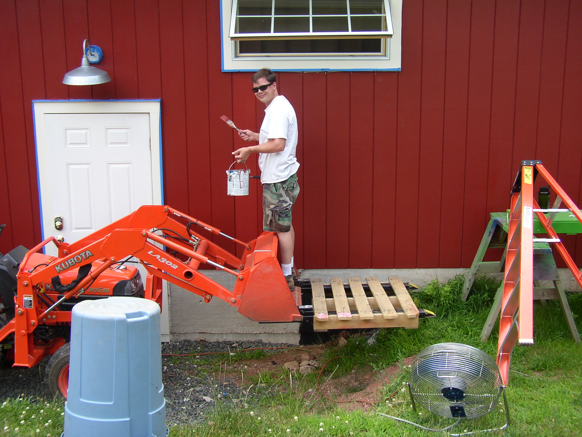

My solution is to park the tractor and climb a ladder up to the bucket to have a working platfrom. Could you add a sliding ladder to the side of your platform so that you can work by yourself?
Eddie
Eddie,
I loved your pic...yes, that is more like I had to do last night. I also generally work alone. A huge dead tree fell a few feet from our house and I had to climb up and prune what was left.
I leaned the ladder against the raised FEL just like you did in your pic. But I then chained the ladder to the FEL and adjusted it to be under slight tension on the ground.
Everything was very solid and secure. The ladder was mostly just to have something to hold on to and to climb to get up to the FEL platform, like you did. I then used an extension electric chain saw on a pole to prune from there (I think it is a Toro).
I am going to pick up a mountain climbing harness as well today, and will clip it to the FEL (or secured ladder) as added safety. With this system, I definitely feel much safer than just climbing a ladder. I'll post some pics later. BigfishTX
