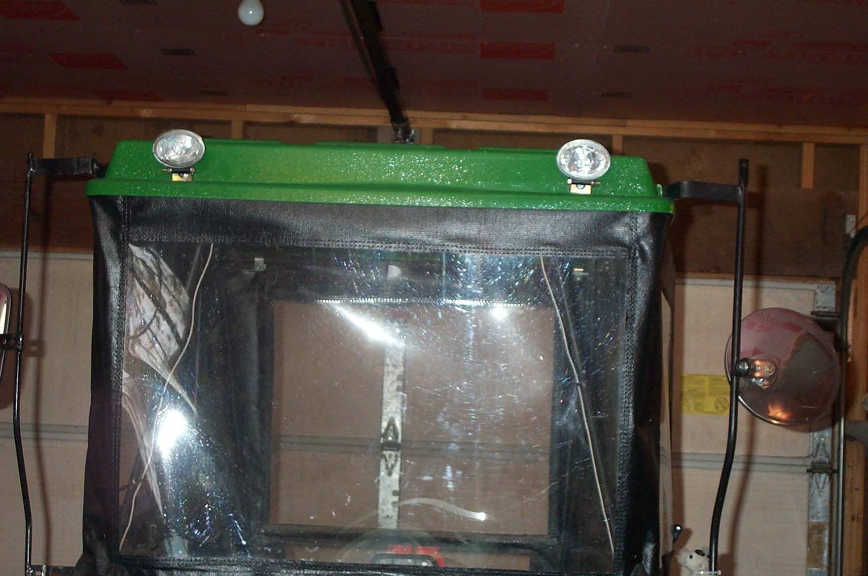

/ Work Lights for JD 2210 #3
I picked up a set of lights at Walmart for $20. Came with wiring kit (including an in-line fuse) and instructions. Hooked up directly to the battery. They work great. Very simple to install.

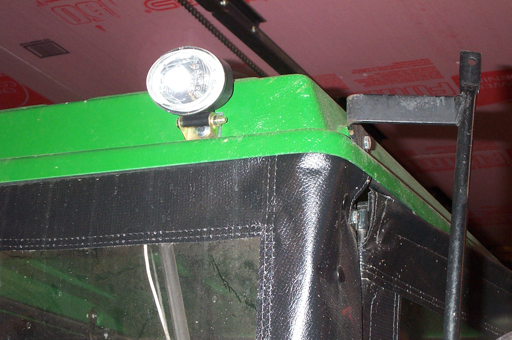

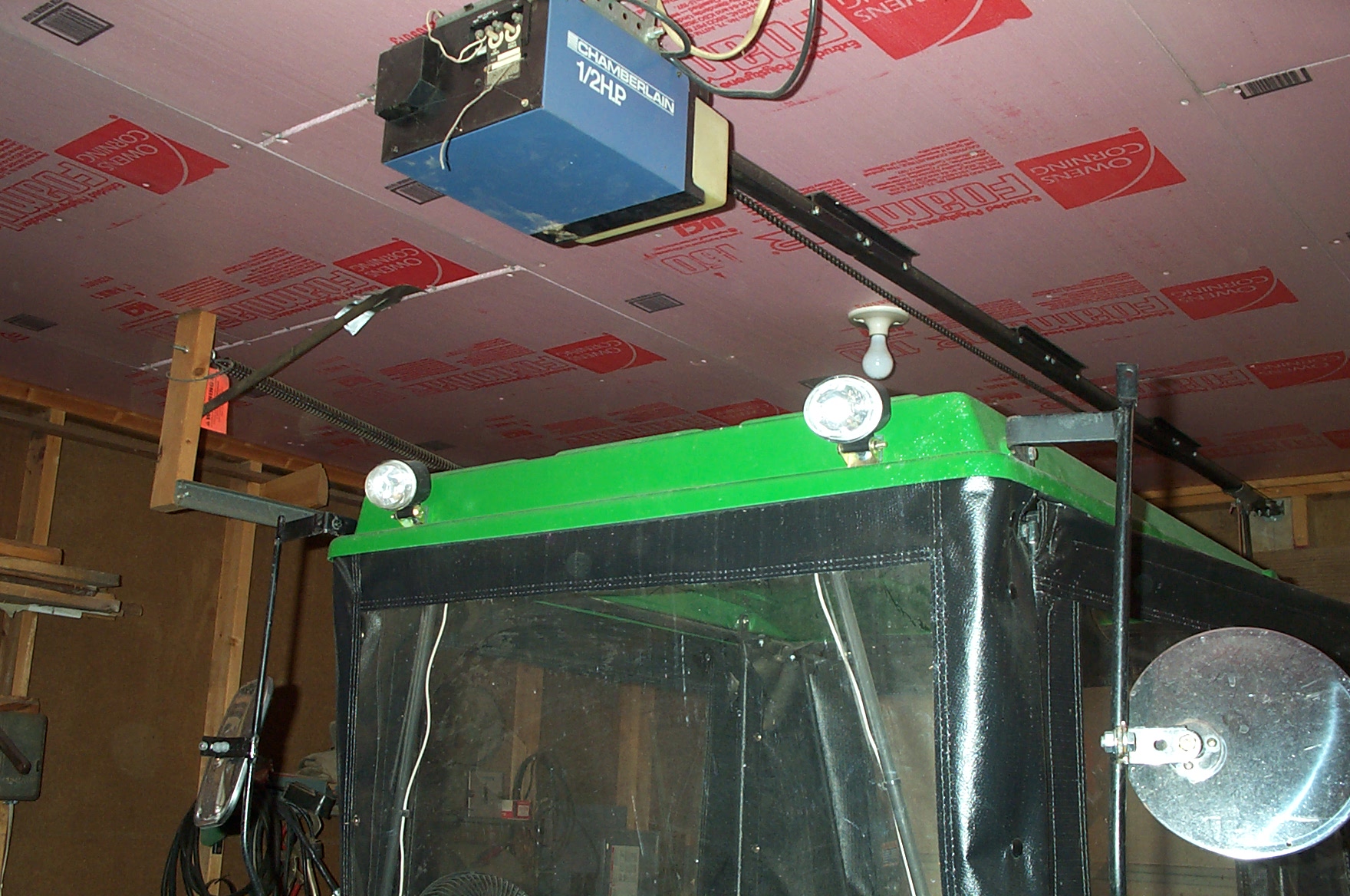

/ Work Lights for JD 2210 #5
Here are some pics of my $20 lights (the wiring kit includes a separate switch) Mine are mounted on the canopy of my cab, but could be on the ROPS or anywhere. P.S. They are halogen DCP_0953.JPGDCP_0954.JPGDCP_0955.JPG

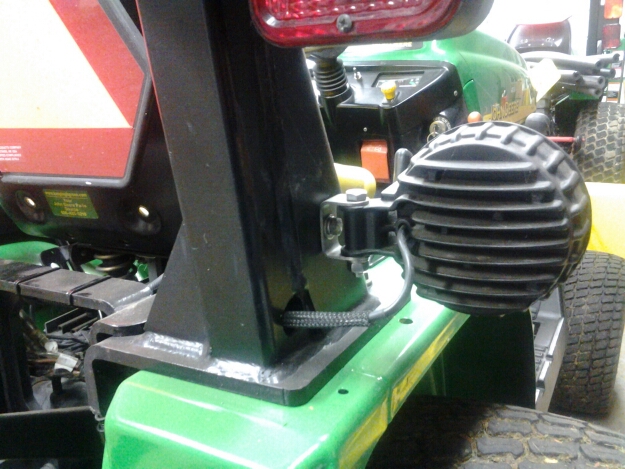

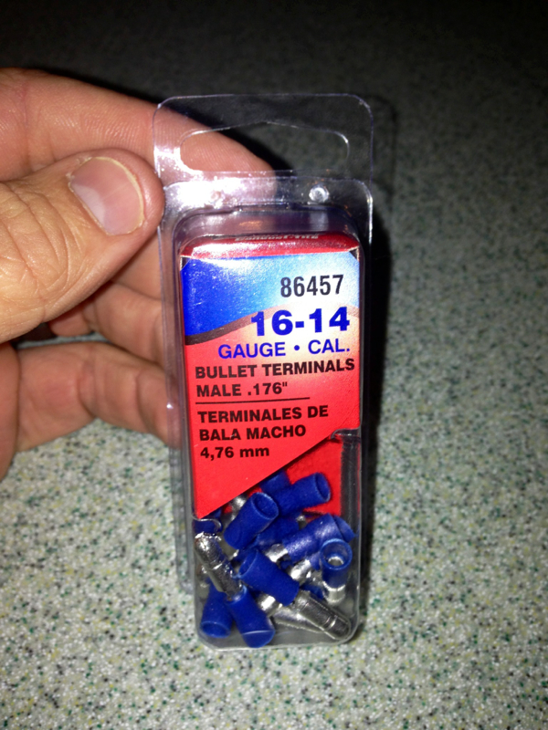

/ Work Lights for JD 2210 #8
I found these bullet terminals at auto zone for $3. They fit perfectly into the female bullet terminals for the work lights on my 4310.

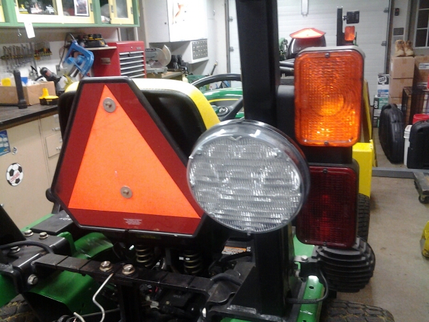

/ Work Lights for JD 2210 #10
LED is good - be careful if using 55W H-3 work lights, a couple of those will melt your light switch. I put a relay in and have 4 HID worklamps on the canopy / ROPS. I then unplugged the headlights from under the hood as all they do is cause glare from hitting the loader.
