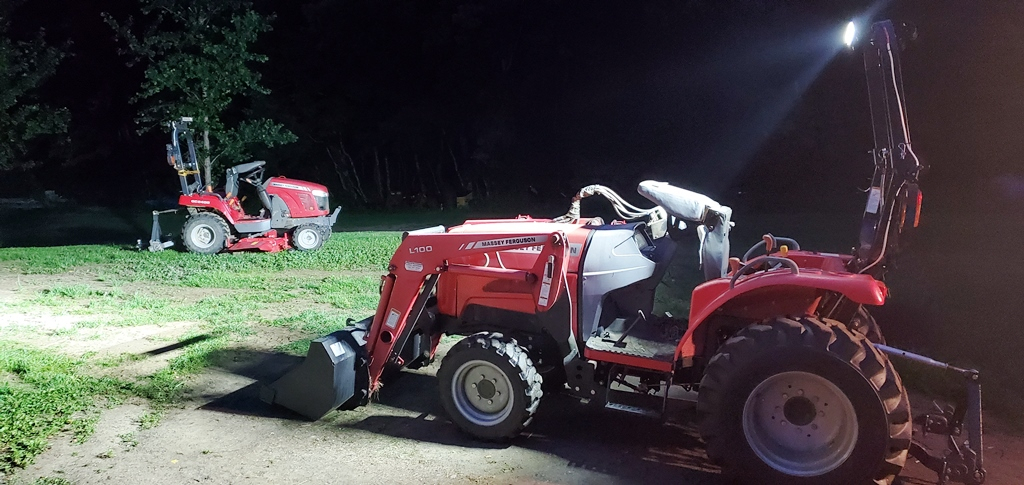

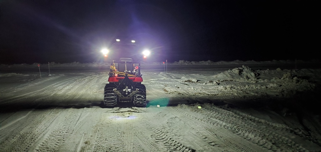

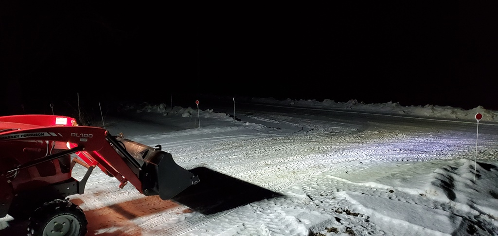

79$ amazon for my 19" led, 6 4" led.
19" and 4 of the 4" mounted. 2 4" face backwars 2 face down onto 3pt area.

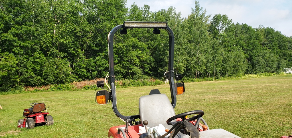

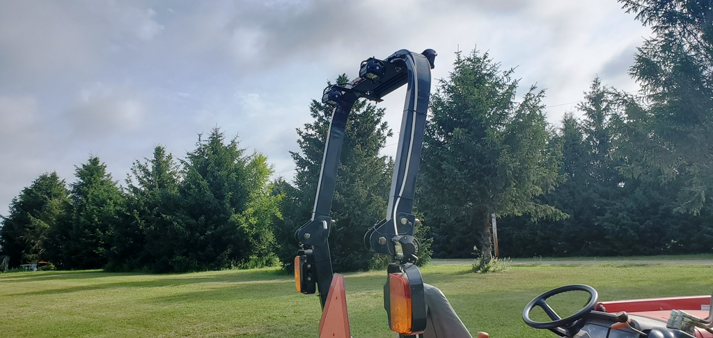

only had this one for one season, I do have block heater and battery maintainer. maintainer is really the most critical.
I wired (fused) direct off battery to 2 switches I mounted in left plastic wraparound piece so they would not get hit on accident but are easily reachable. one switch powers the 19" led facing fwd, other powers the 4 4inch lights which 2 face rear and 2 face onto my 3pt.
19 inch and the 2 facing 3pt are mounted to top of rops with a 4x4 spacer (I am not a tlb so my rops sits lower) to prevent head blocking light.
2 rear facing are hung right off the lower side of the blinker light guards. my gc2400 has guards welded to rops.
yeah I did have to drill rops, made informed decision on it but that method is not for everyone.

Thank You for your reply! I did notice the pictures from a earlier post , But I couldn't see how the where mounted because it was to dark ! But they where putting out some excellent light & thanks for the info on the install.

MF1532 will have pics later of rev/pto lights (was daytime when finished) but 80$ for lights before tax.
fused power run from battery to 2 switches in right rear fender then one switch runs main fwd light and other runs the rev/pto lights. slack built in to allow tilting ROPS backwards as needed. 14g marine wiring used, sadly nobody locally has black coated marine wire.
fwd light only on

the 2400 is mine the 1532 is neighbors which I use often.
