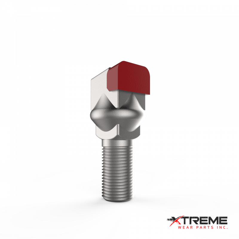

Anyone have any experience with these units? Recently purchased one from auction and so far it seems to perform as intended. Went after a couple hickory stumps to really test it. Did pretty well with that and is like butter through pine. Does seem to want to bounce a bit if you try taking too much off in a pass. Teeth are slightly worn but all still intact. Other than the $800.00 teeth from Woods, any place else to get quality cutter teeth? Found one site xtremewearparts.com, they are quite a bit cheaper than OEM. I've researched it some, almost think Woods has some proprietary cutter style as I haven't been able to locate anything else.

Do the teeth use a 2bolt pocket mount? If so then I'd look at Greenteeth.
/ Woods TSG50 stump grinder.
This is the tooth for a Woods unit.
/ Woods TSG50 stump grinder. #9
Ah, nevermind. Doesn't look like Greenteeth won't work.
