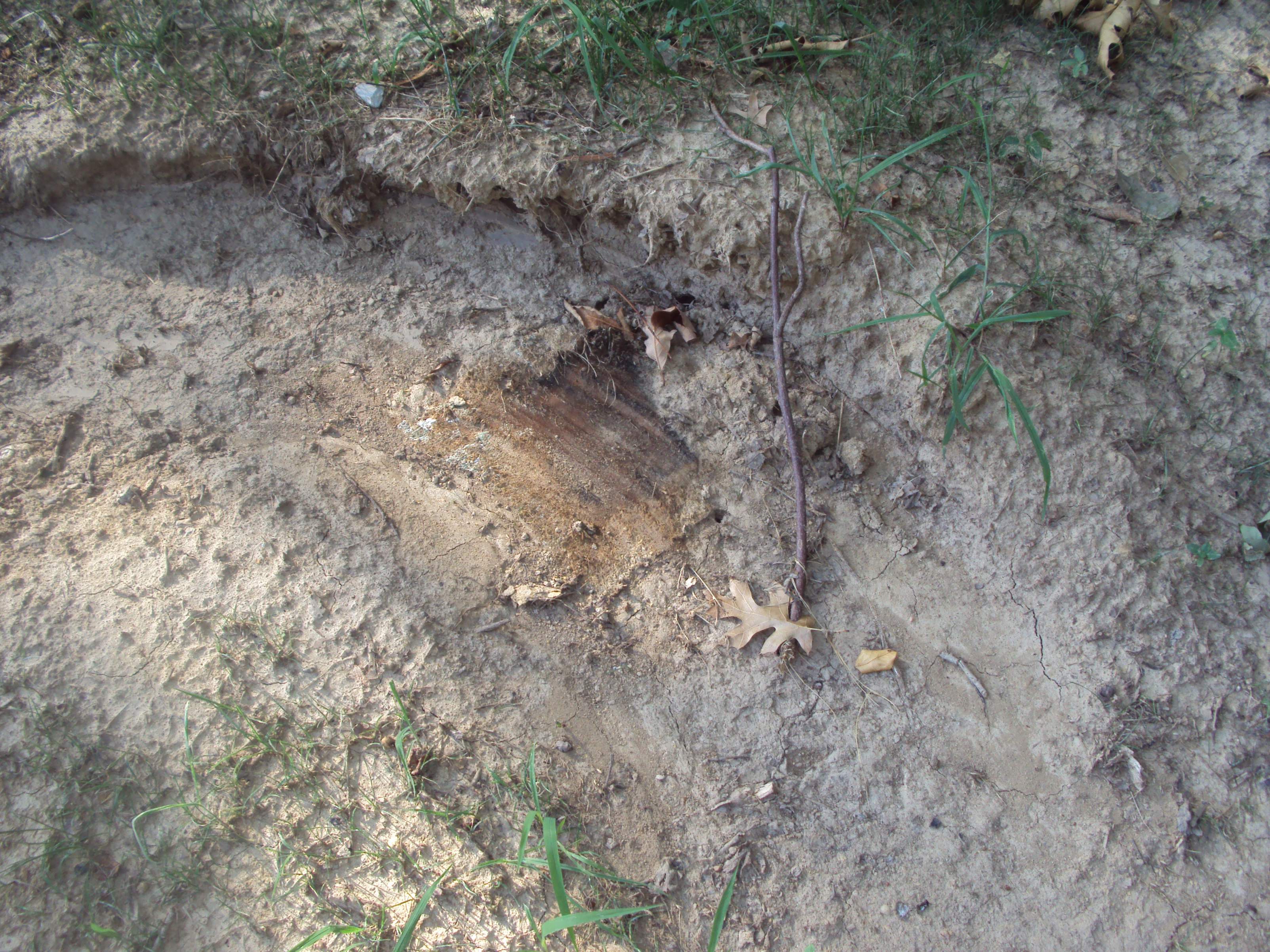

Here is an 8 inch stump, probably went down about 6 inches below level. If I adjust the top arm and angle it down, we could go deeper, alot depends on how level the ground is and how the tractor is sitting. It's not perfect but there is not much to clean up, just a stump and few grindings. I've done over 20 stumps at home. Works like a champ, home made, cost 1100.00. I am going to start a new post with better pics if interested.

What I am not seeing on that stump grinder is some carbide teeth. Just about anything that grinds in the dirt is using carbide teeth.
The teeth on there now seem they would wear down in the dirt rather quickly.
Could that be a Brown tree cutter.
