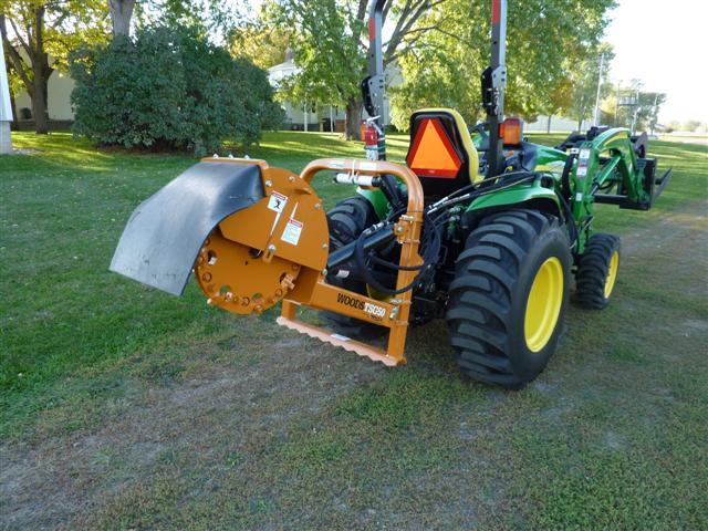

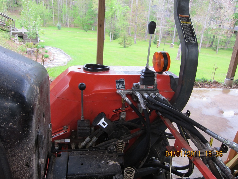

My little review on a Woods Stump Grinder. I picked it up from the Implement Dealer on Saturday. I bought it with the "hose kit" which is four hoses and fittings for the two cylinders on the machine....two of them being reduced orifice fittings. I finally got all the right hydraulic connections and hooked it up today.
I bought four "extension" hoses and the couplers to hook everything up to my loader's joystick valve. I then connected the loader's lift cylinders to the 3rd function SCV on my tractor via the existing hoses I have for my grapple. After adding grease to the gear box and greasing the fittings and hooking up the PTO....it was off to give it a whirl.
I have ground over 600 stumps on my land via rental grinders in time gone by....so I am not new to stump grinding. This Woods has lots of good features like a Sandvik Grinding Wheel and carbide teeth. A five year warranty on the gearbox and a slip clutch. In looking it over it is well built....as you expect from Woods.
My land is 200 miles from where I live and where I have the tractor currently....so I went over to a neighbor with a few stumps that need grinding. The first two were pretty rotten....and I basically destroyed those in major chunks in a few minutes....as expected.
The next two were fresh hardwood.....but only about 8" in diameter. I took a pretty good pass (maybe 3") and when I was going to re-position for the next pass I pushed the wrong way on the joystick and "buried" the teeth into the stump.....smoking the clutch for a second. At least I now know the clutch is working properly. :D
After switching the hoses around for up and down (which I shudda done earlier) I had no more events and made quick work outta those hardwood stumps. Power is a non-event...and this grinder will grind stumps very efficiently.
About the only issue I have is learning to use the hydraulics....which will just take a few more stumps. AND....the vision from the tractor seat is not the same as standing alongside the grinder. I think I have a plan which will enable me to position the grinder better....but it will take me a bit to get that down. Still.....its going to be hard to beat being closer to the action when setting up (as you are when using a self-contained stump grinder). (Adding a remote camera (like a back-up camera) keeps coming to my mind....who knows....lol)
From what I know to date.....this is going to work out pretty well for me. From EVERYTHING I have read or heard this grinder serves people well.....and the price is pretty good to boot. I paid $3500. + Tax....not too shabby IMO.
I think this grinder is perfect for the land-owner or farmer with numerous stumps to grind. I'm not sure if it's the right thing for a commercial grinding biz (?). I'll add information after I grind more stumps.

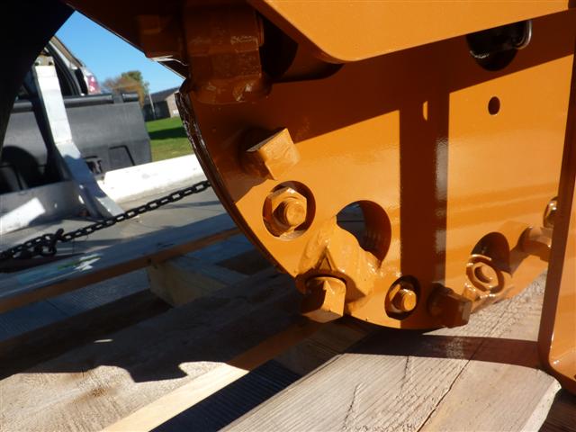

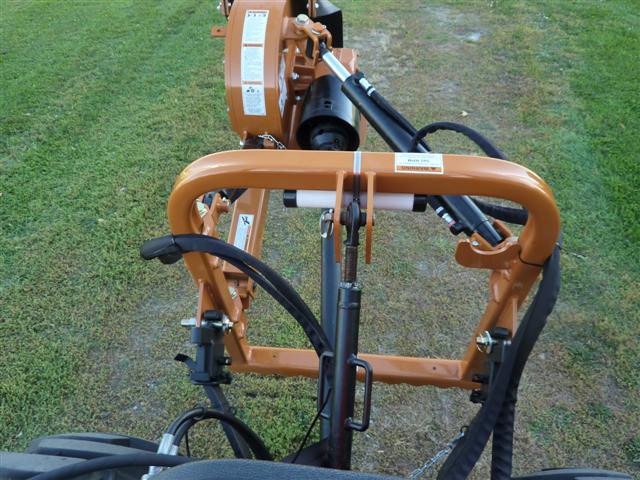

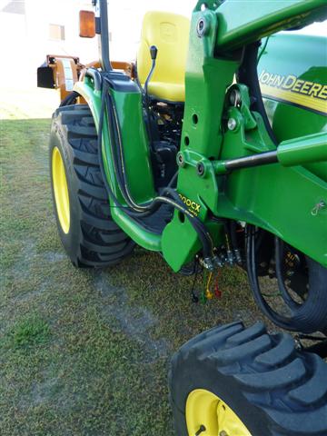

I'm going to add a few pics below....as several people had expressed interest in a 3 point stump grinder.
Seems to me there are a few mis-perceptions about these. I don't think there is any kind of power shortage for this grinder with my tractor (and Woods rates the grinder at 15 PTO hp to 50 PTO hp). Also, contrary to what has been said by a few, I don't think its hard on the tractor (no more-so than a tiller IMO) and nothing shakes violently or anything like that when set on the ground and operated properly.
The pics below show (1) the Sandvik wheel and teeth. (2) The way I routed the hoses along the right fender to the Joystick connectors. (3) The view from the tractor seat.

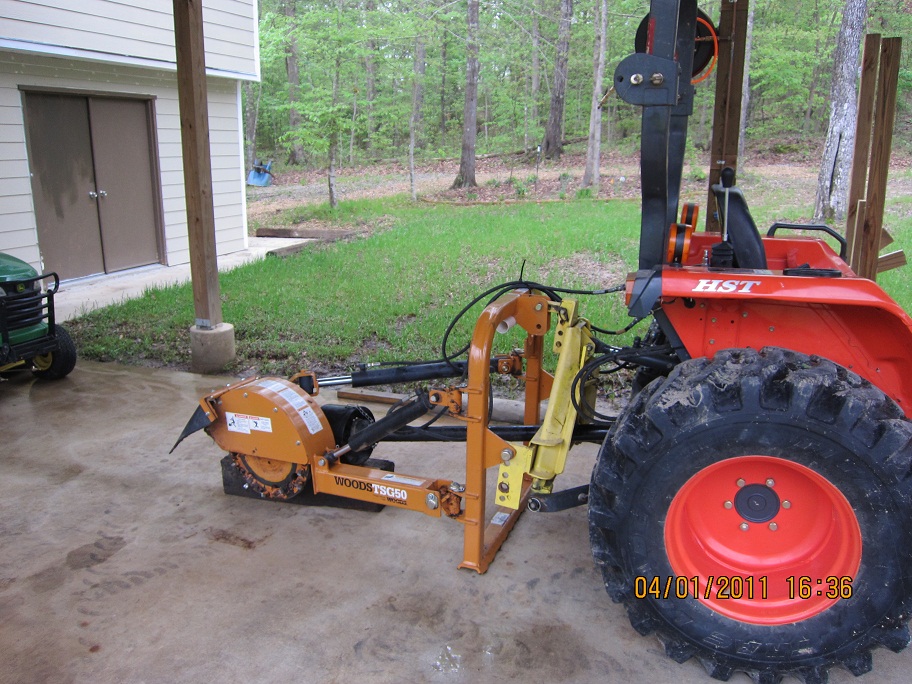

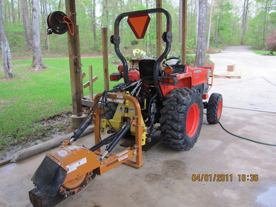

I recently came across a used Woods TSG50 for $1,850. The factory paint had not even been worn off the wheel or the teeth. So far this attachment is great, fast, and very efficient. Does not make much of a mess either. This was taken before I mounted the quick disconnect hoses in a bracket on the back.
In case you wonder what the yellow thing is on the 3 pt, it is a Delta Hook quick attachment device which is simply outstanding.

Minor update on mine;
It lost a tooth, although the property owner found it, or maybe I wouldn't have noticed (-:
I'm wondering just how often they need to be torqued down.
Anyway, to anyone thinking of taking on outside work with one of these...
Spec out what you consider to be a "stump" - e.g. how high ?
Waist high is a TRUNK dabnabbit, so is knee high.
Quote separately for chainsaw trimming - and DO take a chainsaw with you (-:.
Spec how far out you will go for roots that are above grade - some species are especially bad for this.
OK, so it may be 12 inches diameter 6 inches above grade, but how far do those surface roots fan out ? and how deep will you go for them ?
BTW, I haven't seen any tooth wear or chipping yet - and I have scratched up a stone wall (-:
The rubber flap holds stuff back, this isn't a rock hurler.
I have found quite a few of those, but the speed seems low enough to not chuck stuff very far.
