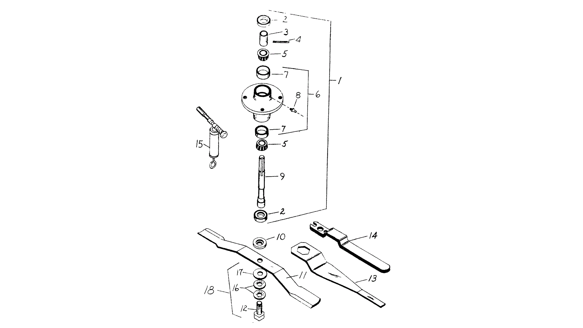

Trying to rebuild my Woods mower deck 59HC for my old Farmall Super C
I can not figure out how to pull the spindle apart as the diagram shows. Do I need a press to take it apart?

I would say yes you need a press. Does the pulley on top have a tapered bushing holding it on? If so remove it and everything presses out the bottom of the housing.

yea, the pulley is held on by a tapered Bushing as you described. I have that off and the spindles on the work bench. unfortunately I dont own a press :-( I was hoping I could just hit them a few times and they would come apart. but no dice.

Every Woods spindle I've ever messed with was tight, needed a press. Know anybody who has one you can take it to?

You may get lucky and be able to tap it back together with a hammer and wooden block but be prepared to press it back on so you don't mess anything up.

Just wanted to follow up on this for others in future. This is possible without a press. Drive #4 roll pin out and a bfh and it will come apart. I used a piece of pipe to drive bearings on and off. Honestly the worst part was driving the old races out. For some reason they didn't want to move.
Thanks again for everyones help.

I did buy after market. I found some on ebay. They worked great. It was like $45 a spindle.
