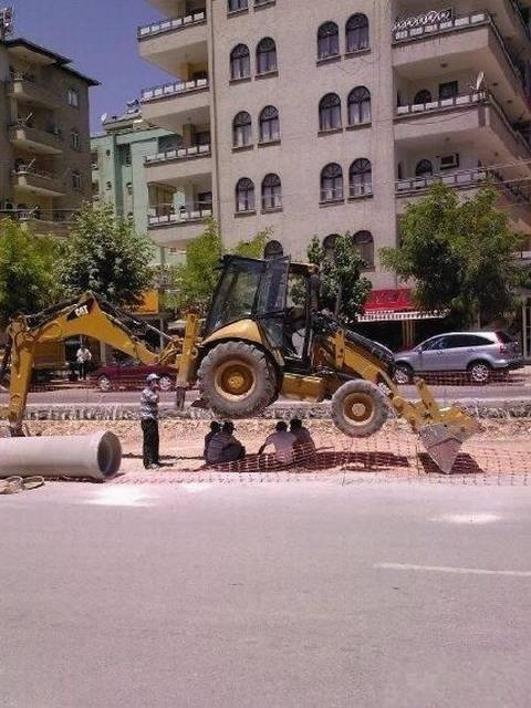

Our compact tractors are not industrial TLBs, like the JD110/210,
Kub L45, M59, etc. Those bad boys have very substantial additional
frames to support lifting the tractors fully off the ground, front and rear.
Generally for CUTs with subframes, you can take most of the weight off
the wheels, but don't lift the tractor off the ground.
You can stick the cutting edge of the loader bkt into the ground to
keep the tractor from being dragged by the hoe. I just set it flat unless
I am getting dragged.
Agreed. In fact my Woods manual clearly states NOT to jack the tractor off the ground using the stabilizers..... including the downhill side of uneven ground. They say to level the spot where the tractor sits so that even the tire on the low side is on the ground.
