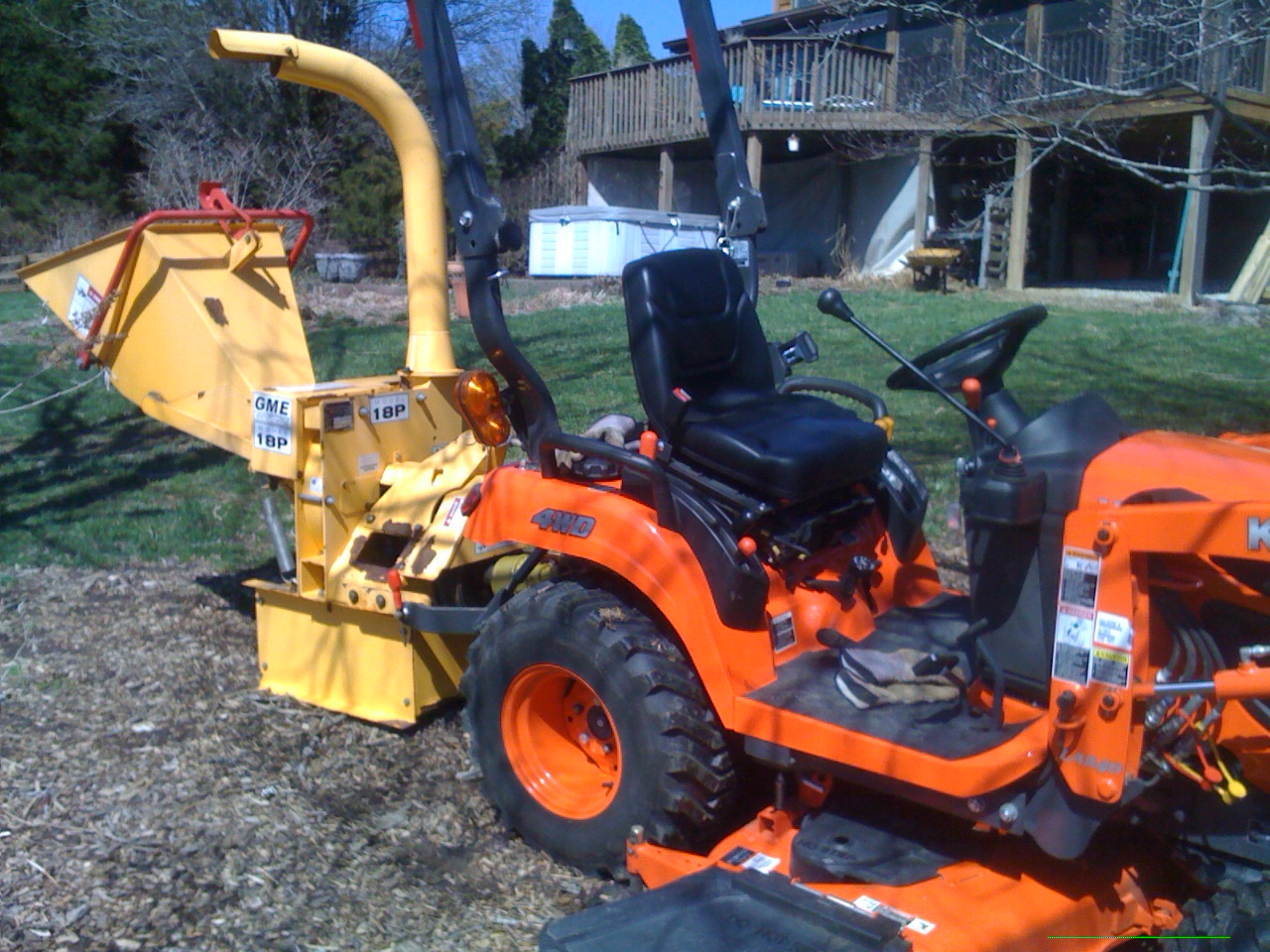

/ Woodmaxx vs Jinma chipper #85
What's a guestimate of how many hours you've put on it? I would say around 25 actual working hours
How may times have you sharpened the blades? None yet but they are reversible and I have a spare set.
How many PTO HP is your tractor? 30
What's your elevation?
Latitude: 44.69939 North
Longitude: 75.74799 West
Altitude: 122m/400ft
