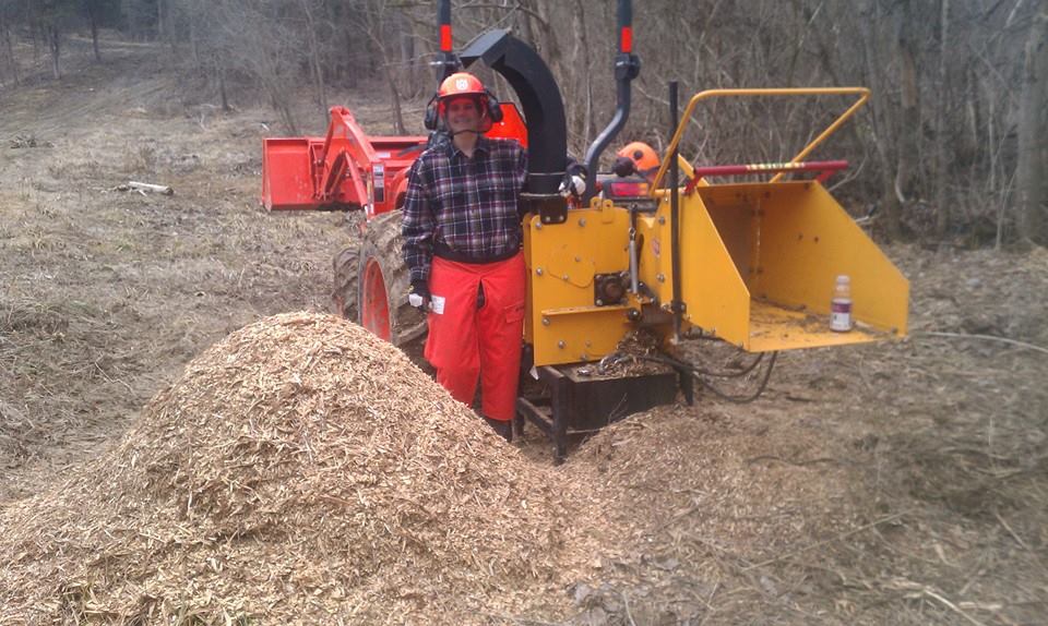

I've been running my WoodMaxx WM-8H for 9 months, and ran it all winter with the weather permitted. A few things to remember grease everything, often. Change the hydro filter often.
Most of what my wife (in the picture) and I run through the chipper is invasive honeysuckle and vine. With the stump end being 2.5-3" and the brush end being yards wide. Sometimes it a wrestling match to get the brush to go through but it usually feeds in perfectly. The chips you see there were the result of about an hours worth of steady feeding.
Tractor is a Kubota L3800 HST (roughly 30hp at PTO).
If you are feeding hardwood in the 4 to 6" range that have dried out you cant feed them at max speed or it will cause belts to slip so I usually just slow the feed down.

Great report! I don't use mine in the winter here in Illinois - same model. Looking forward to springtime! Why didn't you choose the orange model? Mine makes that many chips in about an hour. I'd say your wife needs to pick up the pace a bit!!!!

At the time we ordered ours they didn't have orange in stock and was a week out from paint (if i remember correctly).
The wife was always waiting on me and a friend to get the brush cut with chain saws. Yes the feeder works faster than two guys with saws.

yeah, very cool photo.
