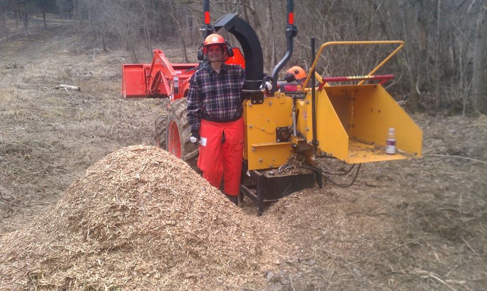

I got a couple of hours of chipping in this afternoon on my new WoodMaxx WM-8H & I'm very impressed! Stalled the tractor once but only because I had the infeed going too fast for it to handle the piece I was feeding it.
Here's a picture of the results!
/ Woodmaxx vs Jinma chipper #72
Very nice photo and machine.

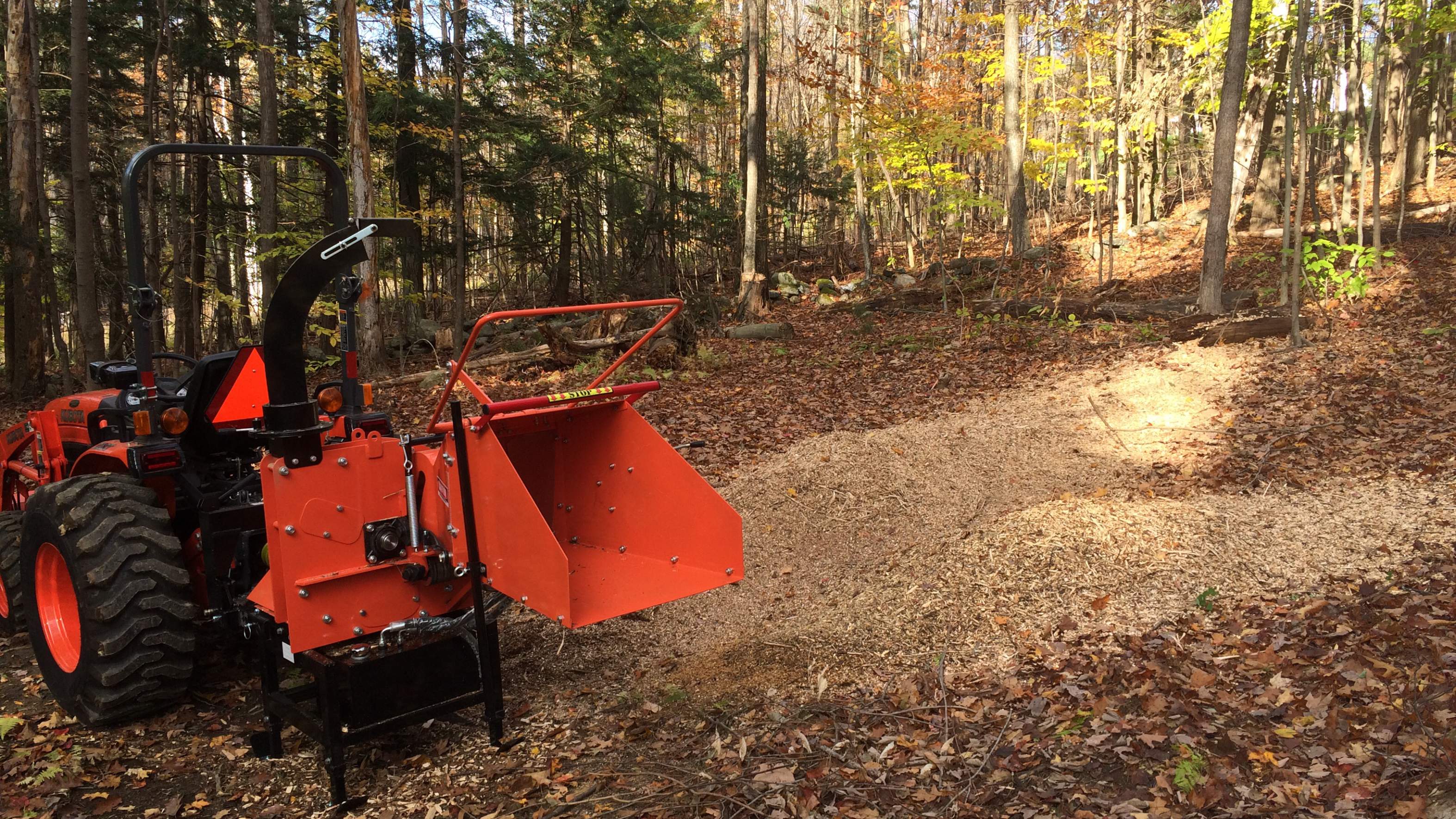

Another praise for woodmax
I bought my WM8H this last spring and love it
I've used it off and on all summer to clear brush and take down a couple of trees
I run it with a Mahindra 3016, with 23 PTO horses, at full feed speed for everything but the largest of branches.
The larger 8in throat make all the difference, you don't have to clean up the branches before feeding.
