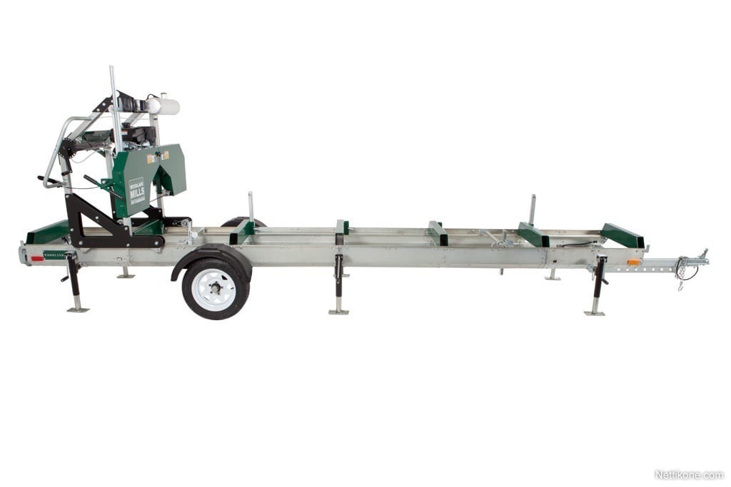

I just received a Woodland Mills HM126 Woodlander XL which is their HM126 sawmill on a 16.5 foot trailer plus about 4 feet of trailer tongue. We got it all assembled and running this weekend and everything went well and it works great. But, the saw head unit, which rides on rails, is locked in place with 4 pins during transportation. The manual very clearly and specifically states that the position on the trailer is 19 inches forward of the rear of the trailer. You have to drill the holes in the side plates of the trailer for the pins. Pictured below is what it looks like in the lock down position. The trailer itself is very heavy but so is the saw head unit and as you can see, it sits way back on the trailer and well beind the wheels. To me this looks like a recipe for fishtailing. I've got a customer support question in asking them to address this. I have not had it out on the highway yet.
To put it in a different position would only require drilling a new set of holes....although the side plates and bed rails were extremely hard and even with a heavy duty drill it is hard work. To my eye it seems like just forward of the wheels would make more sense.
Interested in thoughts in general but specifically if there is anyone who owns this unit I would be interested in your experience.

Seems like rule of thumb would be to weigh the entire thing to get a base number, then slide the carriage forward until you get your 10-15% tongue weight (or whatever the magic sweet-spot number is).
Anyhow, for legal purposes, best to follow the manufacturer's recommendations, in case you get sued or have warranty issues.

Posted below is how to weigh the tongue of the trailer using your bathroom scale. You'll be going to a commercial scale, or check the owner's manual, for weight of trailer with saw head. If you go to a scale, weigh your tow vehicle without the trailer attached and then attached. That also would give you the tongue weight.
Mossroad is right about the 10-15% of the trailer weight to be tongue weight. If your tow vehicle will carry the weight, 15% is better than 10%.
The 10-15% rule is so widely recognized, I'd go with that, rather than risking a mis-type, or clerical error in the assembly instructions.

That doesn't look right, yet it's how they picture the trailers on their website.
As usual what MR said makes sense. I would use it the way that they say too unless or until you find that it's causing problems.

The particular trailer shown above is their off road only trailer.
I just looked at one of their product videos and it shows the trailer like I have being towed down the road with the saw head unit in the position indicated in the manual so I guess they got it all figured out. As mentioned, the trailer itself is very heavy and with so much trailer length in front of the wheels I guess it balances out.
I noticed on their 10 foot trailer the saw head is locked in place closer to the middle of the trailer.
I think I will take it out on the road next weekend and test it out.

Even if you were to go with the manufacturers instructions, I would think it would be a good idea to check the tongue weight just to know. Maybe secure the saw with clamps or straps for your test run then if you still have issues, contact the manufacturer and discuss the situation. Anyway, enjoy your new rig.

The OP’s comments make perfect sense and would follow loading guidelines For tongue weight. Further inquiry with the manufacturer would be in order.
As shown there may be a lot of vertical tail movement on rough roads.
