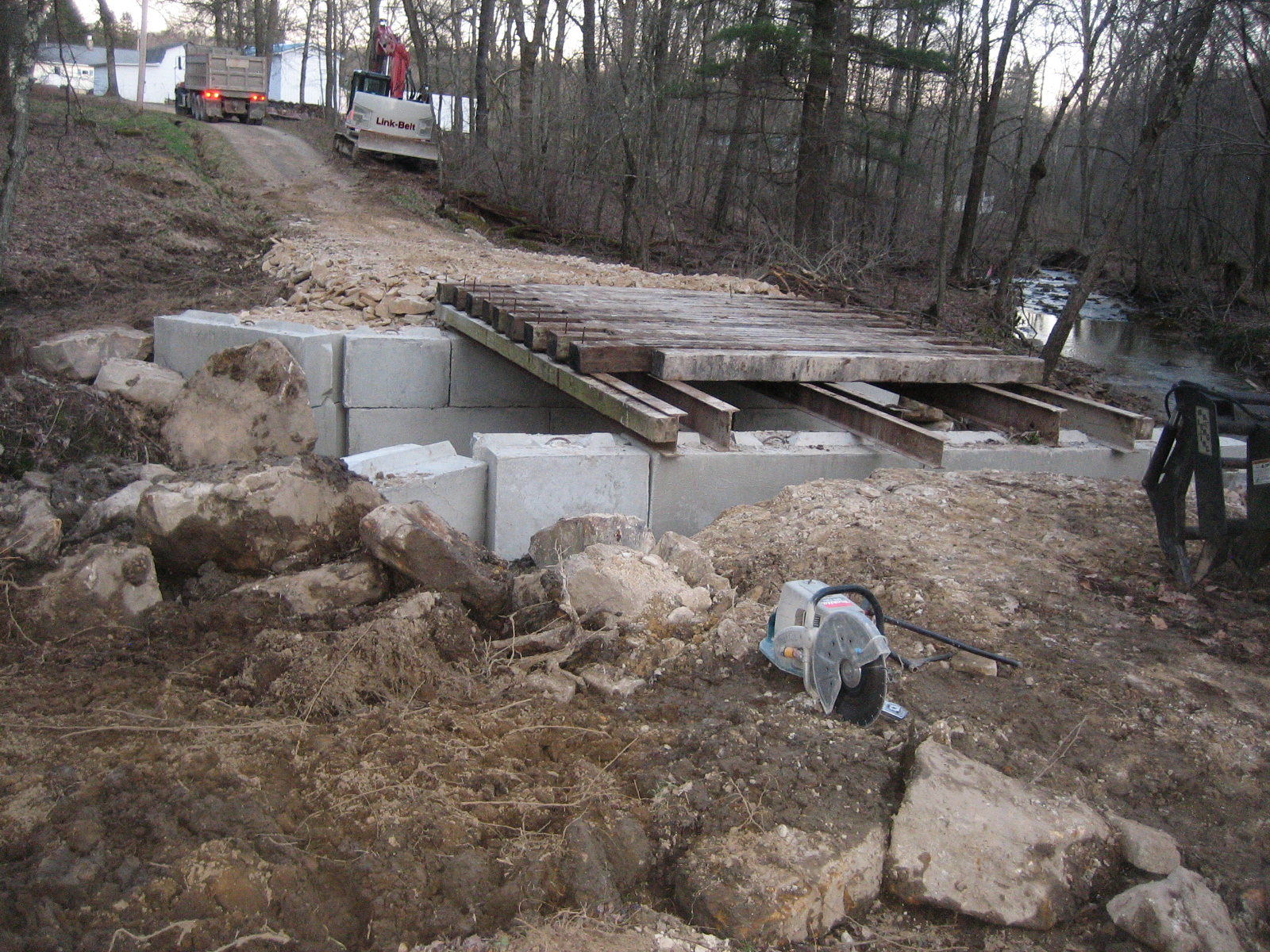

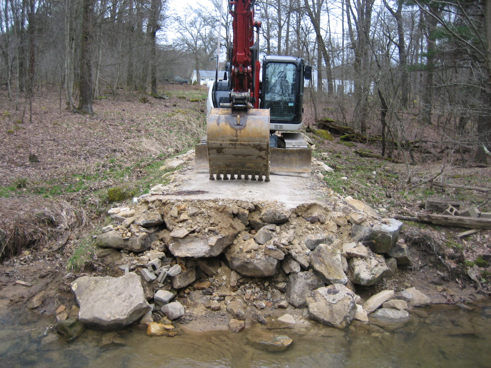

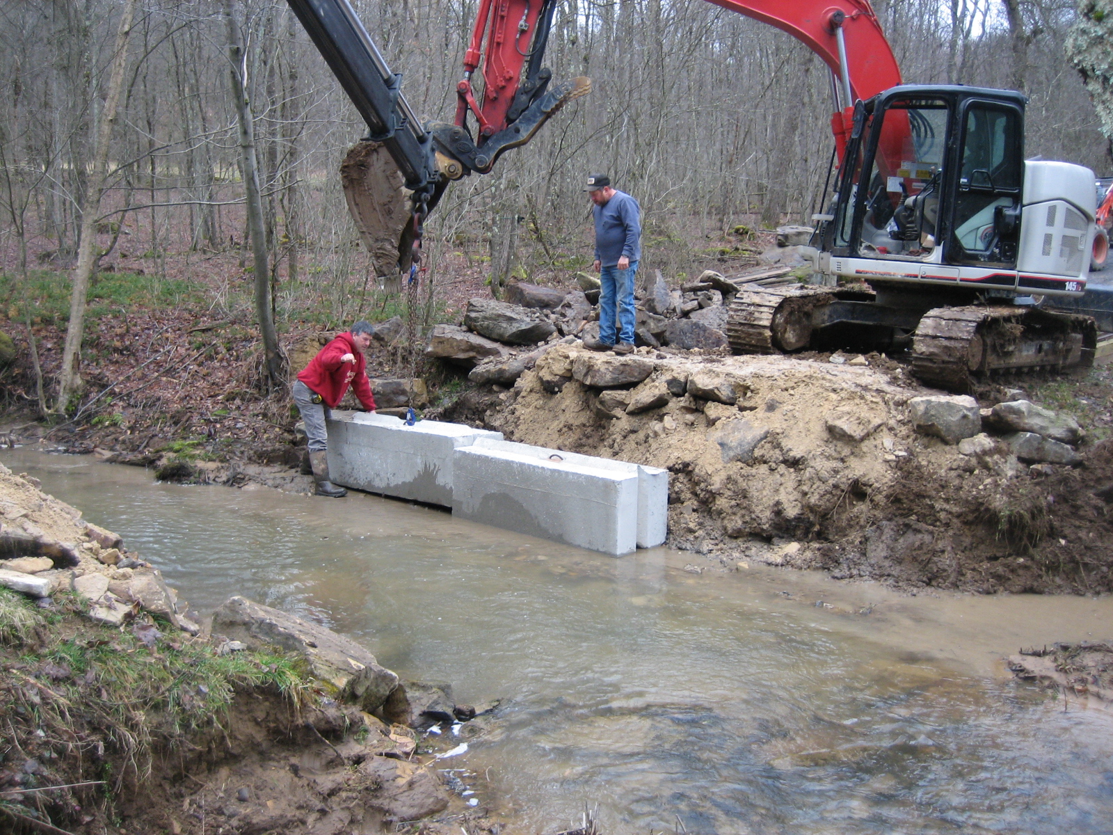

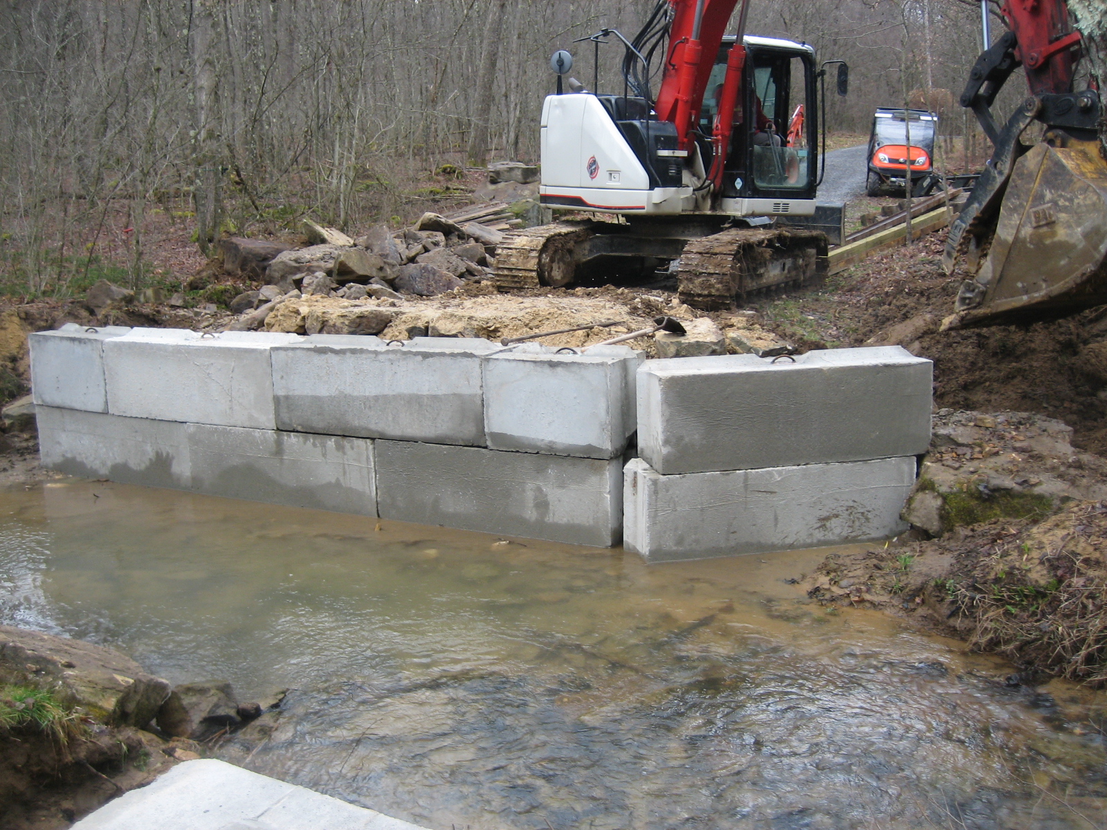

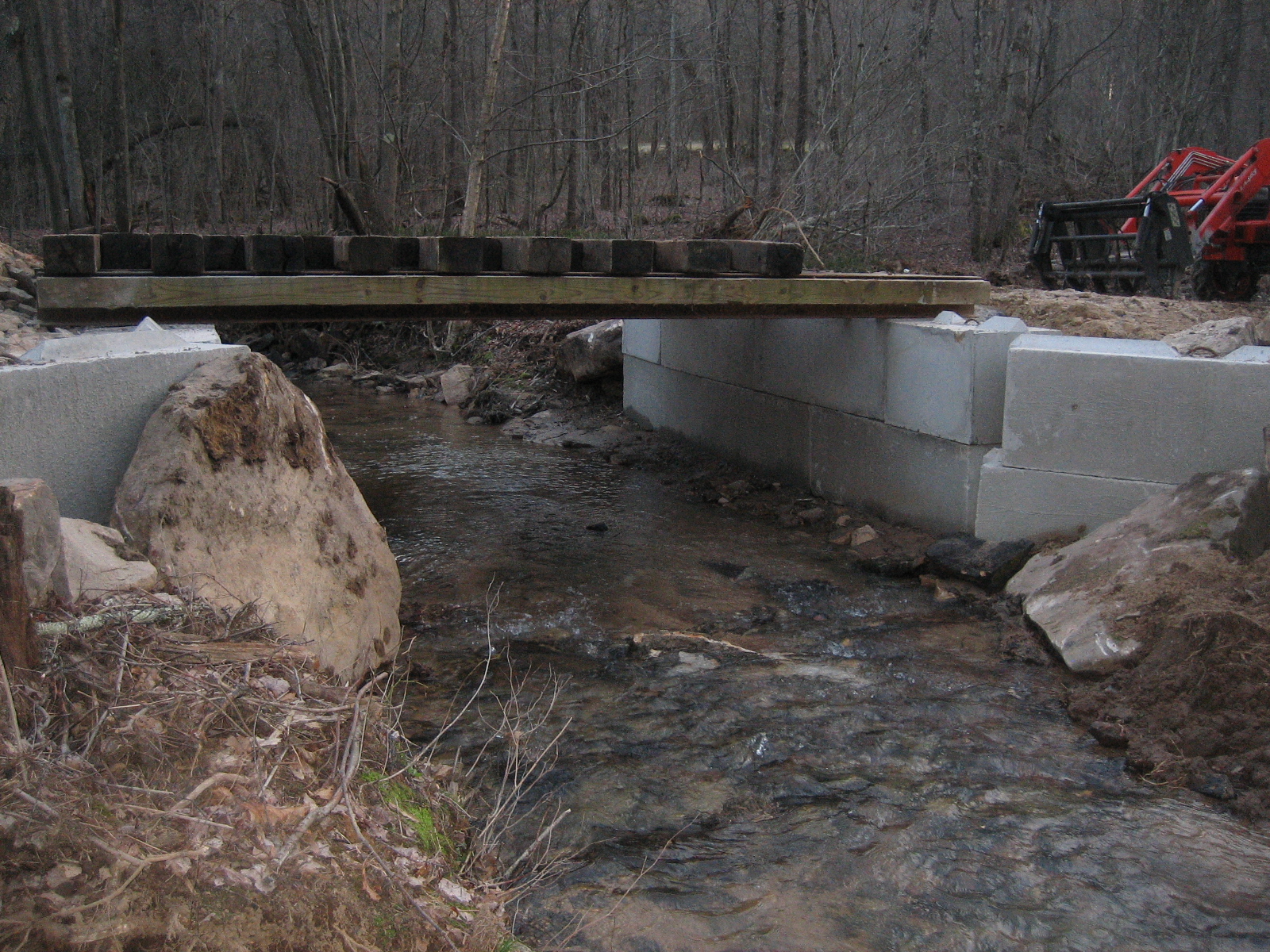

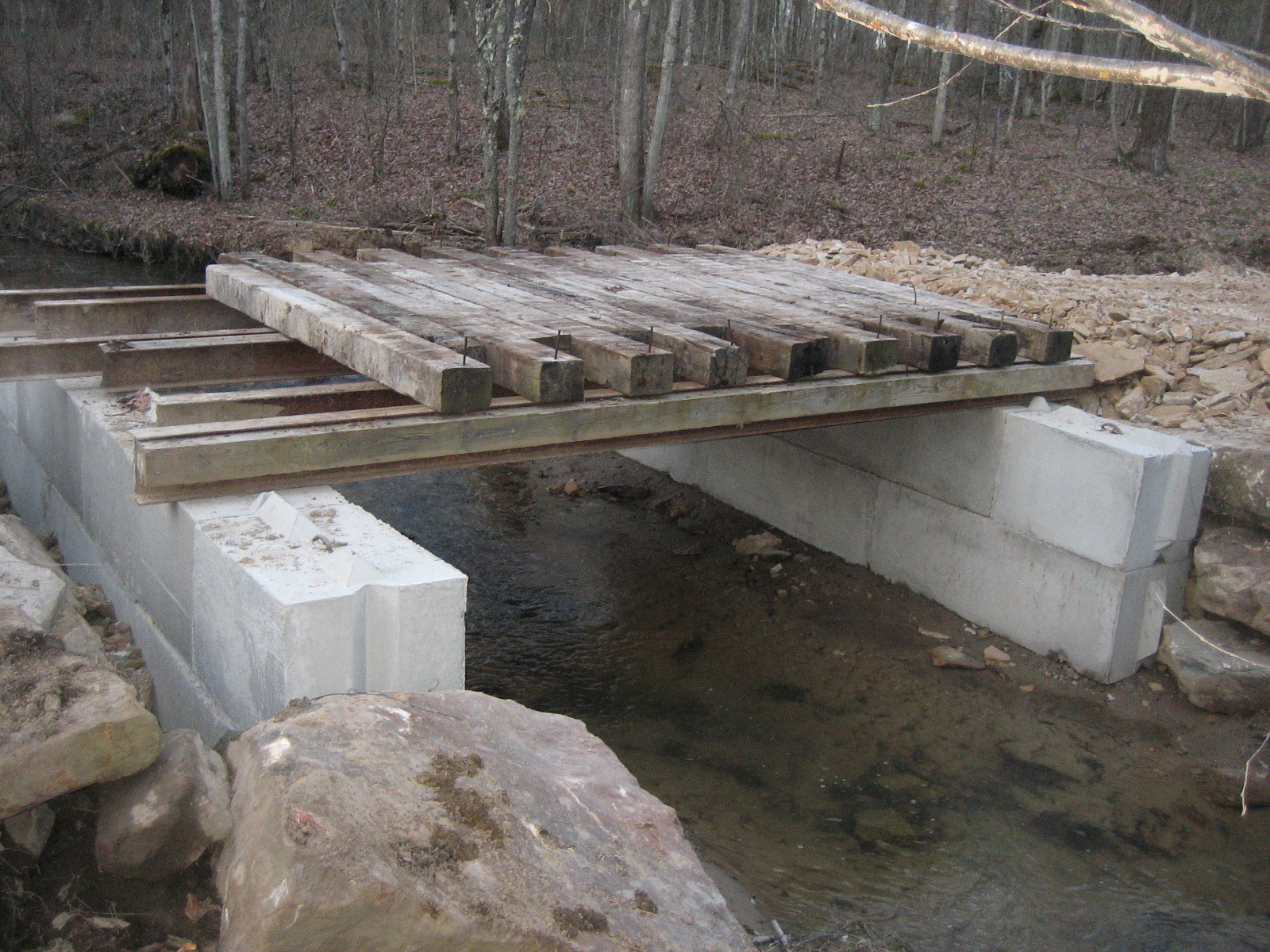

Well after several years of bridge washouts, finally bit the
big one and called in the pro's for the abutments, the rest I
finished myself.
A fellow TBN'r was gracious enough to give me an
APPROXIMATE capacity for my bridge after seeing my
beams etc. No I won't the numbers.
Any how, age 72 and less concern for washouts now.
If this one goes, going to buy a Duck Boat!!!!!!
Built railing from well pipe.

It does look sturdy, but I would be very concerned about washout/erosion over time, under those big blocks, unless there is actually a deep concrete footing under the blocks, or another row of buried blocks, beneath those that are visible.
/ Wooden Bridge Question #26
Nice job, keep an eye on it for scouring. When you neck water down during flood stage the force of the water can cause scouring under your concrete abutments. Also the water flowing lower during flood stage moves faster than the surface water due to it being under pressure from the top water. It looks to be flowing smooth and nice, but the real work is going on under the surface. The deep the water, the more force it has to remove material. You are channeling the water into a narrower configuration, making it a more powerful force down below.
Chapter 2 - Abutment Forms and Scour | Countermeasures to Protect Bridge Abutments from Scour | The National Academies Press
https://mtri.org/mdot_scour_workshop/13_Swartz_ScourCountermeasures_2017.pdf
/ Wooden Bridge Question #27
^ I too would be nervous about scouring under those big concrete blocks. From the pics it looks like the span of the bridge should be about 8-10' wider....
If you choke off the creek into a narrow bridge crossing, the next flood is going to be exerting tremendous pressure on those blocks and pulling material out from beneath and around them. Hope I am wrong and it holds up forever, but I'd be mentally prepared to do that whole job again someday.

There is not much to be said about the I beams, without knowing the web and the flange dimensions, and wt. per ft., other than that they do look like I beams!
Not all I beams are created equally!

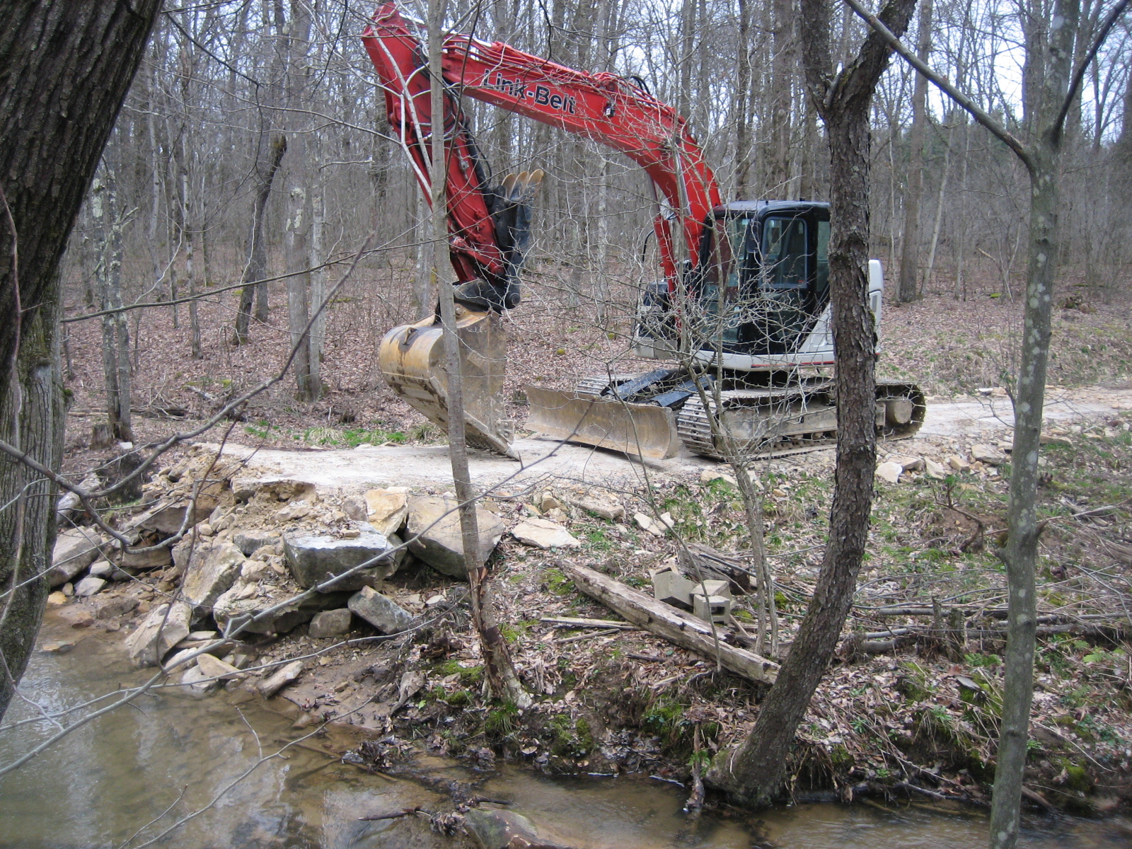

The creek bed is almost solid rock, back fill was with large boulders
and stone. We widened the creek 4' under the bridge and it is 2' higher
than the previous span. Also there are headwalls on both sides on the up stream
side. We discussed possible erosion, but this flooding is not a constant problem.
Had several Tri-axles loaded with gravel for the other side,
bridge never flexed!!!!!!
Awesome, thank you for the additional context and pics. I like the big boulders in front of the wing walls.
Dang, looks like your piece of land might just be a giant boulder pile with a light glaze of topsoil, LOL.
