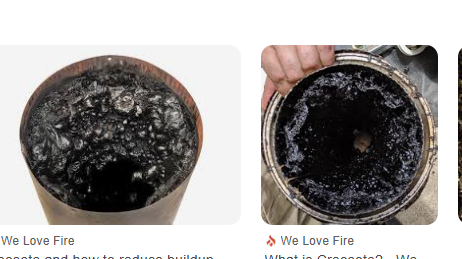

I cleaned my flue this last fall and got almost nothing out of it, just light dust. The last time I did it, maybe 5 years earlier I got enough to maybe fill a 5 gallon bucket and inch deep. It was a very dry material like coarse sand. I’m not sure what creosote even looks like??

No I really don’t know what creosote looks like. I’m using a fireplace with an outside air intake. I’m not sure how long my flue is. Maybe 15 feet or a little less.

its a black tar that can become liquid when hot

I’ve got a friend with a wood stove in his basement and I’ve seen the liquid stuff on the outside of his chimney on the roof.

As a beekeeper with a smoker I got to see what creostote looked like. Fuel was smoldering pellets like what's used in pellet stoves. Nice and dry, yet with black goo oozing out the lid and down the sides. And if I got a nice bunch of coals inside and pumped it good and hard, it would light off just like a chimney fire, crackling and sizzling down the sides. That was one way to clean it. Just like my neighbor - run his stove low and smoldering all fall, then on the first real cold morning fire it up extra hot and it goes off like a roman candle.

Agree that a smoker is a great way to visualize creosote. I use a propane torch to 'cook' it off, but it's crazy how quickly it builds up when you're purposefully burning low and slow.
