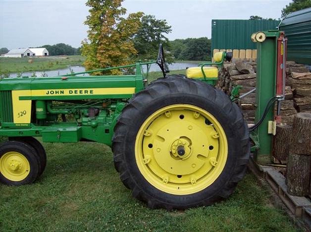

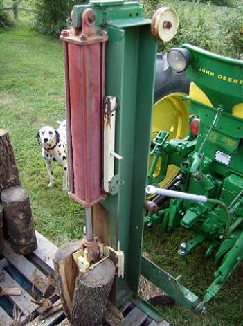

I have a vertical hyd splitter I made to use on my JD 1958 - 520 using tractor hydraulics. I've sold the 520,so I need to re-make the splitter to use on my 790. Plan is to set it up to "free-stand" the splitter(maybe w/bracing) beside the tractor & hook the hyd. hoses to the "bucket" connections on the tractor.
I've used this set-up on the 520 for several years & though it's not fast, it works well for me. I work by myself, so speed is not a problem! This is not something I will use frequently, but comes in handy sometimes. I prefer to split by hand if it's not too hot.
Any suggestions? ~~ grnspot110

I've always used the control on the 520 by disconnecting the linkage from the hydraulic lever & flipping it over to a lever on the back of the tractor (in the closeup pic, the faded gray conduit w/white cap at center right). Thought I'd just set the 790 up so I can use the joystick & the bucket cylinder quick-connects. Might need to make an extension for the joystick. ~~ grnspot110
