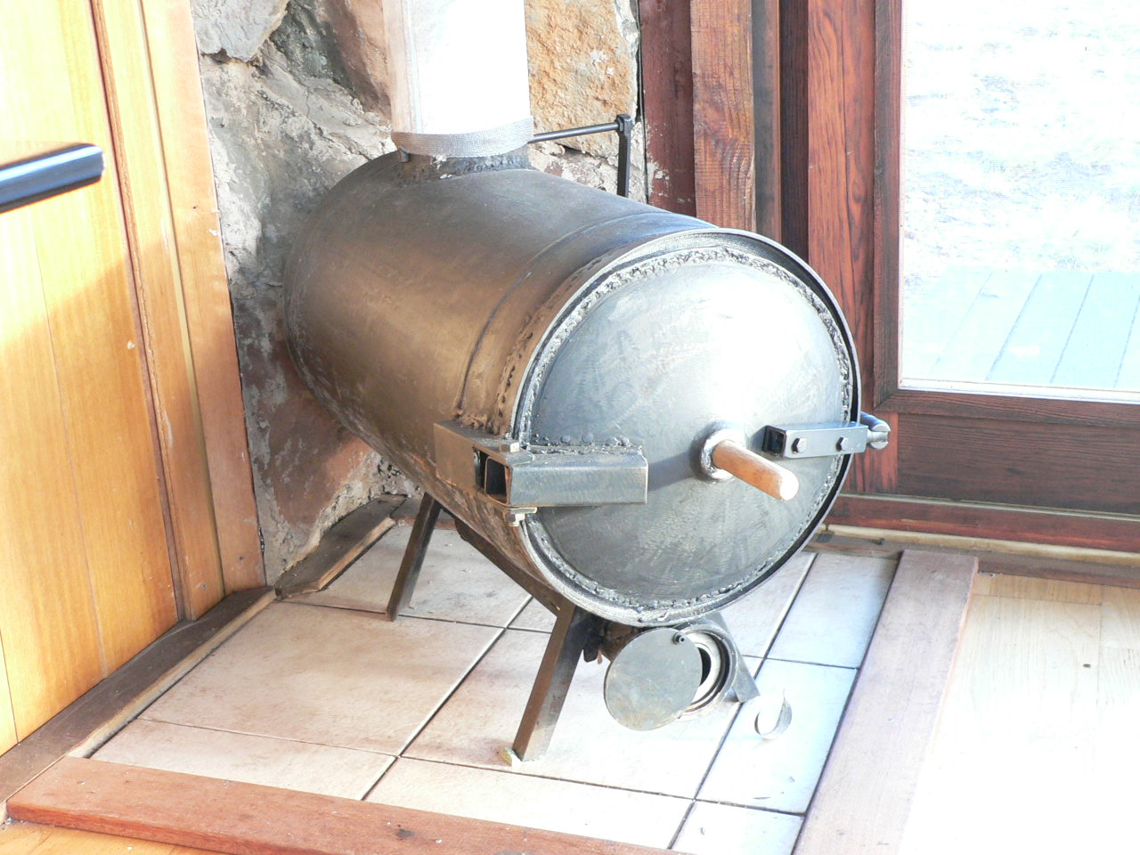

I made mine from an old industrial gas cylinder, cut off the end and used it as a door hinged on a frame welded around the cut end. Added a flue, feet, flue and an air tube. Total cost about $50 - works fine. A heavy steel screen has been placed behind the back and side to prevent heat damage to the walls - done after this picture was taken
Alan
Great job. Looks fantastic.
Alan
I like that!..has it's rear seated in stone. VERY innovative and aesthetically pleasing as well. Too bad the mass to the rear could not be the chimney, a bit more heat sink ya know! :thumbsup:

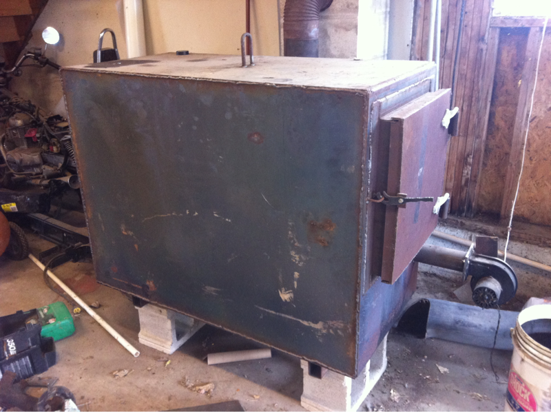

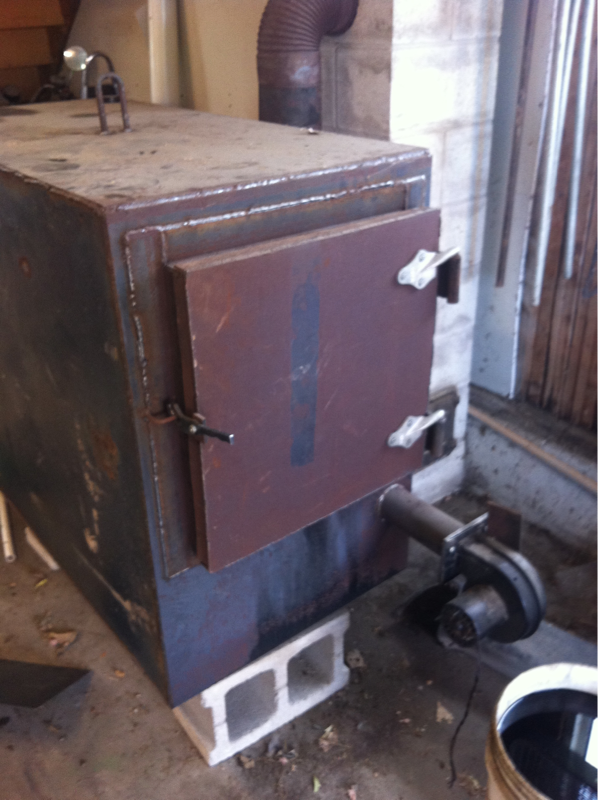

Here's the wood stove I built. 2 feet wide 3 feet tall 4 feet deep. Fan forced on thermostat. Fill it once and it will heat for 20 hours.

wood stove- I made mine from a 1000 gal lp tank cut in half put a 1/5 inch front on it with a large door built a jacket around it and a big fan rear top cut a 6-6 hole for draft and a draft fan in it when gets real cold out I drip a little oil its almost 40 years old .
