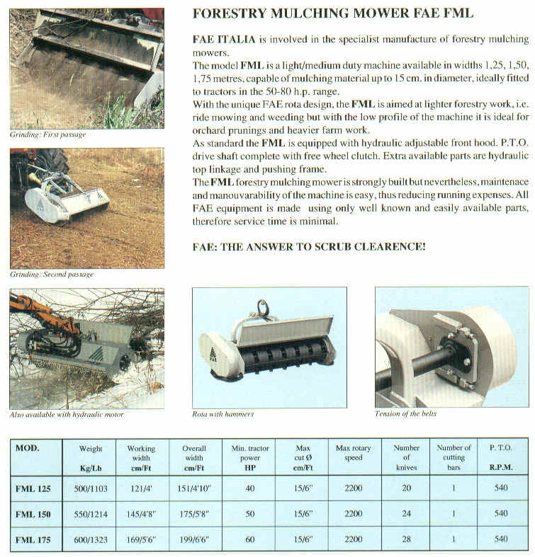

The same people who import Valby Chippers bring in a line of tree/brush cutters. They come in many sizes and I think the smaller ones will fit your tractor. FML Forestry Mower /forums/images/graemlins/cool.gif
I've wanted one for a quite a while.

Anybody get a ballpark price on one of these "forestry mowers"
I am looking at some 90 to 125HP older tractors. Seems like one can be had for 12 to 15k. I've got 70 acres of woods. Would rather drive around mowing over brush piles and blowdowns then picking them up and chipping them.
Thoughts?
JP
