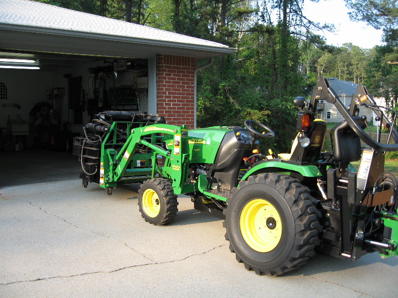

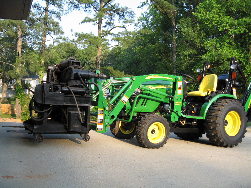

Oh yes it will , This muffler pipe bender weighs 1860 pounds. I know for a fact. cause i weighed it ten years ago. at the steel scrap place next to my shop. and the pallet forks weighes 317 pounds according to JD. I can lift it to til the casters on the machine are a little over the headlights. before i start to feel the check valve kicking in . any way you cut it. thats 2177 pounds. At 6 to 12 inches. i can move it anywhere i want with no problem.
I concider it a legitimate lift. cause i moved if from my bacement. around the house and up to the garage. with no problem. and thats all that matters.This is the Extream. but i needed to move it. I was going to take a picture with it up even with the headlights. witch is about 3 feet. but when i attempted to get off the tractor. the back tires started to come off the ground. even with the backhoe on. my 250 body was just enough to keep it down. so i had to take the picture at about 8 inches up. but going slow at 6 to 10 inches . it was no problem. I am completely amazed at what this machine will do.:D JD really needs to get there specs in check.:rolleyes: i dont know where thay came up with that 996 mess. thats a joke. yesterday i loaded a fully dressed out bigblock 454 on to the pallet forks and loaded it into a trailer. at almost max height. the motor weighes 900 pounds and the pallet forks weighes 317.
that alone is 1217 to max height , and it was no problem i drove around with it. and it was not lite in the back at all. I think the specs are for a 2320. and thay just used the same for a 2520. and its wrong. someone ask in another thread if a 2320 would lift 1200 pound round bails. i dont think it would as i have used one. but i know a 2520 would have no problem at all. even with 1500 pounds. So unless i have a freak of nature. you can lift the back tires off the ground with the backhoe before the check valve hits.
Here is the pipe bender on the pallet forks as i was putting it in the garage.
I dont think i need to lift anything this heavy very often. But its nice to know if i need to. I can.....:) in the future folks concidering a 2520. this should answer alot of questions for you.....;)
