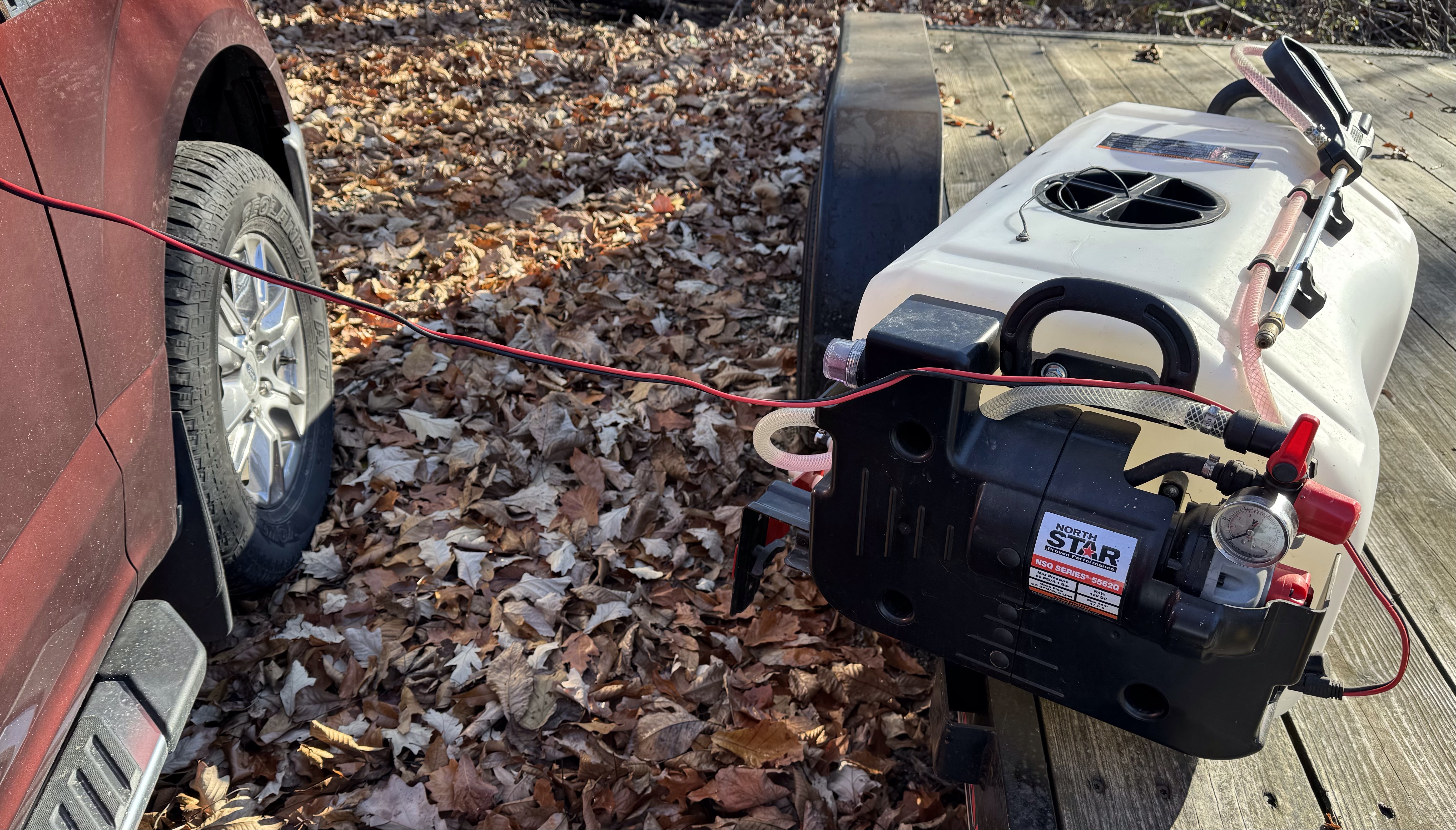

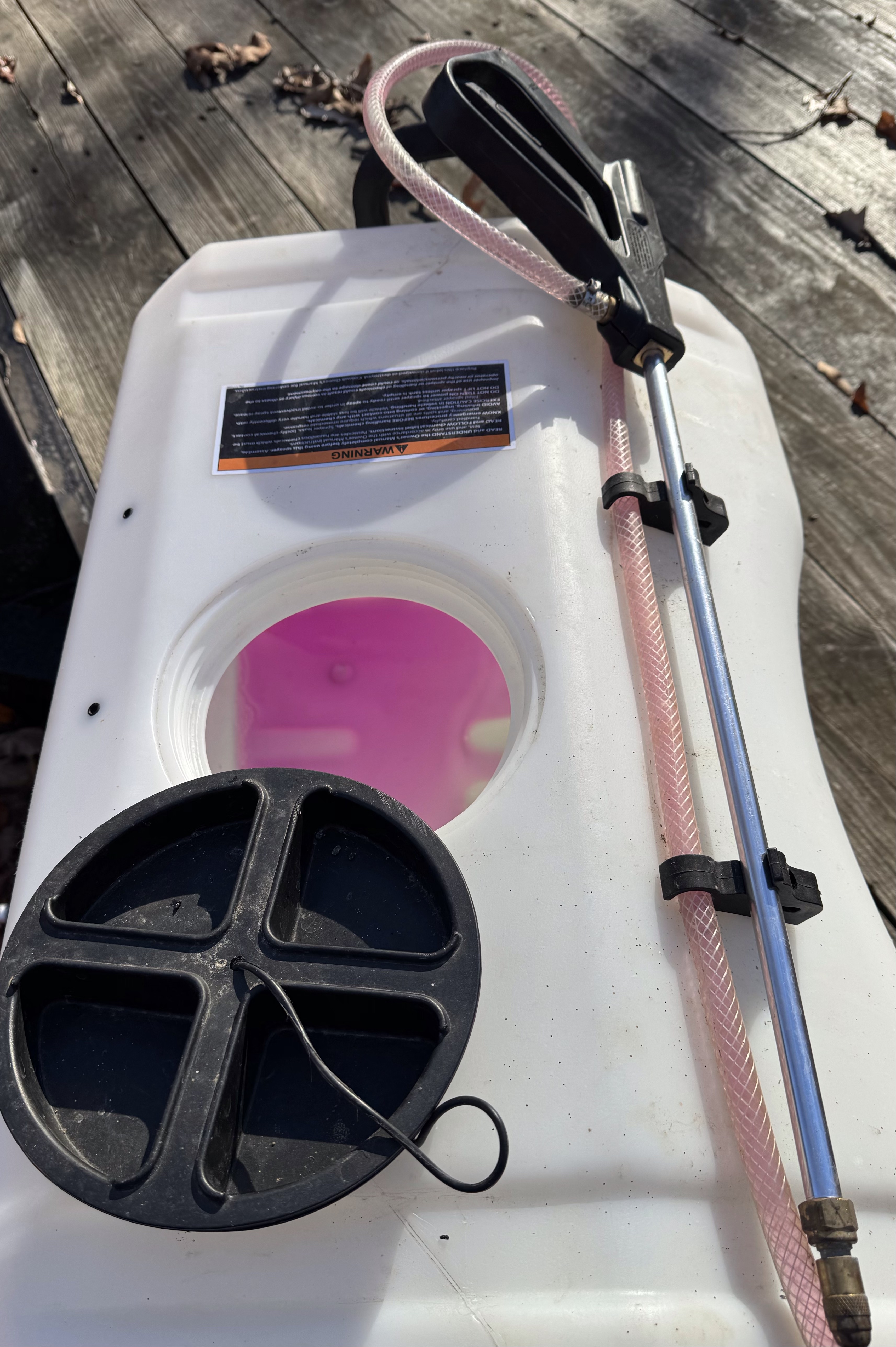

I about forget to do this every year. I have a 26 gallon sprayer and if it freezes up it can crack the pump. I pumped some rv antifreeze in it today.
