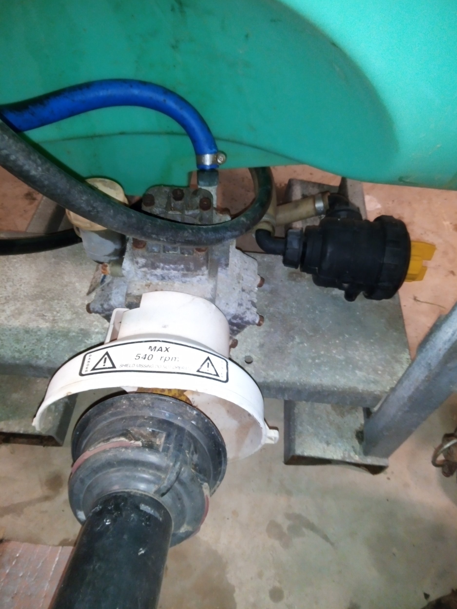

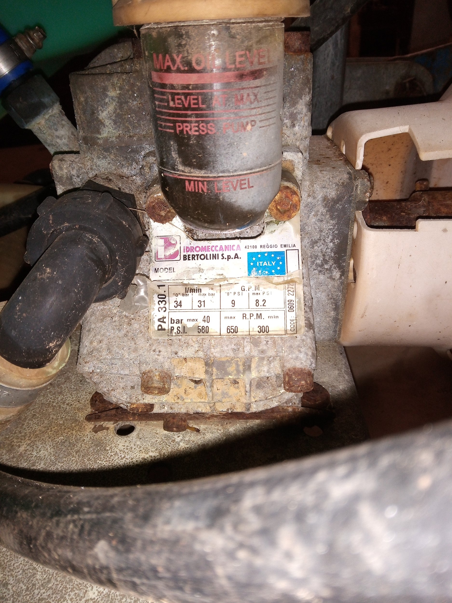

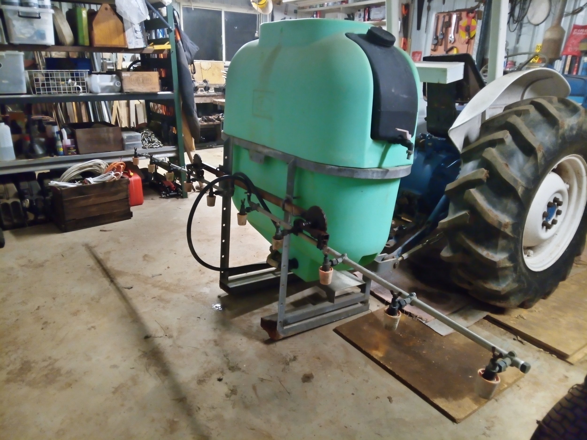

Hi,
Sorry for the initial lack of pictures, I've added some here.
The sprayer is a boom type. I measured the output of each nozzle by running the sprayer at running speed, 540rpm pto, and holding a bucket under each nozzle. There was 1.5-2L (0.4-0.6USgal from each nozzle in 30 seconds.

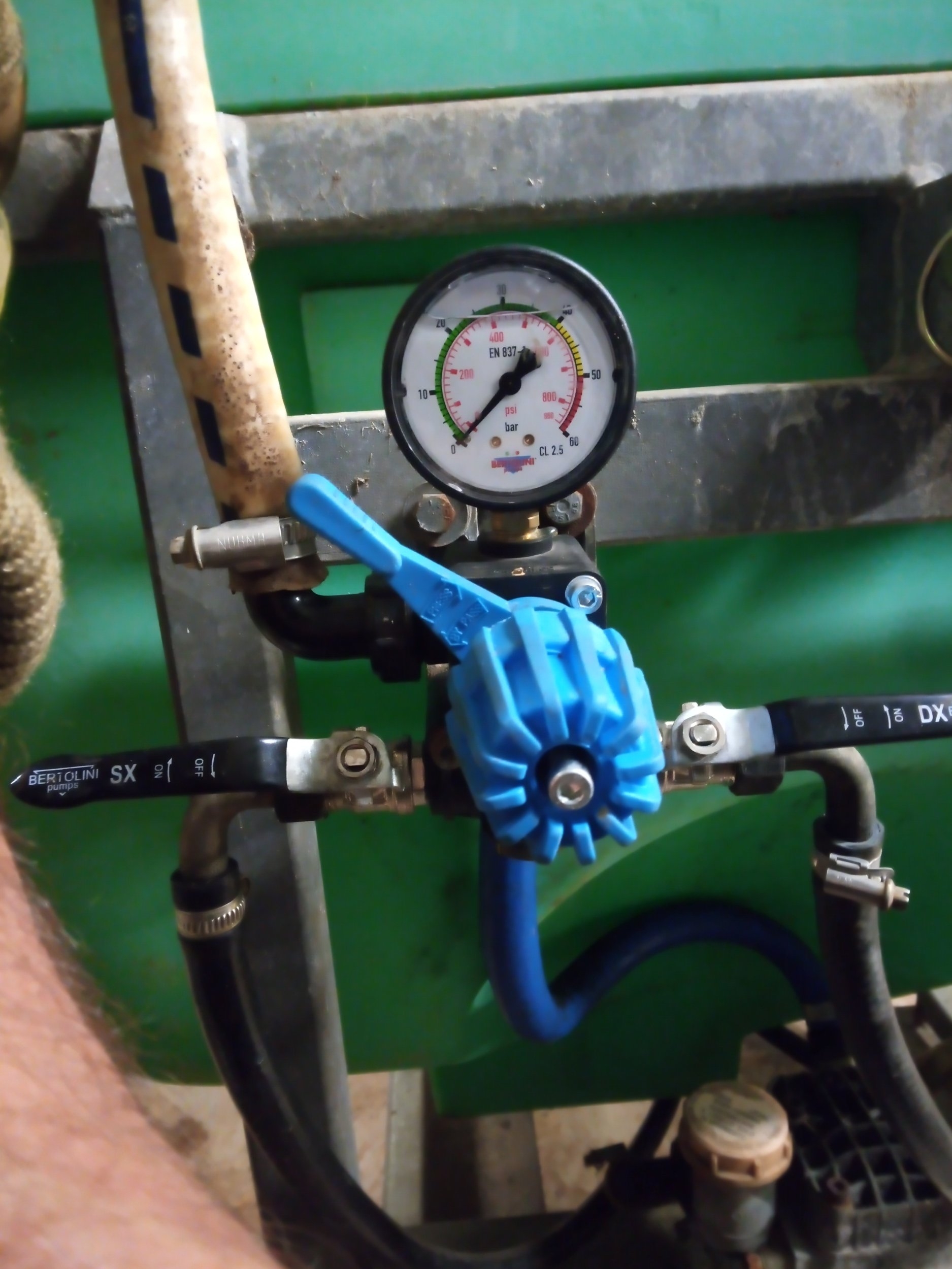

The pressure regulator and it's gauge are new and working properly. It is a direct copy of what was on the machine as I was able to buy the exact model again as a spare part. There's a photo attached of the new regulator.
I'm comfortable with the calculations to manage the rates of chemical application, but on hilly, rough paddocks I'm interested in lower volumes to make it safer to do.
Thoughts on the questions in the first post?

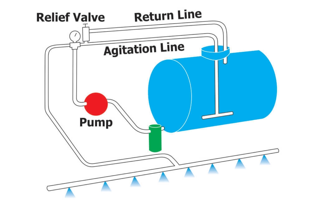

Still a bit hard to see but thanks for the photos.... Do you have anything to use as a bypass regulator or a relief valve? Like this one: "TeeJet 23120 bypass regulator"
What it does, it takes excess pressure and just returns it to the tank. You'll have less pressure to the noozles which reduces the spray volume so you can drive slower.

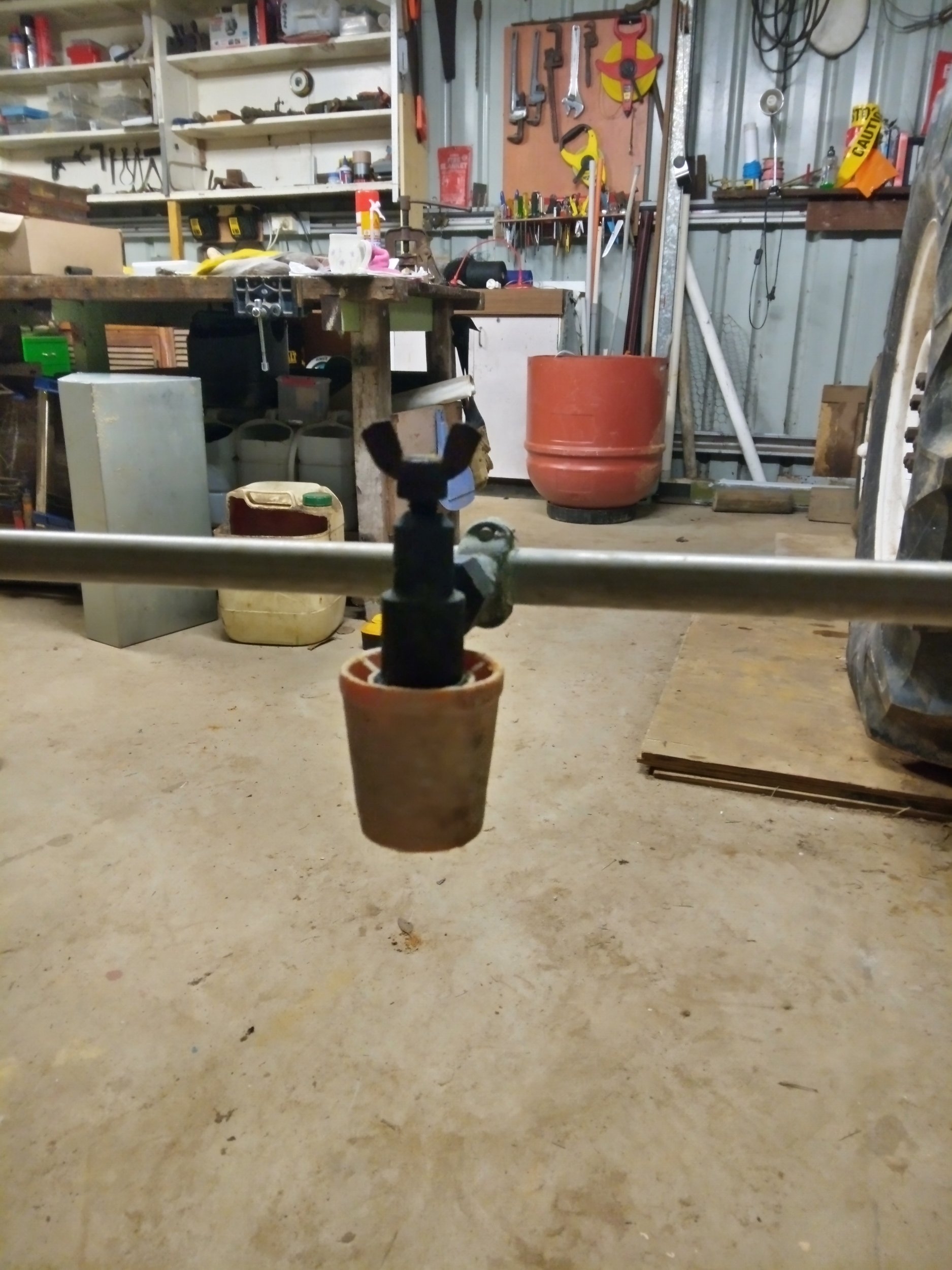

The regulator does have a bypass valve. The problem with lower pressures on these nozzles is that below 20 bar the nozzle outputs progressively degrade to become a narrow fan of big droplets which will give poor coverage.
I think the idea of different nozzles for different chemicals may be the answer. I'm coming to suspect that this sprayer was configured for Bordeaux mix. I'm having difficulty finding information on it's application, but I suspect it was applied at high volumes per ha/ac and as a mist to achieve good coverage.
I suspect that I will replace the nozzles.
Thanks for your help. It moved me forward in understanding how I can use this sprayer.

For RoundUp/glyphosate spraying, I would look for "flat fan" nozzle tips - I've only used Teejet brand. They come in angles, 80* or 110* (depending on nozzle spacing and height of boom) some are design to over lap the spray of the next nozzle; some spray an even pattern across the bottom (no overlap needed). I think 80* works for 20" spacing between nozzles.
