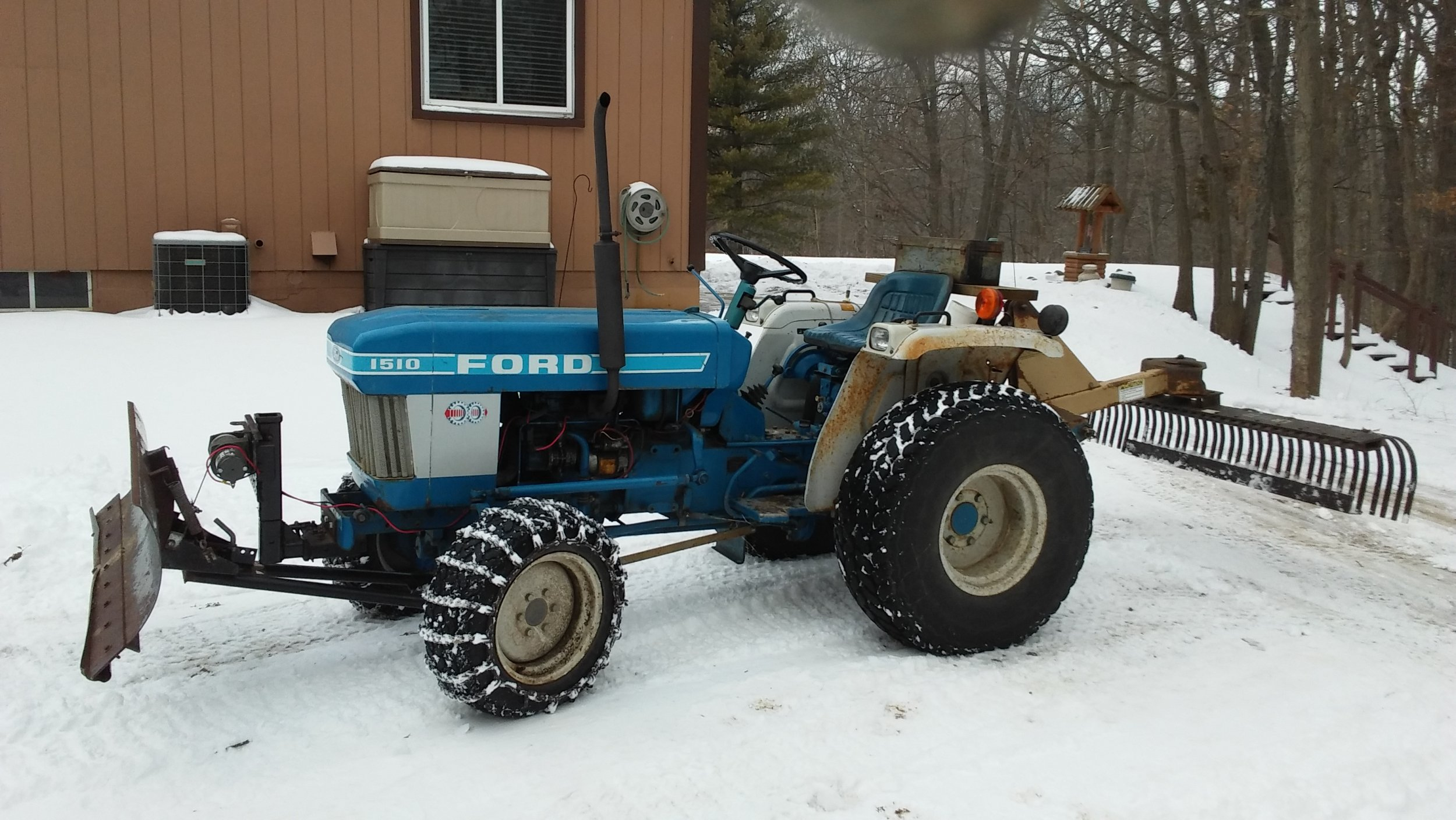

Cute little tractor. Way too small for my end use but cute anyway. Those tires are useless for my applications, hell, the tread pattern on my farm truck tires are more aggressive.

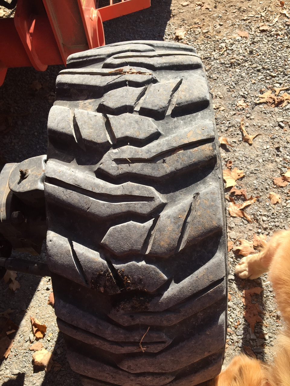

Like to see more groovy R4 tire analysts. Kinda of heavy duty DIY R14. Done both hot iron and chainsaw carving tools to cut grooves to improve hillside traction. Have limited opportunities in snow or ice but see improvements in other poor traction environments. Biggest obstacle is that you can’t buy them like tires or chains but have to make them. Then decide how to cut and best pattern.

Like to see more groovy R4 tire analysts. Kinda of heavy duty DIY R14. Done both hot iron and chainsaw carving tools to cut grooves to improve hillside traction. Have limited opportunities in snow or ice but see improvements in other poor traction environments. Biggest obstacle is that you can’t buy them like tires or chains but have to make them. Then decide how to cut and best pattern. View attachment 730891View attachment 730893View attachment 730895
I really don't remember anyone that did some "grooving" to their r4's reporting anything but improvement. 👍
I don't remember any particular pattern and I wonder if it just comes down to more "edges"?
/ Winter use Tires #33
More edges helps like sipping particularly on ice. Snow packs in grooves and snow-on-snow gives traction. See gravels stuck in grooves like studs but can’t confirm added traction. The grooves help with side hill slip.
R4 tires last longer and sure that grooving them lessens the life span.
On our farm have switched from R1 tires to R4 primarily for loader durability and lower landscape damage. There are comprises, always comprises. Same tires on the same machine with different operators can have very different outcomes.
YOU DA MAN.LMAO :poop:

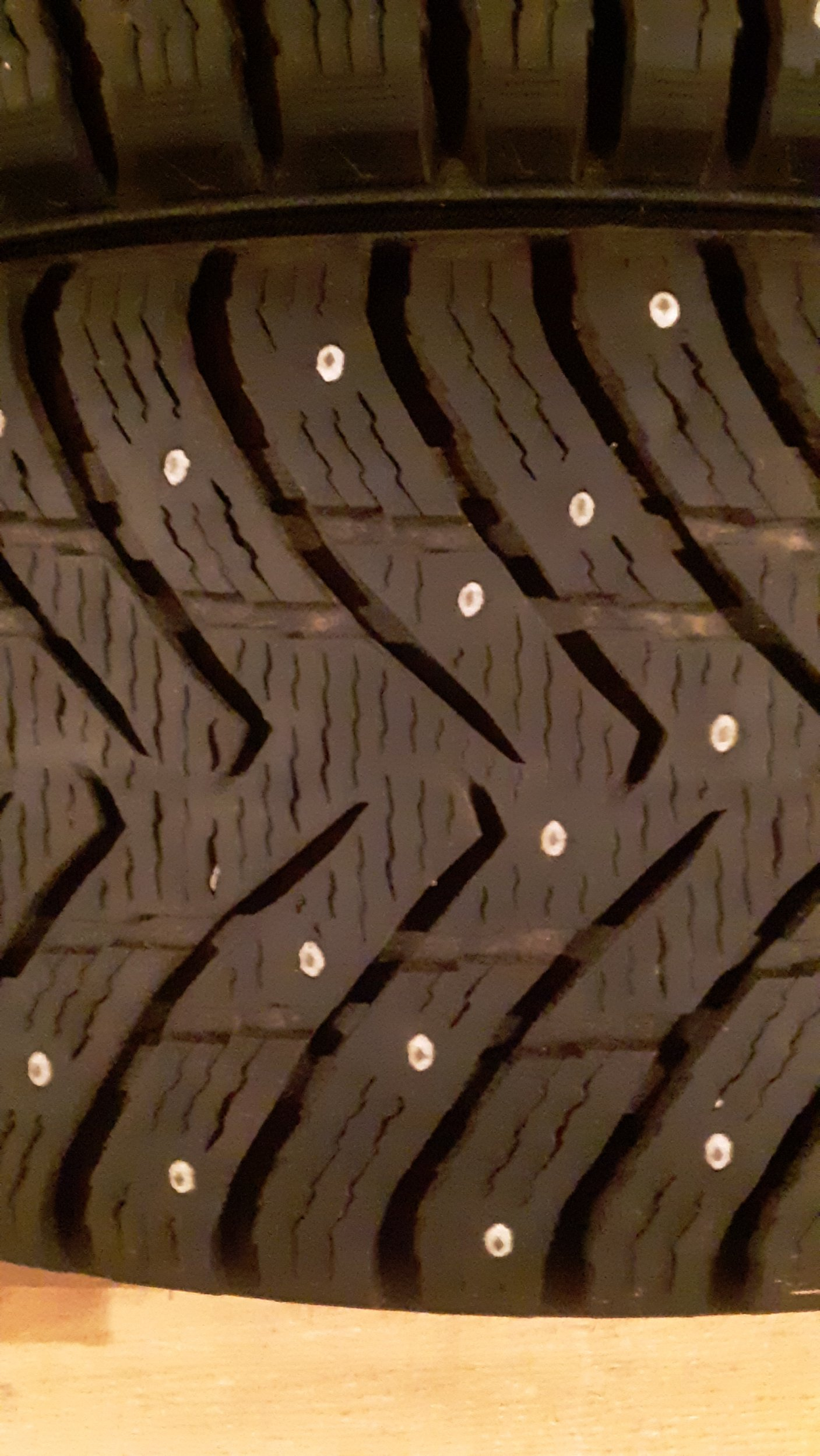

I don't know if there's any similarities, but this is a picture of the Nokian Hapxxx#@&%, (snow tires)
Now these are automobile tires, but notice the amount of siping (I think it's called). They also state that it's a softer rubber and that makes me think that it's not a good choice to run all year, they are pricey.

I don't know if there's any similarities, but this is a picture of the Nokian Hapxxx#@&%, (snow tires) View attachment 731046
Yeah, they are extremely pricey, plus it's the wheels too. IIRC, they're mounted on R1 wheels.
I think I read one is looking at between $4K and $5K to do the deed.
Regular turfs last quite a while and considering many of us put few hours (I'd estimate 60-80 hours a year for me) on our tractors...they'll be on a long time before replacement is necessary
