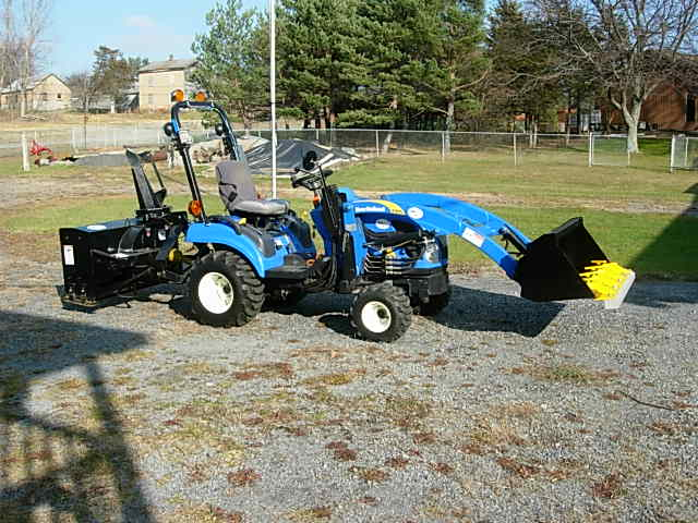

/ Winter use Tires #10
I've got loaded R4s in the back and 8 ply R4s in the front ...... with new chains still in the box because I've never needed them.

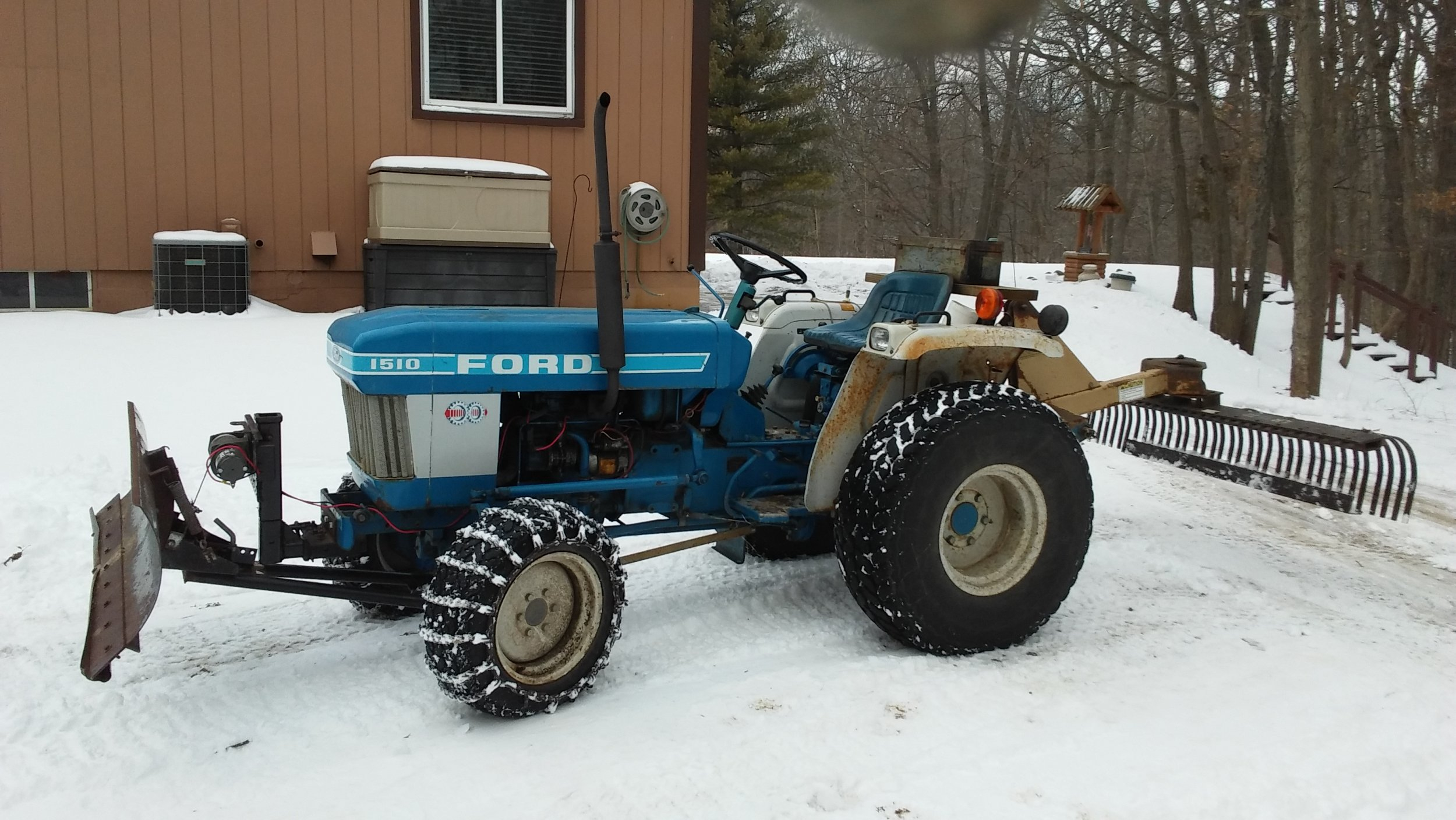

/ Winter use Tires #17
I keep hearing how great turf tires are in snow but mine are useless.
Two link ladder chains on the front of my Ford 1510 & I am good to go.
What am I doing wrong?
