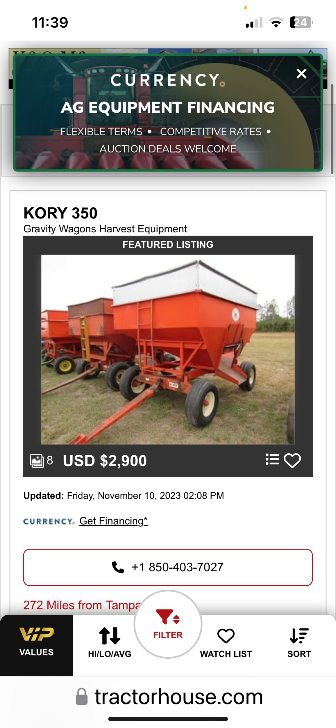

One of the smaller, old-fashioned side drop grain wagons could be filled with sand, cinders or any other suitable agent in the warm weather. The wagon could be easily covered to keep the contents, dry and easily offloaded and placed in the spreader.
Might be a possible to position the wagon, so the spreader could be filled directly from the wagon.

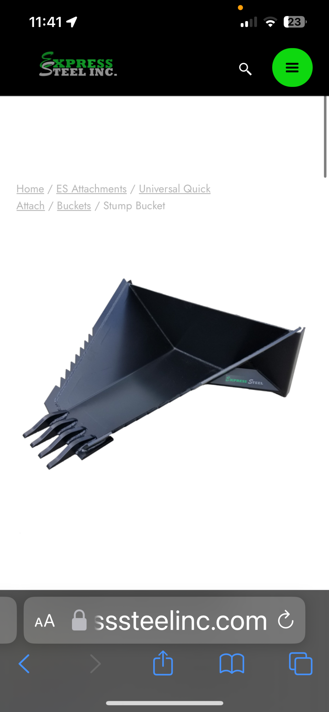

It would also be possible to dump the sand into the front end loader, bucket of a neighbors, tractor, and in turn dump it into the spreader. Without seeing the spreader, one might need to box in the front and loader bucket, so that it is narrowed enough to allow the sand to be dropped into the spreader without spilling. Or one of the stump digging buckets could dump directly into the spreader.
This would require some capital investment. But I think it would also minimize the manual labor required to keep your road open.
Right now, the plan is to use a storage container for the aggregate and load the AG spreader with the FEL bucket on my other tractor. I'll see if I can find a narrow SSQA bucket to make loading easier.
