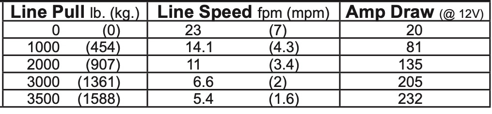

I have a 3500# winch on my ATV (a cheapo Harbor Freight Badlands winch). Per the owner's manual, it draw 20 amps when running with no load, 81 Amps @ 1000# load, 232 amps @ 3500# load. So it's no surprise that a bit of winching will easily drain a typical ATV battery in short order.

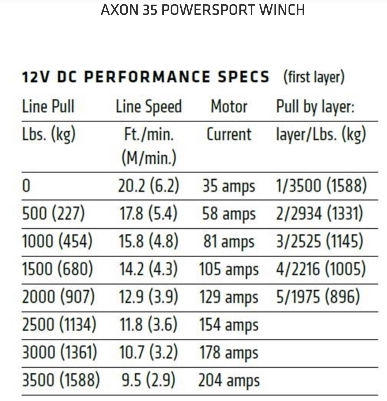

The cheaper the winch the higher the amp draw under load. That's one of the reasons there's a price difference.
There is a difference, but even a quality winch FAR outstrips the capacity of a typical ATV alternator. Here are two tables pulled from the manuals of a cheap Harbor Freight Winch and a Warn Winch. Same pull rating, but different speeds under load.
HF Badlands 3500# Winch first layer line pull
Warn Axon 3.5 Winch
Yes, the Warn winch draw fewer amps and does so while pulling at a higher speed, but they still draw a LOT of amps, even for a small winch like this. In some cases, it's enough to permanently damage a small ATV battery. Keep your engine revs up, and pull in short bursts, allowing time for both the winch and the battery to cool.
Warn Axon 3.5 Winch
Yes, the Warn winch draw fewer amps and do so while pulling at a higher speed, but they still pull a LOT, even for a small winch like this. In some cases, it's enough to permanently damage a small ATV battery. Keep your engine revs up, and pull in short bursts, allowing time for both the winch and the battery to cool.
Oh yeah, make no mistake, I am not saying an ATV will survive with hard use of any winch, regardless of brand. Maybe someone with an ATV can tell us what their charging amps are?
