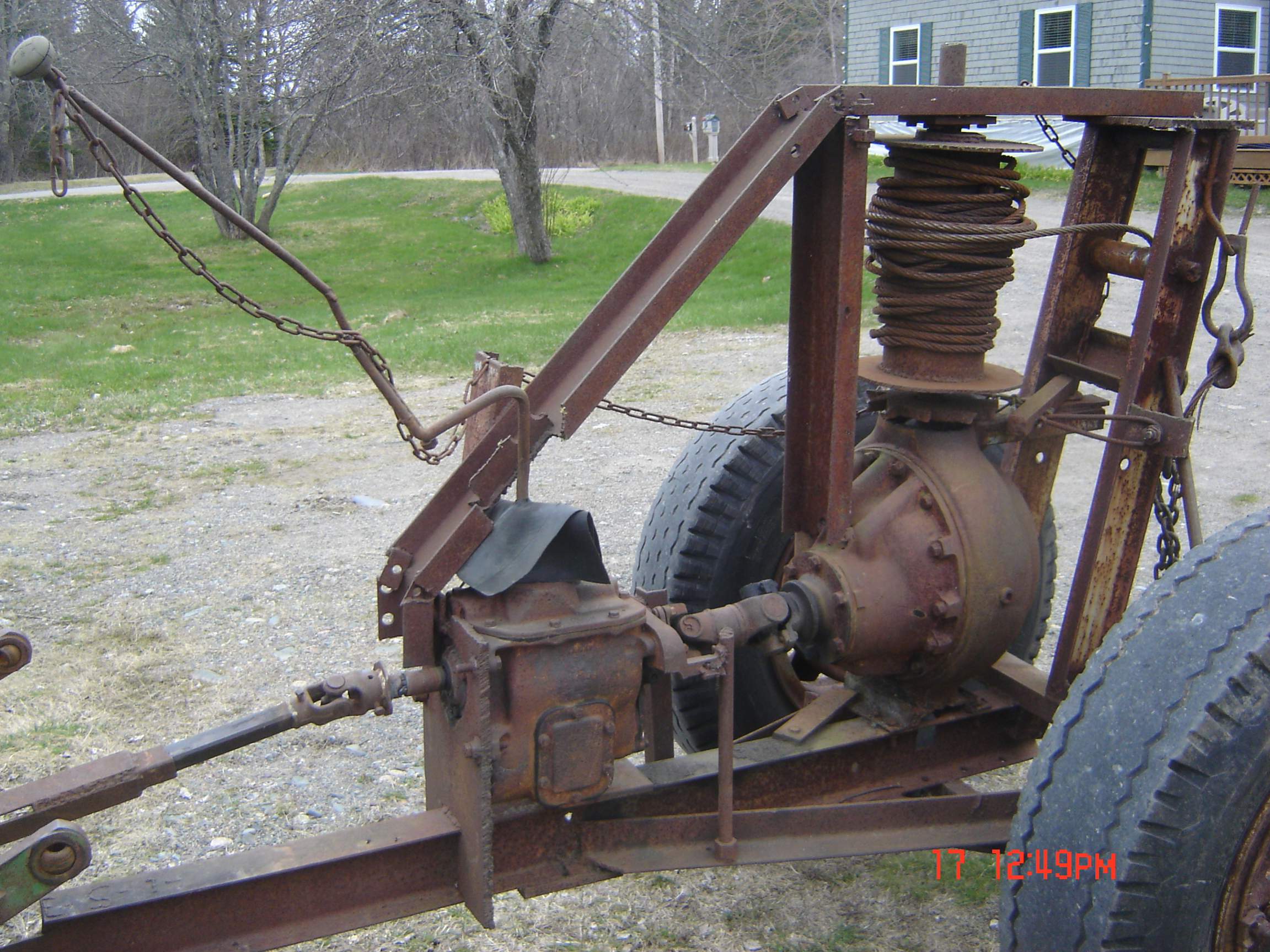

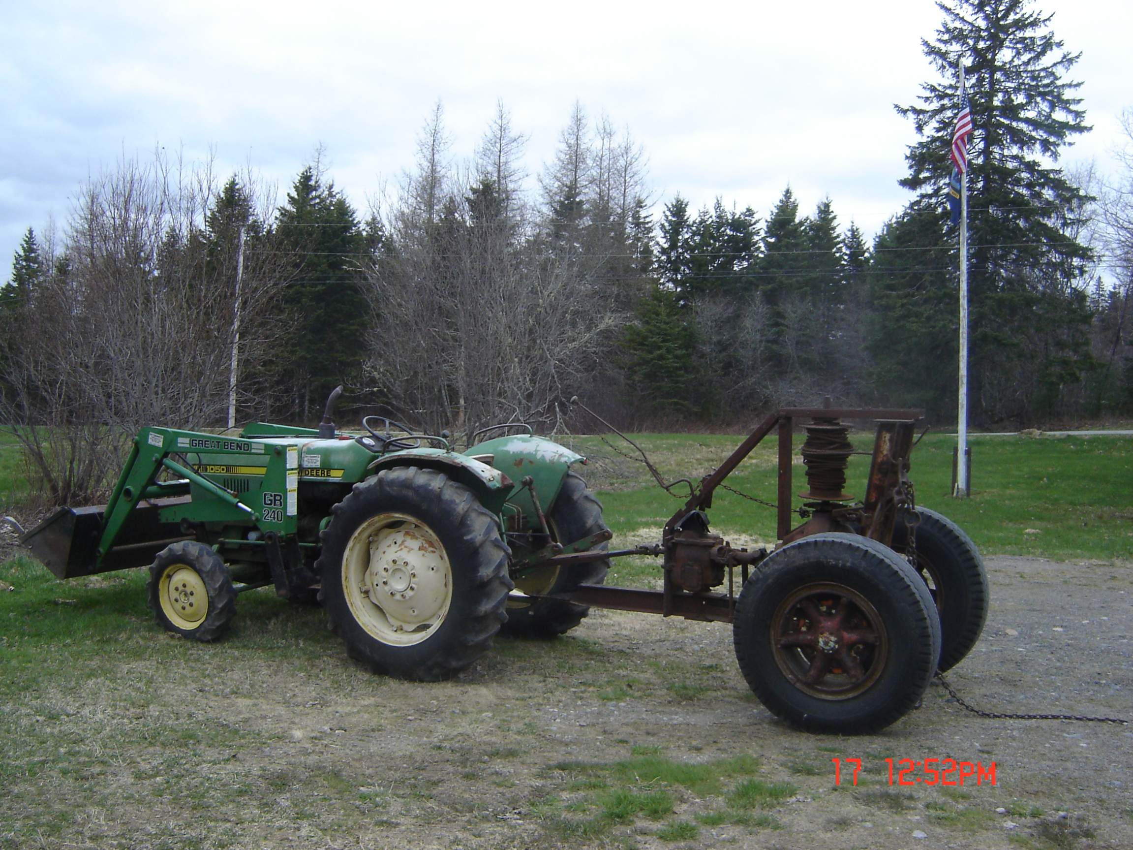

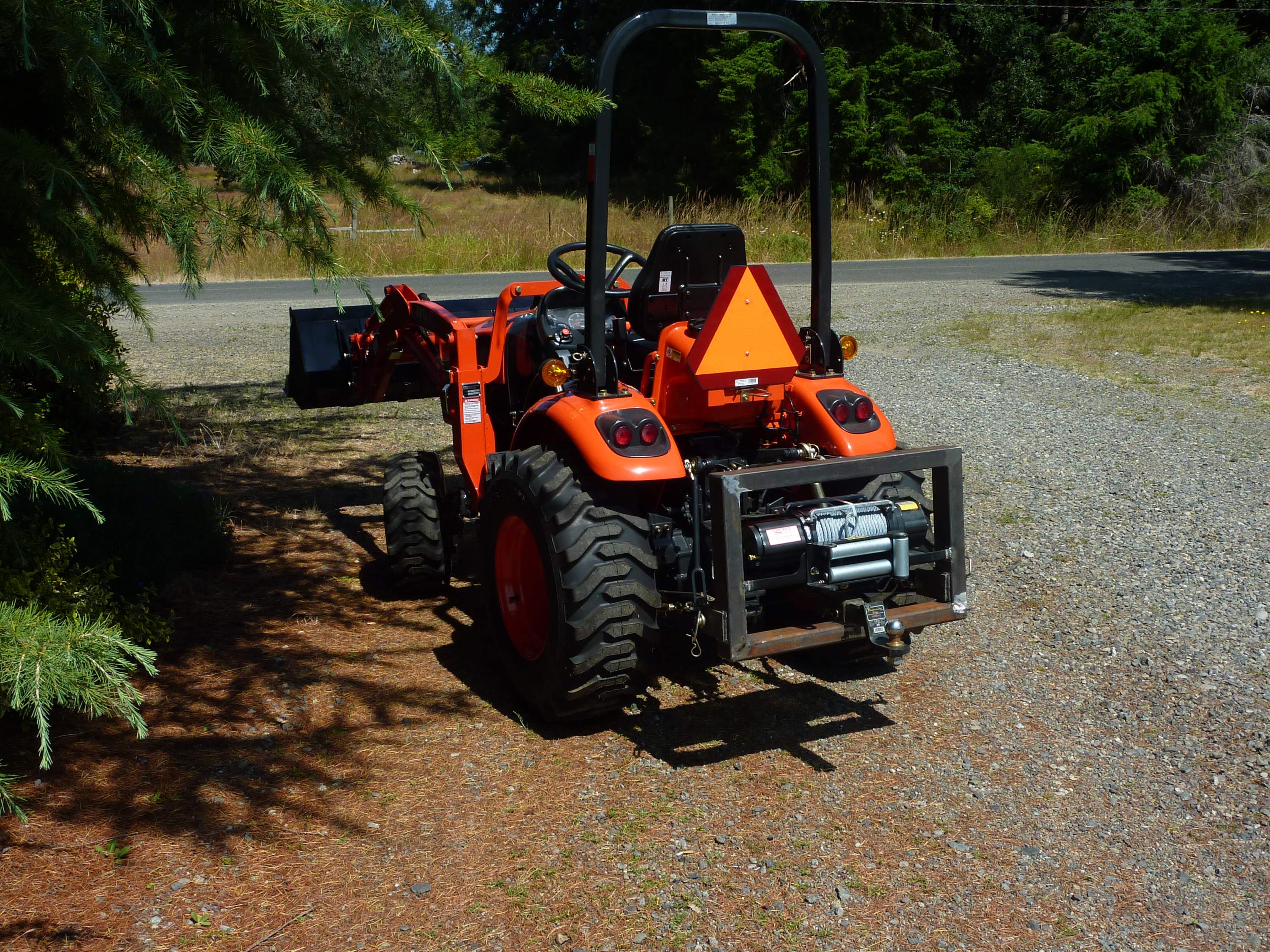

Here is one I built for my larger tractor that is hyd and the smaller one is electric. Just for ideas sake.

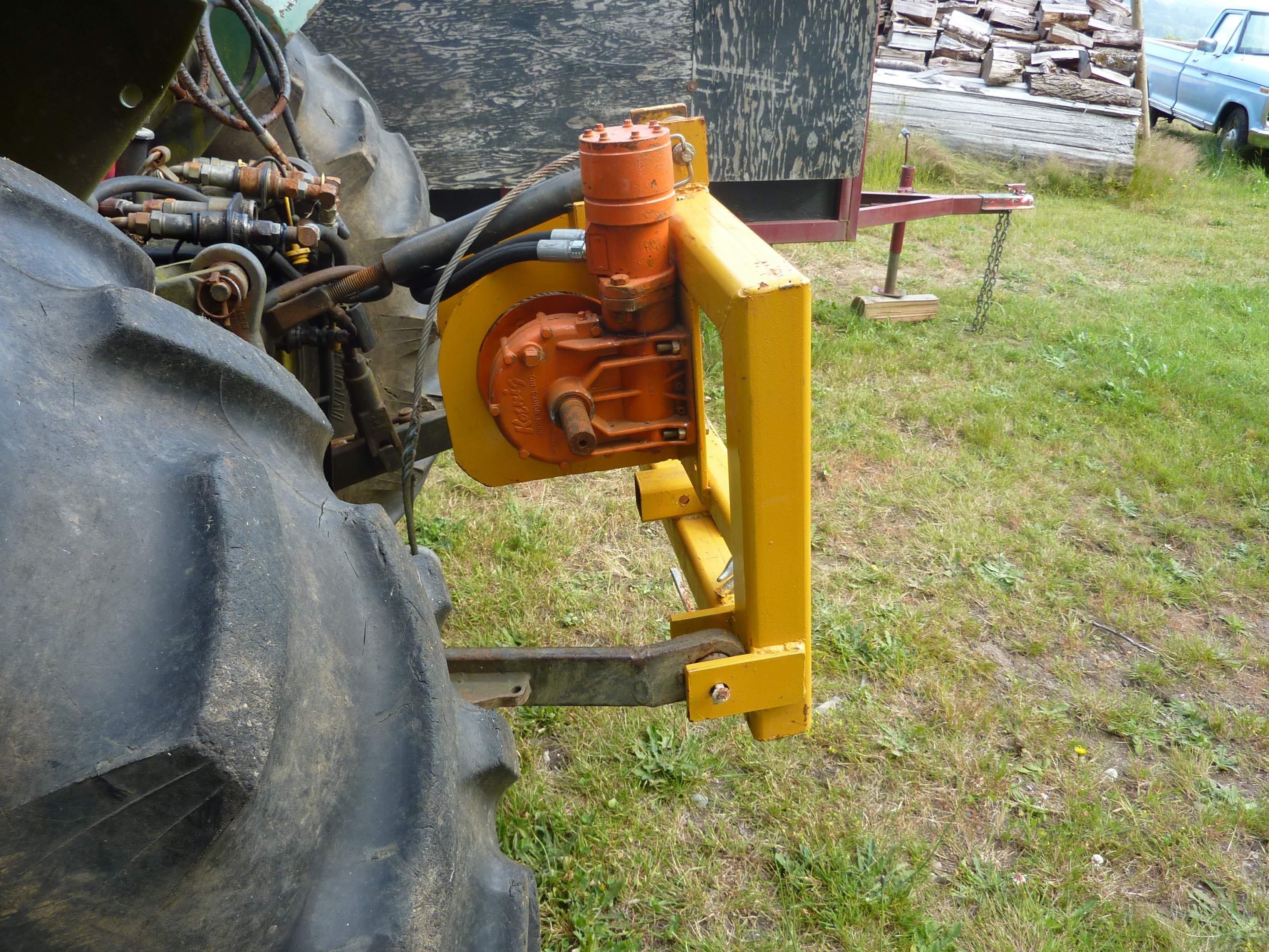

These winches are slow and not for production. I have a hyd one that is in the loader frame with a smaller motor in it and it works very well. I just had this one setting around and figured I would make something for the rear. It also has a boom that replaces the toplink. It extends about 3ft past the frame and can be fitted with tongs or a pulley. When down the tongs can reach the ground and when lifted the get about 5ft up.

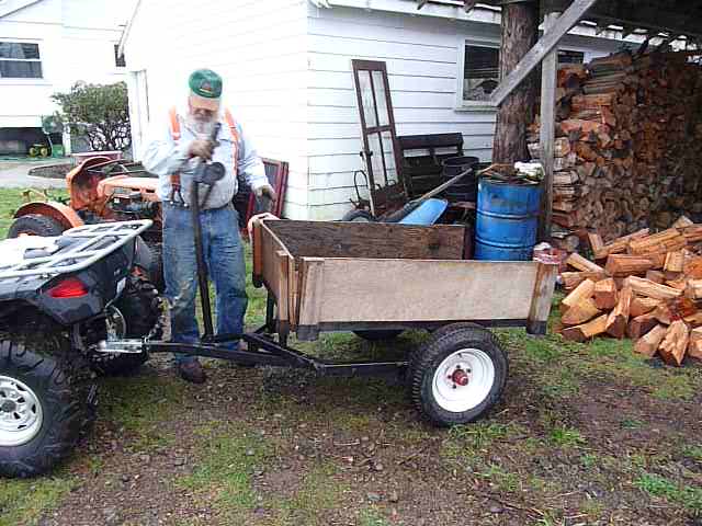

I put this on when I am not using the tractor for other purposes, keeps the arms stablilzed. Built the one for the wifes tractor so she could use it for pulling her trailer around and getting herself out of a problem as I am gone a lot.
In another forum way back I put an arch in. I really like the one featured here. It is nicely built.
The one I built in the 80's ws for a 25hp kubota and doubled as a trailer. It was built much heavier than this one, but is good for ideas.
I think I remember seeing that arch before, I really liked the fact it was convertible to a trailer. I think come spring I may have to get the welder out and see about converting mine to something similar. Mine is strong enough, but single purpose.
Nice job !

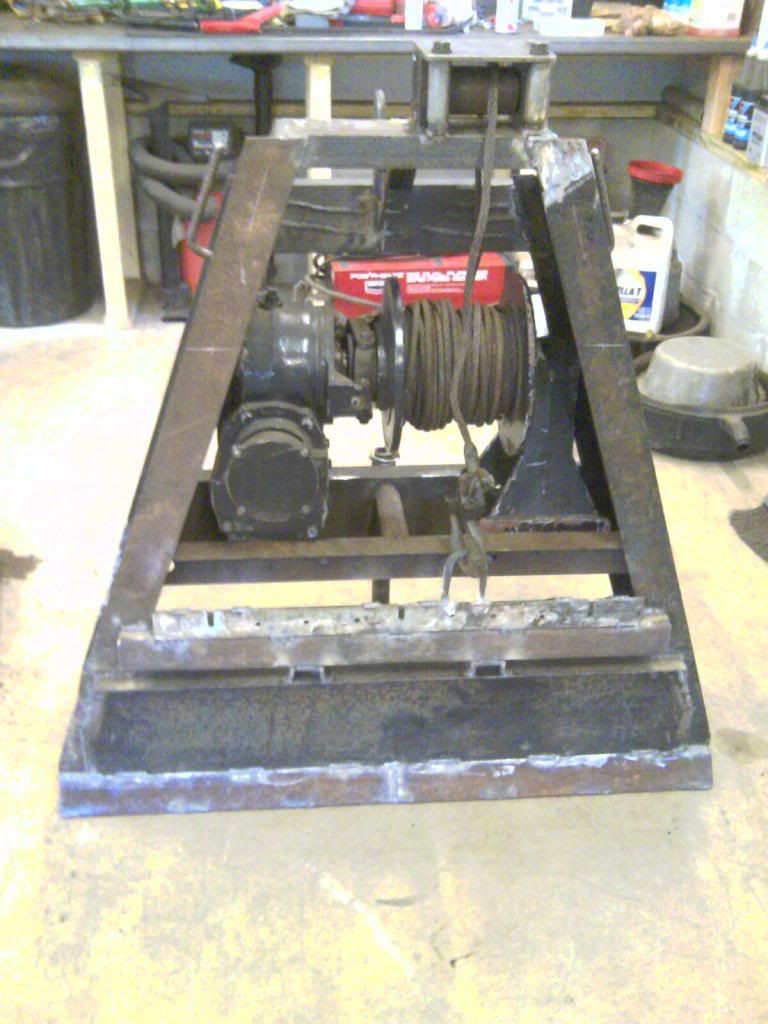

I'm in the process of building a similar winch that will have a former tow-truck winch as the power. It has 40:1 gear reduction and I calculated that if I use a 20 tooth drive sprocket and a 10 driven socket that will give me about 35ft/min on the bare drum and about 65 ft/min on a nearly full drum recovery speed depending if I run the PTO at 540 rpm. However. I do not intend to run the PTO at full speed but more like in the max torque range that is about 1600-1700 engine rpm. I don't know exactly what PTO speed that will give me but I would guess around 300 rpm.

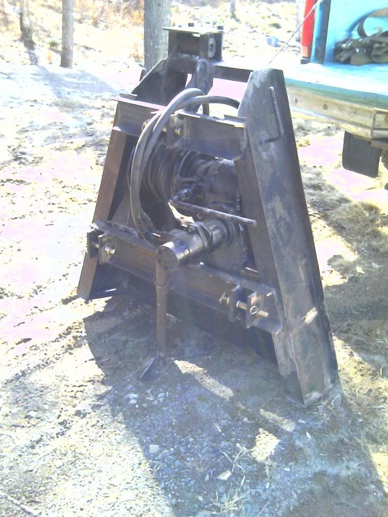

here's one i built for a friend last year. he supplied me with an old mobile home tongue, a holmes wrecker body winch, and a few other odds and ends. i found it extremely slow when seeing it on his tractor, but it would pull pretty much everything he hooked to it. i think his tractor has a pretty low flow, so on something with more zip, it might be better. either way, it pulls stuff that you can't get by hand, and it was a few thousand cheaper than buying one. just last weekend i hauled home a new used tractor for him, and it came with a pto skidding winch. he'll probably be selling this one now. must be a maine thing to turn a wrecker into a skidder :D

That is a very well done fabrication job. Lots of thanks for posting the pictures. I'm sure your friend will sell that winch in the blink of an eye. As you know those things are highly prized and priced accordingly in Maine. What kind of tractor was that winch used on?
My winch looks just like that except that it is the previous - PTO driven - version as opposed to the hydraulic that you worked with.
Do you happen to know the RPM of that hydraulic motor? I'm asking because I wonder what is a safe input speed on those winches. Please bare with me I know I do have a lot of questions.
