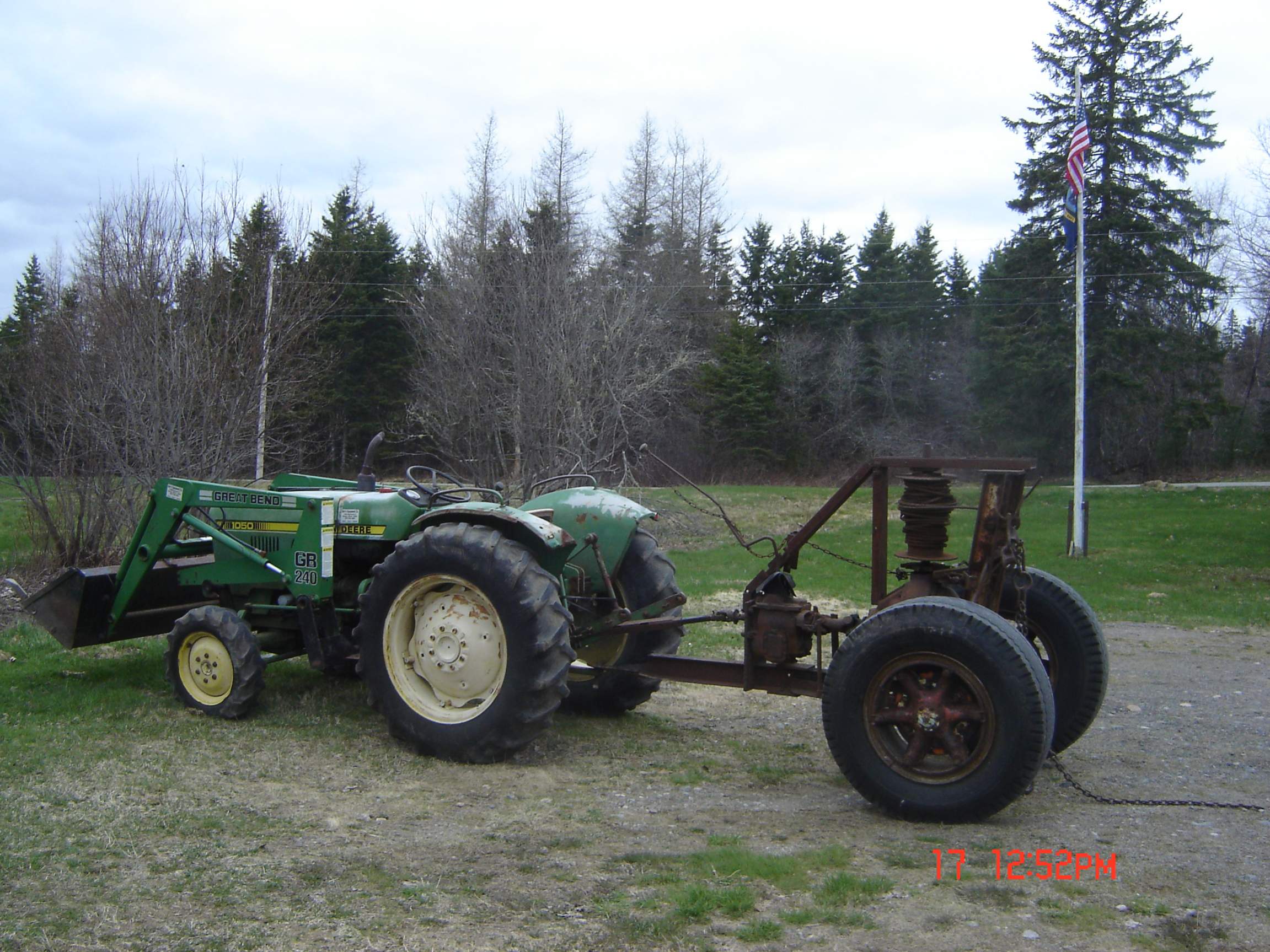

If you are making a winch for skidding logs and option would be to consider mounting it on a small trailer in conjunction with an arch. This will lift the butts of the logs up off the ground when skidding without making the tractor tippy. You could also put a transmission in between the PTO and winch to reduce your line speed.
Kevin

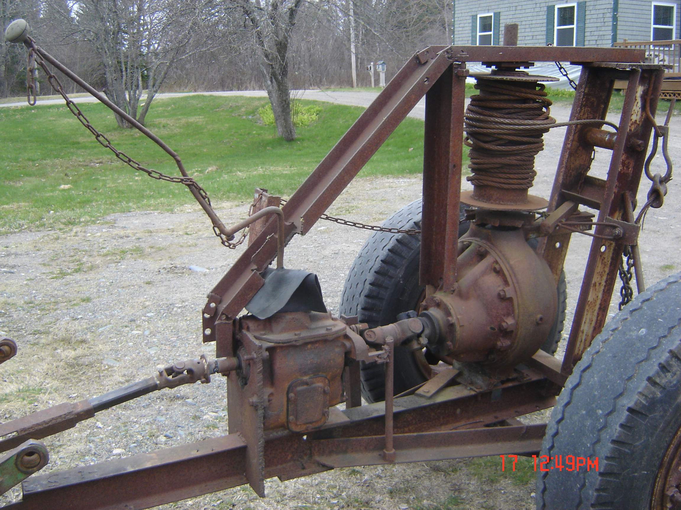

/ Winch calculations #14
Snowstorm,
That thing is a classic. Did you build it? I would be curious if the fairlead actually has a roller or it's just a piece of steel the cable slips over?

Hey snowstorm, I thought for certain you were from Newfoundland canada with that set up. Nice job. How did you seal the rear end to prevent water?

I like the ratchet for locking the cable. Is that a rear axle making the right angle?
Before I put the the axle with the drum down into the rearend I took a piece of inner tube about 12 x 12, cut a small hole in it, stretched it on over the spline and slid it up to the bottom of the locking gear. Not very fancy, but it kept rain and snow out of the rearend for more than 20 years. It got pulled down inside the rearend before this pic was taken and it had not been removed yet.

Snowstorm,
The fairlead is a homemade one - a piece of shaft with a piece of pipe over it. I need to replace it with one with bearings.
