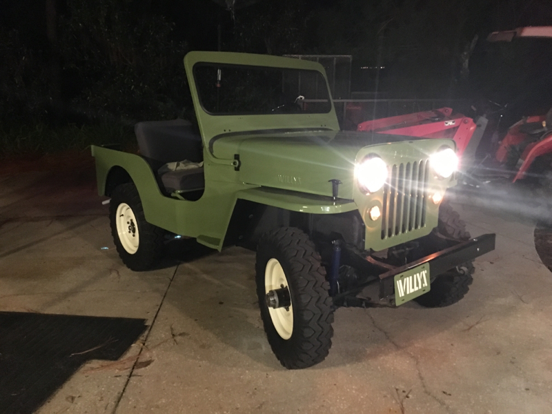

Thanks guys. It has been a great learning experience. I have done lots of mechanical work on vehicles but very little body work and no metal work. I have vastly improved me welding skills and learned a lot. I am proud to say that I personally have done everything on this jeep. So, even though some may not be perfect, I did it.
And yes, you can buy all these panels from places like Walcks or Kaiser Willys, but I can't spend that money for this project. I would love to be able to one day. I have to remind myself this was free so I have to keep things inexpensive. I believe when I am completely done I will have between $2500 and $3000 in the entire thing.

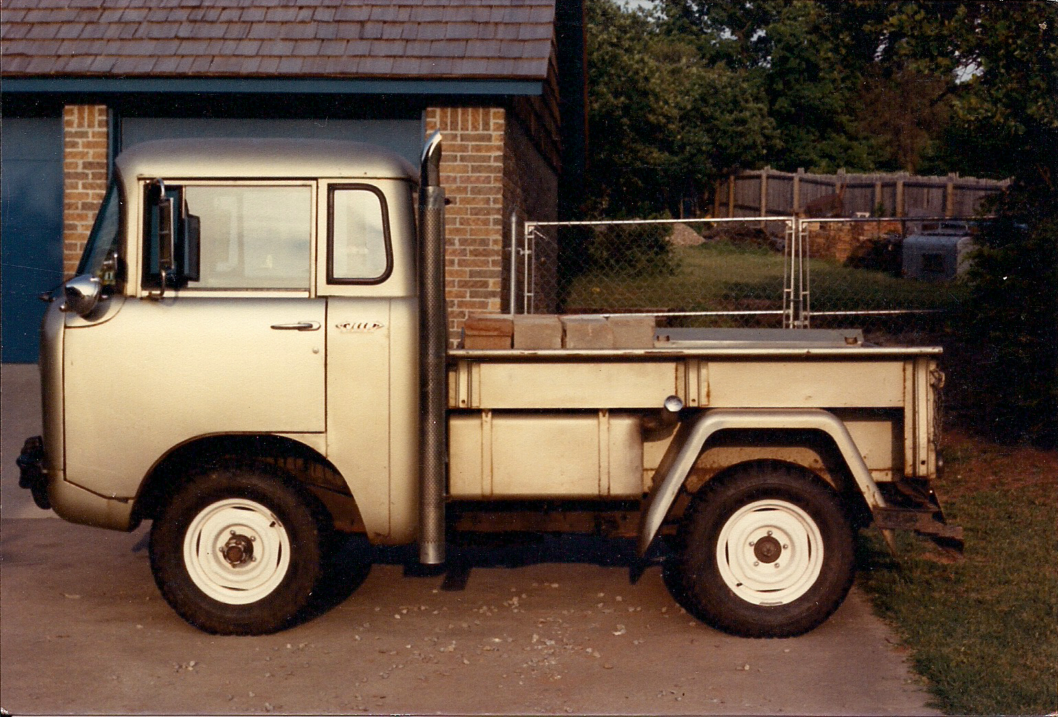

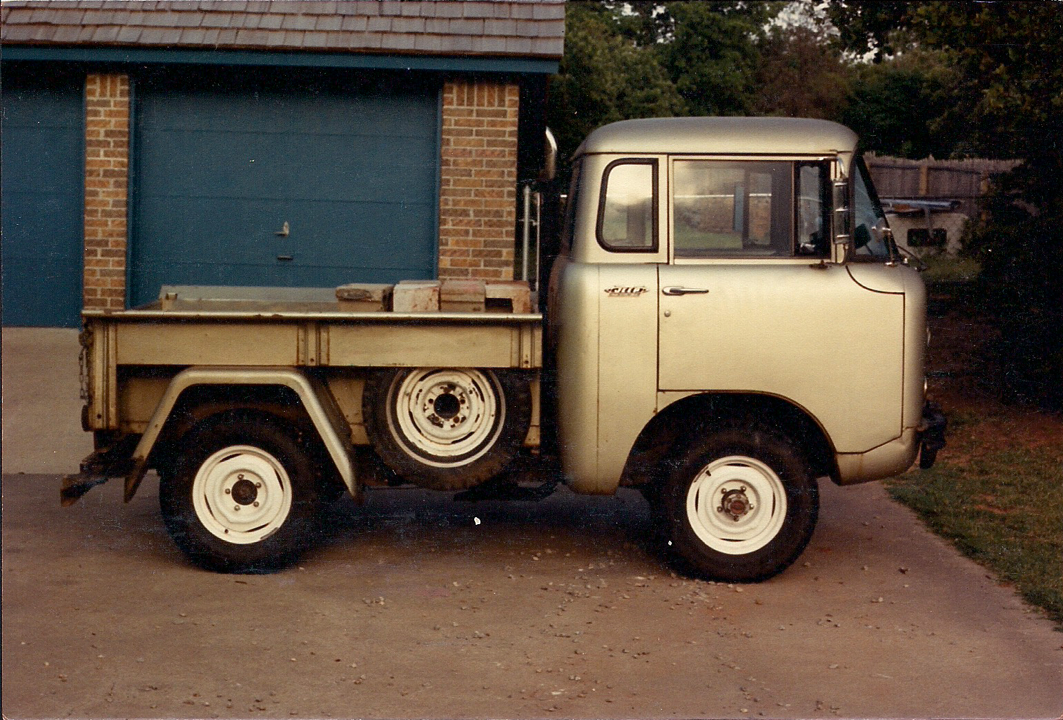

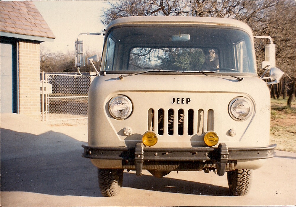

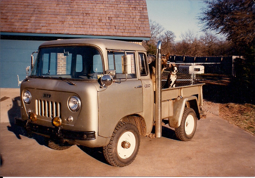

The FC comment caught my eye, since I have owned three in the far distant past (1980's).
FC is Forward Control, Here is the one I used to drive:

Very nice FC. One day I will own one!

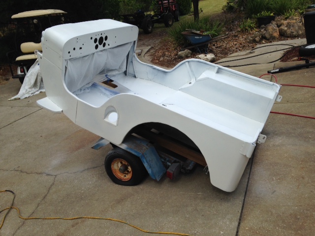

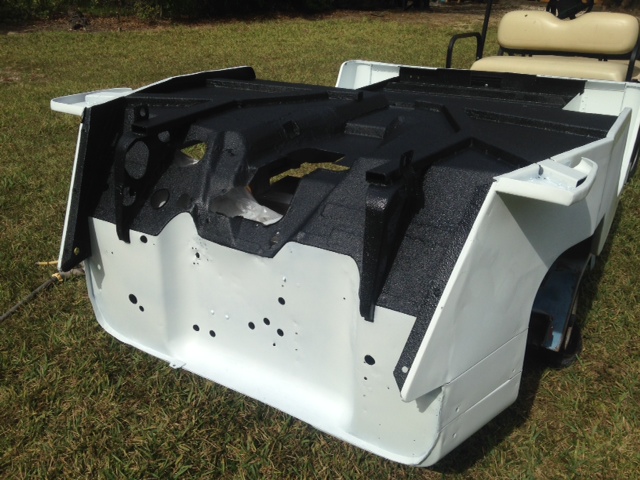

Here is the tub after a coat of epoxy primer. I was fighting rust starting because this was taking me so long to get the metal work complete so I decided it was best off getting it covered.

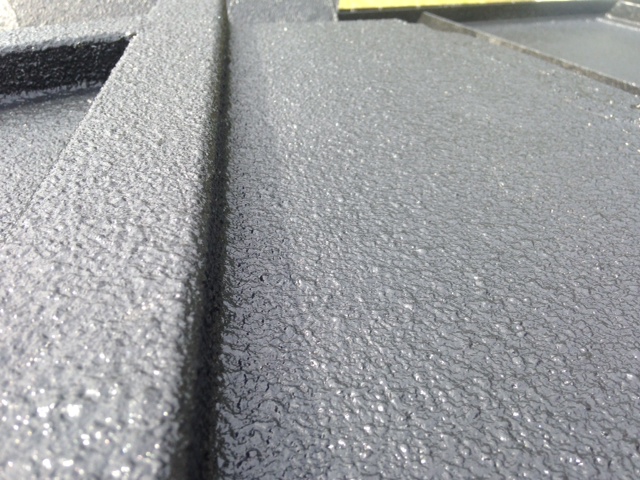

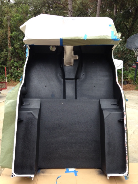

Here is the bottom coated with Raptor Liner. I love this stuff so far. I had never sprayed bed liner before but it was real easy to spray. I used a Schutz gun. I later decided to also coat the firewall with the same stuff. I did the entire bottom of the tub, inside all the fender wells, entire engine compartment, and the interior in this product.
Here is a close up of the texture.
Here is the interior after Raptor Liner.

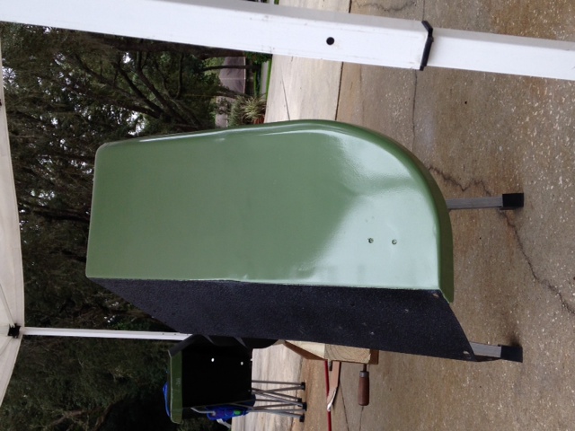

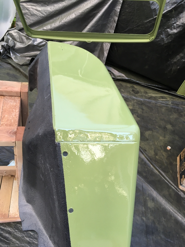

Here is what I picked for my paint. I found it just looking through a color book at the auto paint store in town. I think I like it.

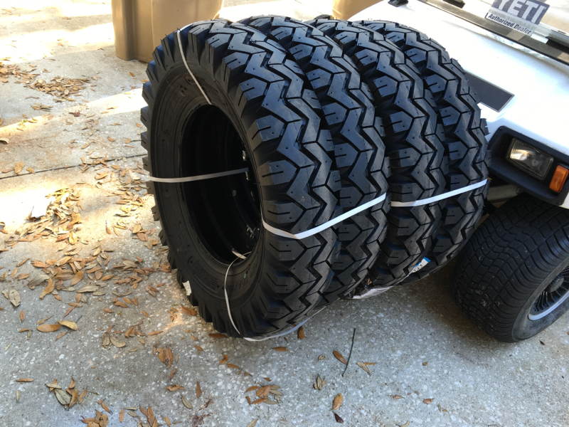

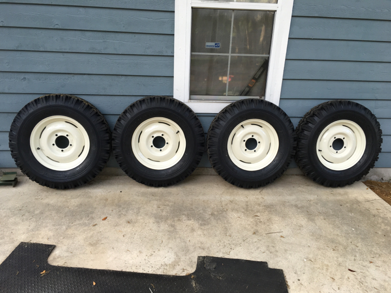

These are the tires I chose to run. Can't wait!

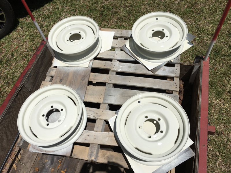

Here's my wheels after welding up all the bad areas and painting.
And the two together.
Did these have the gas tank filler neck in the cab? Seems I remember filling one up for a guy at my Dad's gas station and he had to get out of the drivers seat for me to put fuel in.
Then again, he was always modifying stuff and maybe it was something of his own doing
Edit: I now see the filler neck on the left side of yours so it must be some mod he did.
   / Willys cj3b #27
Yep, this is the stock location:

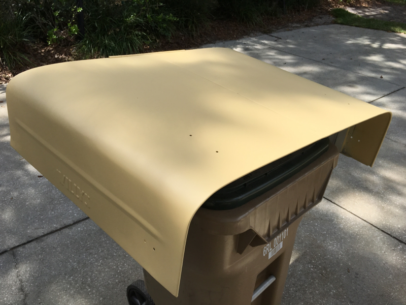

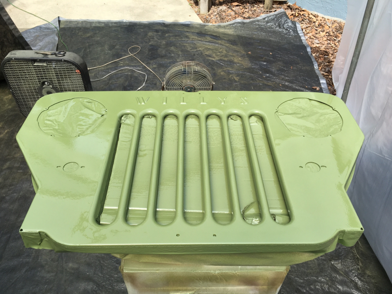

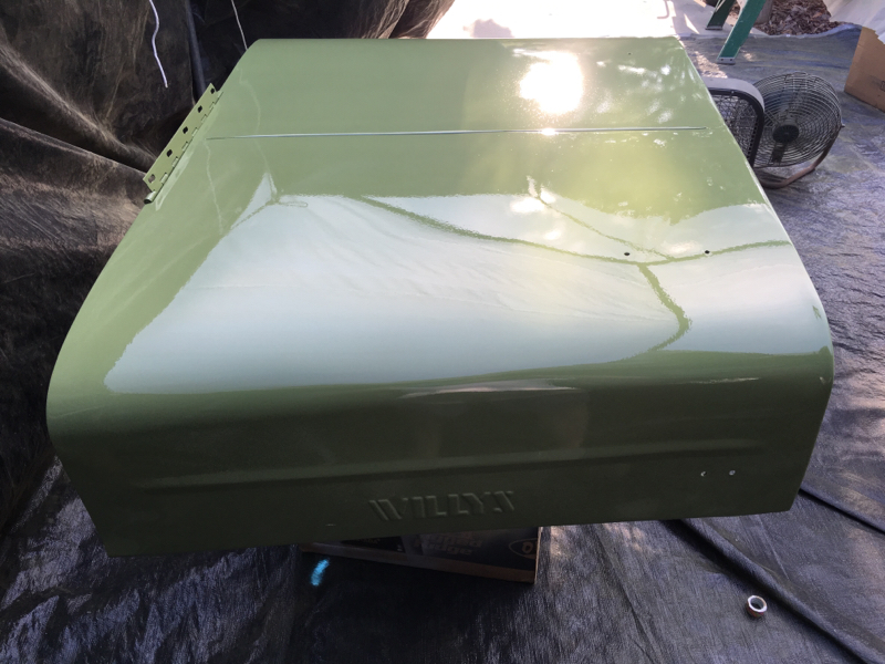

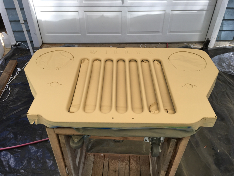

Started spraying a high build primer on hood, windshield frame, fenders, and grill.
Sprayed base and clear on same parts.
