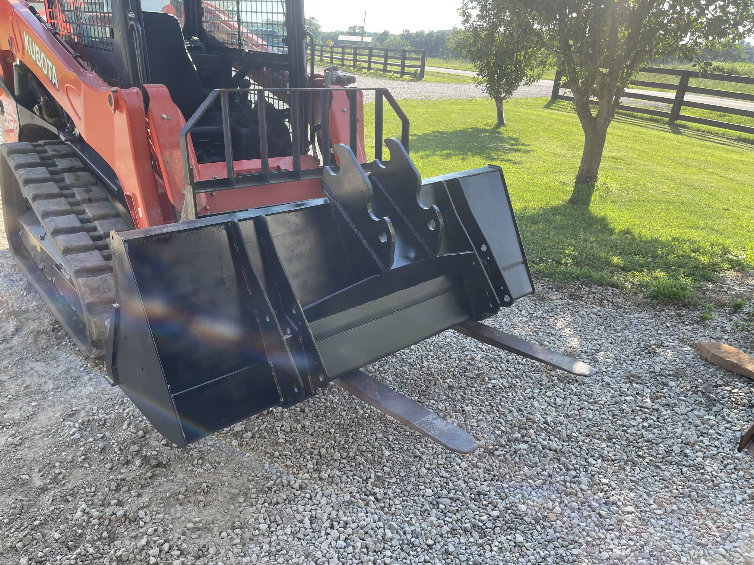

We’re done. I didnt prep it too much, the old bucket is pitted a little. Need to drill a couple of weep holes so water doesn’t accumulate. I’m happy with it, its bigger than my first one.
So i have $650 in it. $250 for the bucket, $300 for the adapter, and $50 for steel, and $50 in paint and rods, grinder discs.

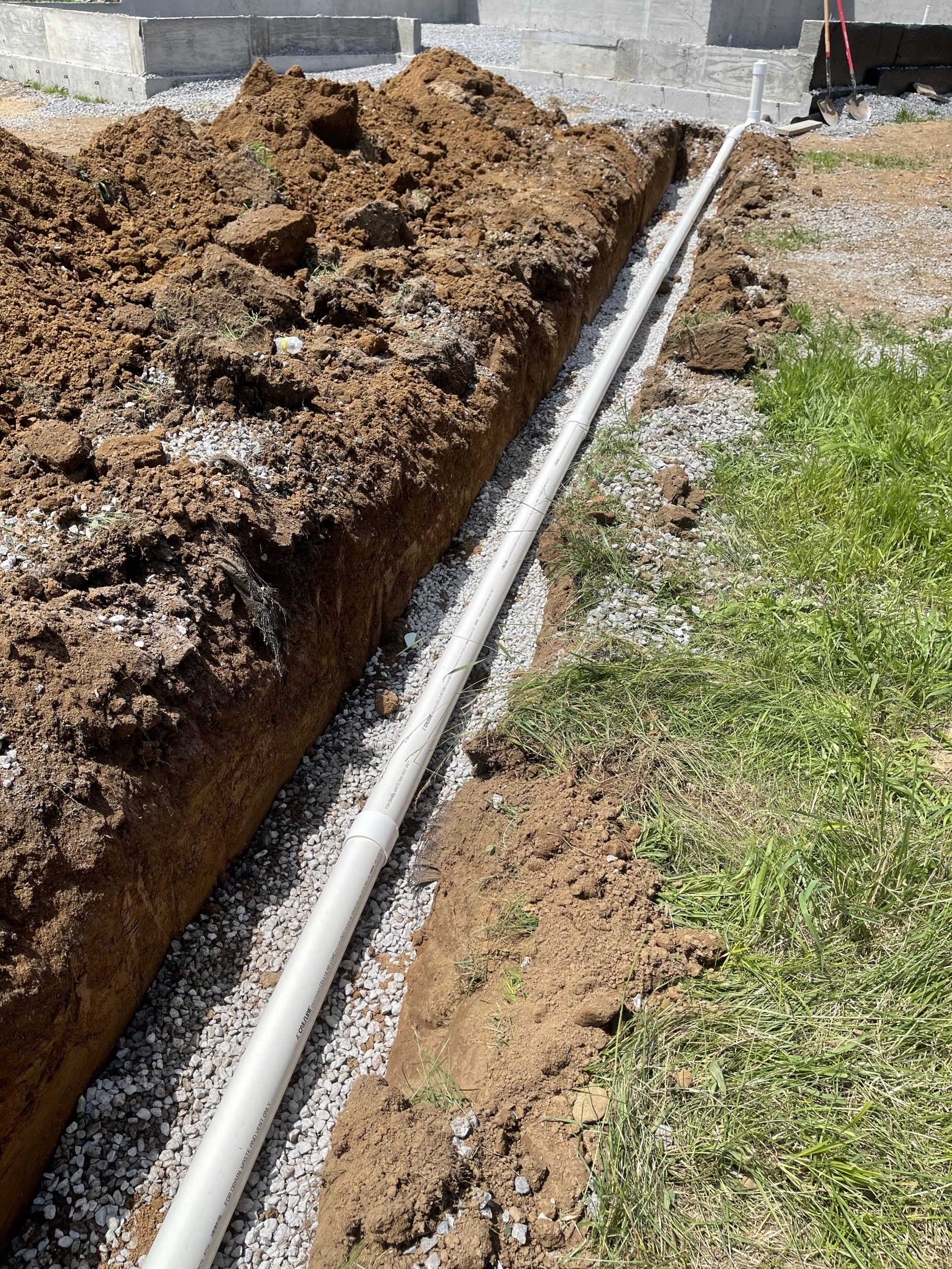

It will make graveling these quicker. Gravel pile is out front and i have to bed this with 4” gravel above pipe. Takes forever with a 2’ digging bucket.
I revisit this thread if it cracks. Don’t anticipate that though…

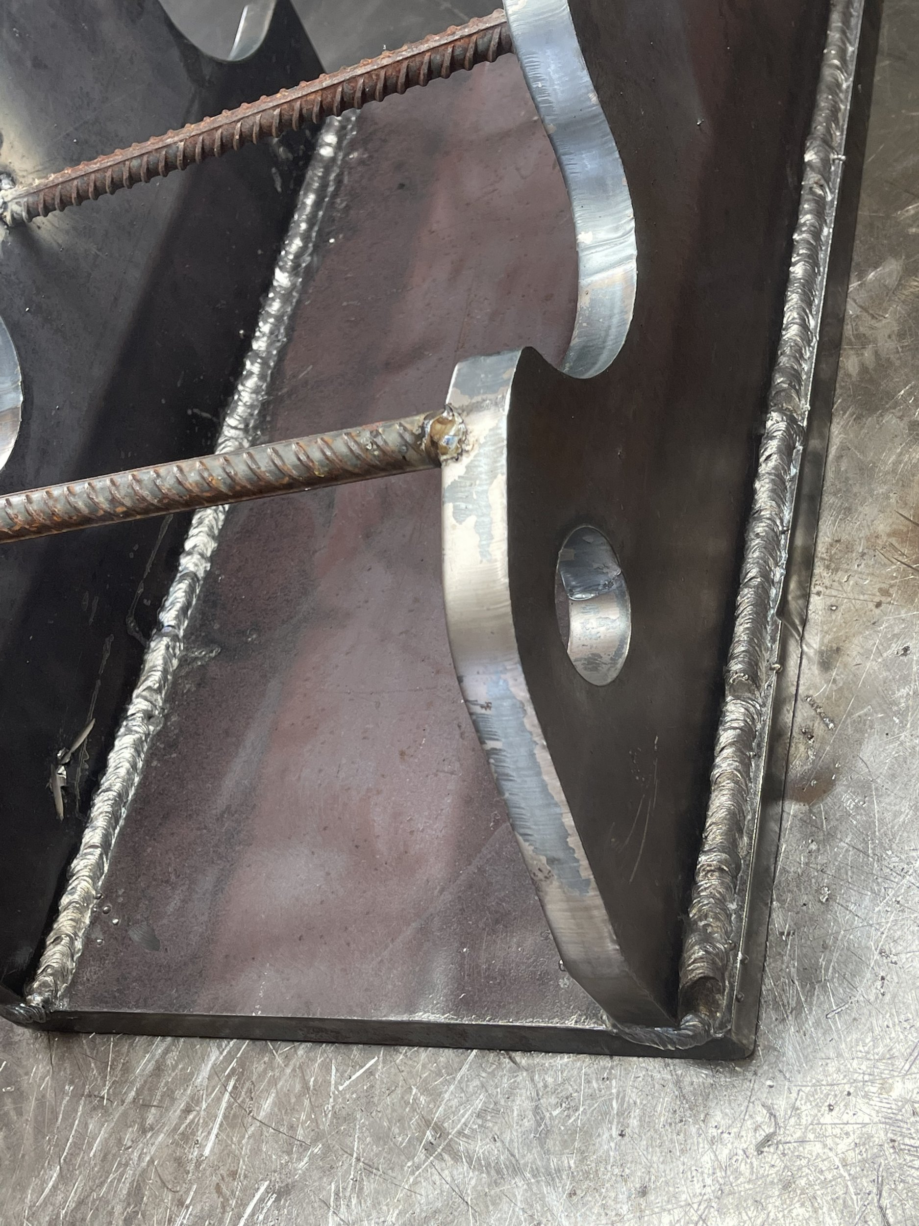

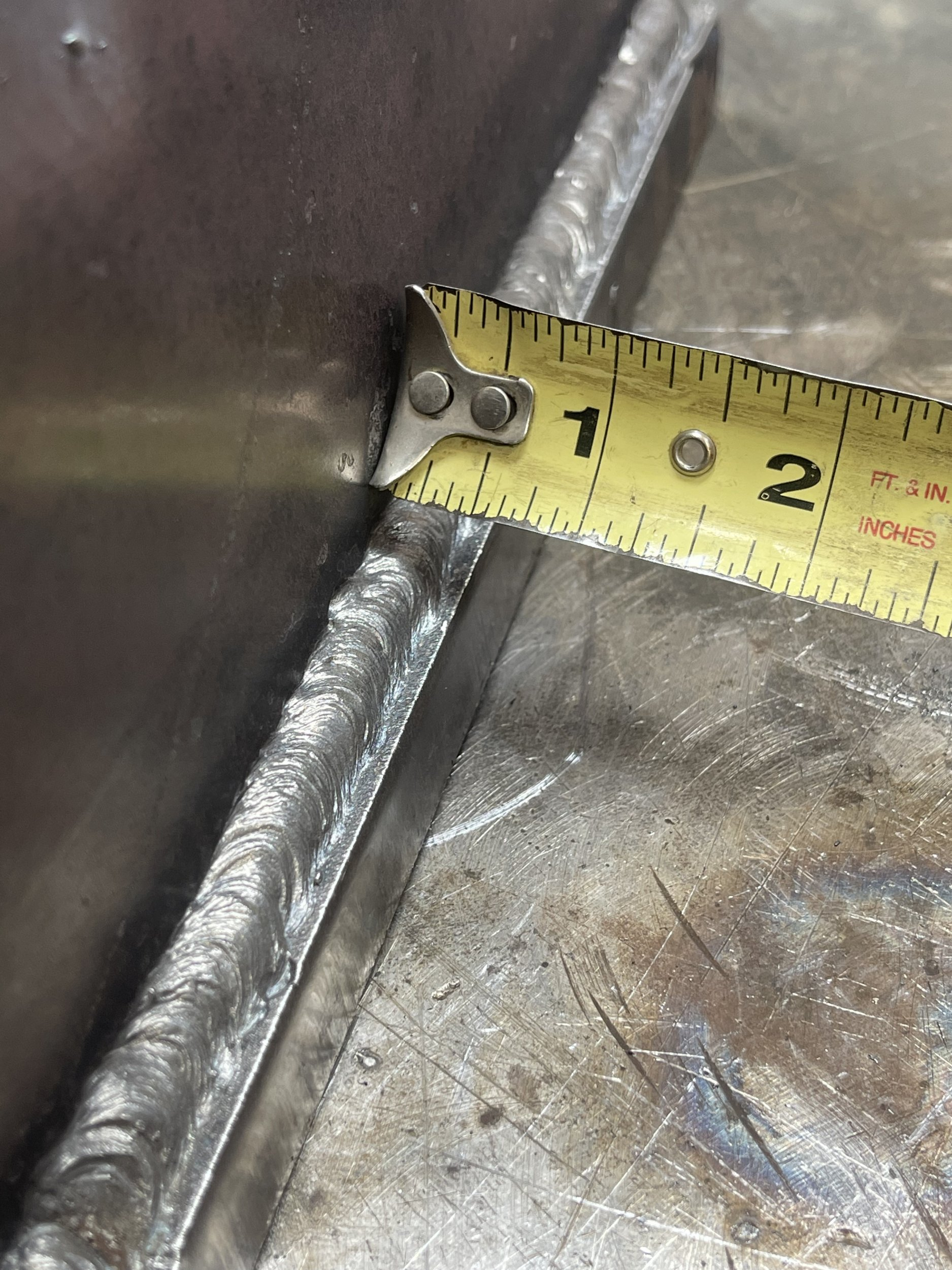

No doubt beveling is good practice, I wonder why manufacturers dont. Seems its just sop for the home craftsman. Plus manufacturers all use mig. How does penetration from .35 gsaw compare to stick?
The machines commercial manufacturers use are much more capable than the machines in most home workshops. I doubt you’ll find too many MIG machines rated more than 180-200 amps in home shops. I have a Lincoln PowerMig 256 that is 300 amp and capable of welding 1/2” in one pass, provided you use the correct gas. Today, that machine is going for $4000 - not a price that is attractive unless you can justify it.

Real nice job!

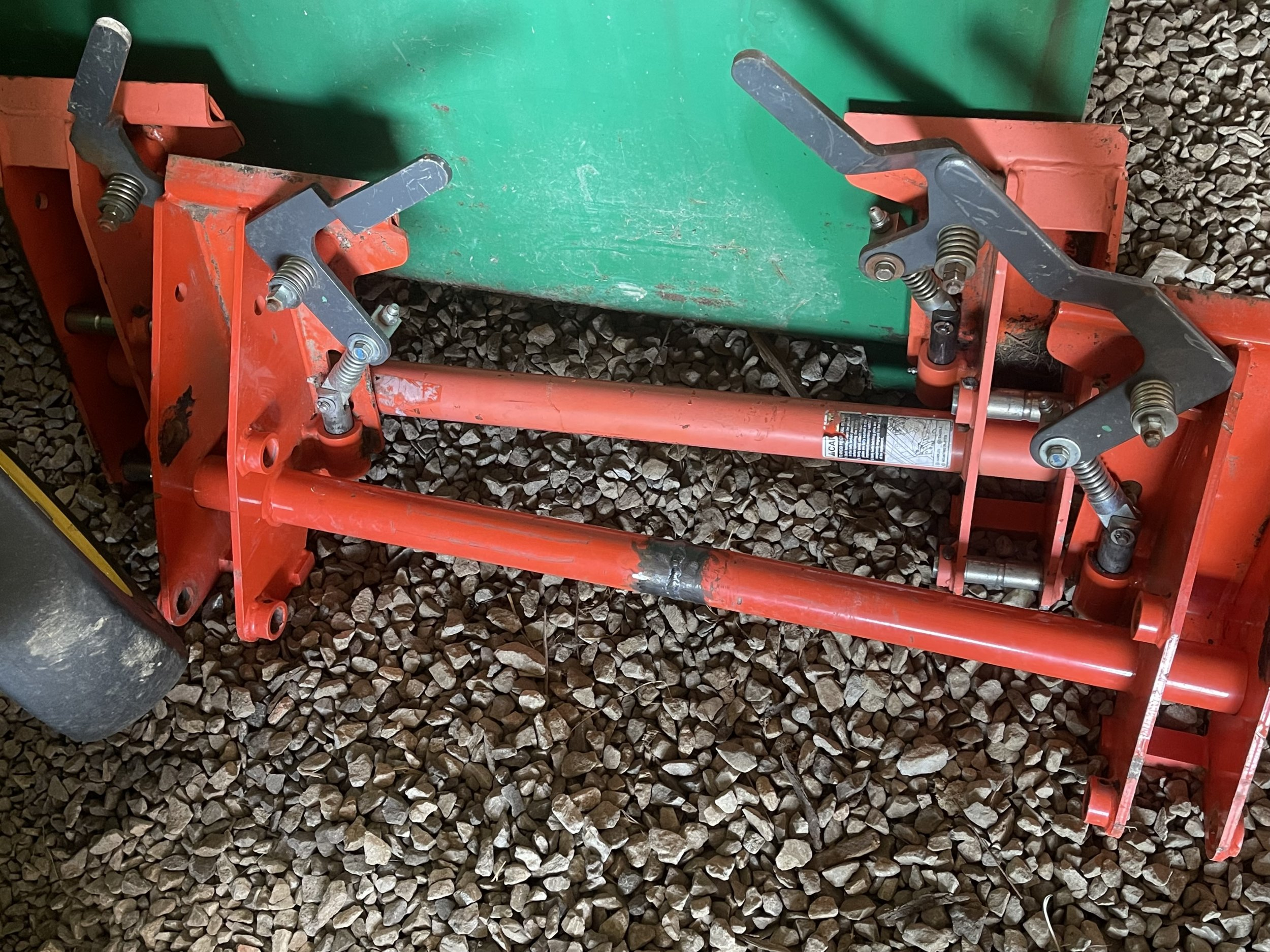

Making an adapter for my excavator to hook to skid steer attachments, like pallet forks and hay forks. Got another adapter and welded it up. I did bevel, then single pass, then went over that pass with a wide back and forth.
This is what I will be putting it on. one of these. Likely the faded one cause its new old stock. The brighter one was bent. Cut it and re-welded it.

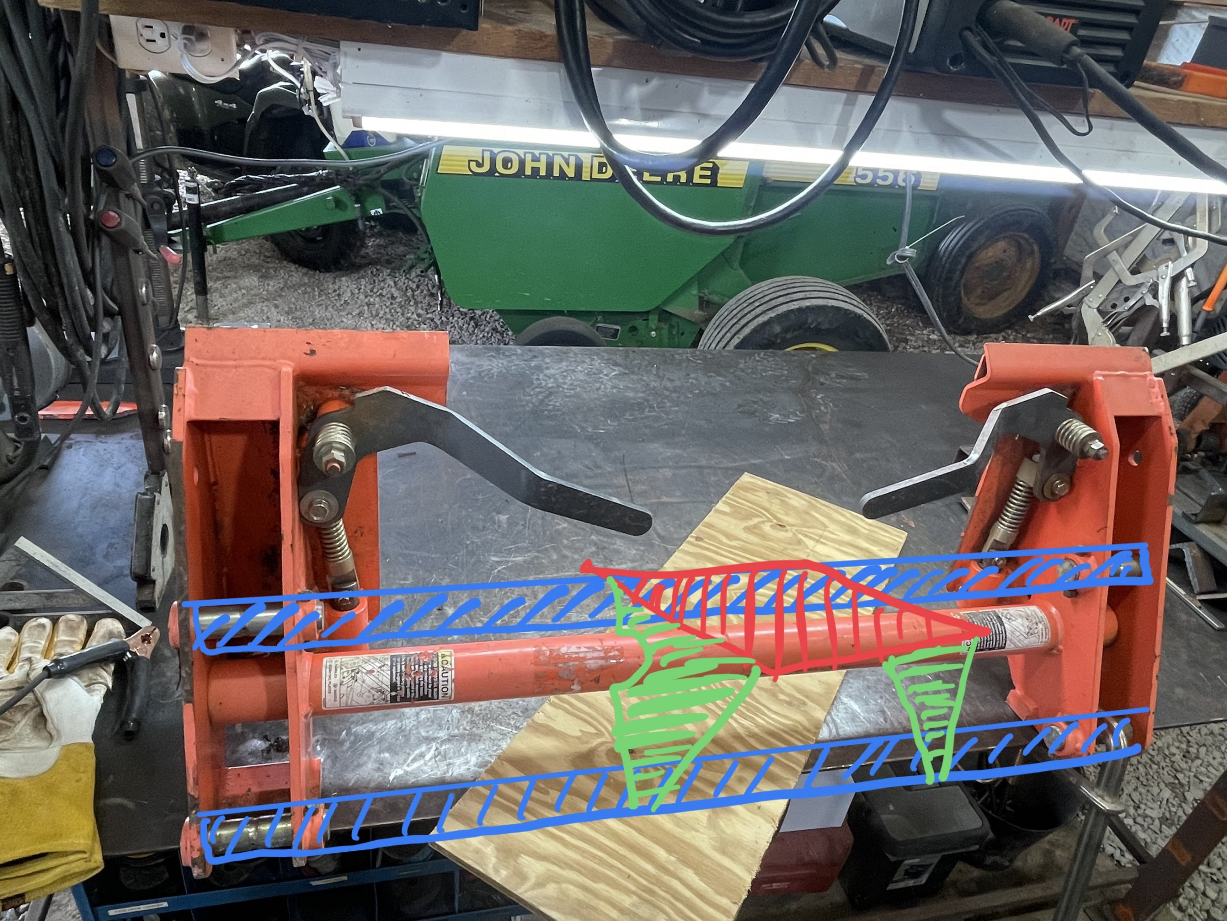

anyone want to critique my idea?
i have 2x2x1/4” tube(blue x2) that I am going to run from outer ear to outer ear where the pins are. I will cut a square out of the inner ears so square tube fits in it, flush with outside surface. The 3/4 adapter(red) will attach to top square tube. Then I will cut a gusset out of 1/2” plate(green x2) that attaches the 3/4 adapter(red) to both blue square tubes and existing factory round tube. All the steel I am adding is a36. The factory round tube is 1/4” any suggestions. Will a36 be stron enough?

I kinda doubt that 2x2” 1/4” wall is strong enough. The tractor SSQA plate didn’t need to be that strong because it was supported on both sides but the mini x mount needs to be drastically stronger because it’s only supported in the middle.

Maybe I can run a plate left to right over the 2x2 making it solid. I’ve got 1/2” plate(a36). Also have ar500 1/2 plate but do not want to waste it on this project. I will be getting some grade 60 plate soon.
Also have 1/4 and 3/8 plate.

Flat plate isn’t that strong by itself. I think I’d upgrade the tube size.
