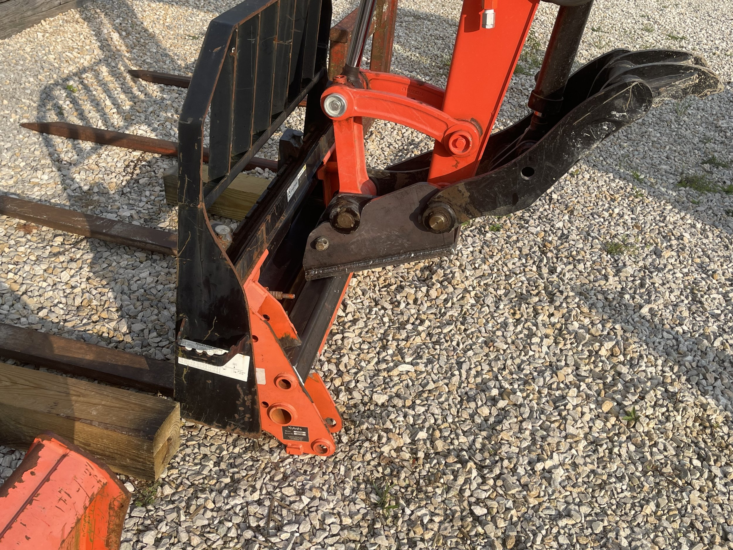

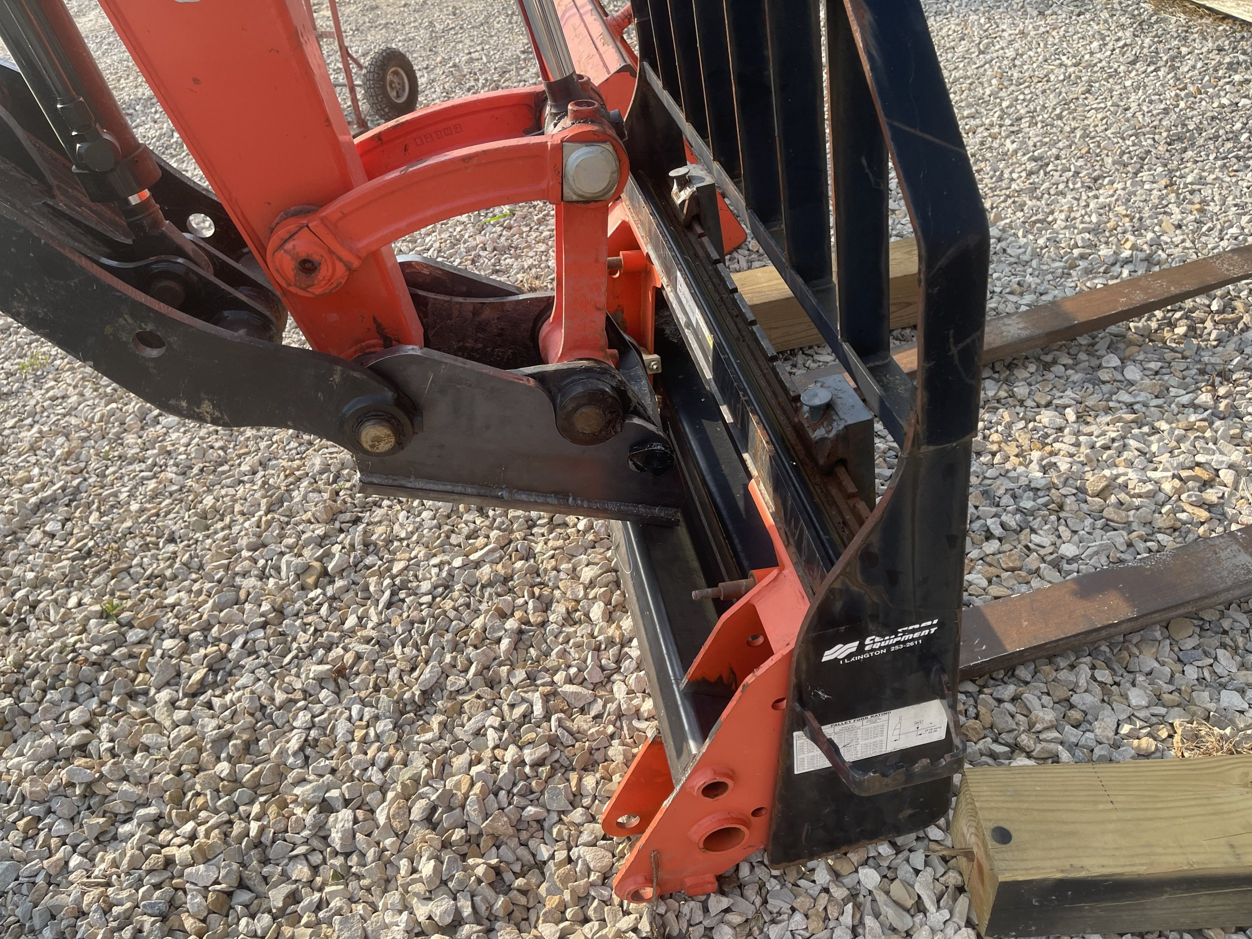

Thanks, and I do understand basically. Kinda. there is also the 2.5” x 1/4 round tube there from the factory, likely a better grade of steel than the mild steel I have.
my second ideal was to go with the square tube but add 1/2 plate to it, this pic kinda shows it. The first pic is the 2 orange ears with the blue tube, second pic shows the yellow 1/2” plate completely welded to tubes. 3rd pic is the side view. I’ve got a36 and ar500 1/2 plate. The green represents the way I see force being applied with pallet forks.
Trying to keep it as light as possible with no engineering knowledge is difficult.

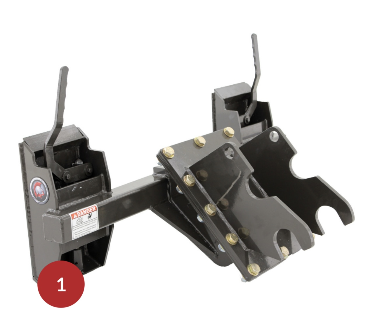

Here’s a spartan one. It looks like they only used a single tube. Would like to know what grade and what thickness. The angle they did will work great for attachment facing the excavator but will almost be useless for using facing away. You would have to extend boom out pretty far to get whatever you have attached like forks level. But doing a bolt on does give the ability to reverse it.
I saw that bracket after I was looking for images after you made the first post. One good part about that design is the tube isn’t spanning very far. It’s probably only 10” or so if even that much.
   / Will this hold or crack over time? Do more passes?
#65
I did call spartan, that tube is grade 50.

I picked up a peice of 4x3x5/16 tube. This is roughly the angle. I have 2 ideas how to further brace it From back of adapter to bottom of ssqa.
   / Will this hold or crack over time? Do more passes? #67
That's gonna be under a lot of torsional stress. That looks nothing like your earlier sketch.
And I'd never want to make something where the machine can self destruct itself. And that headache rack on them pallet forks is gonna trash your bucket cylinder if you tilt the forks back too far
#68
Lol. Just showing how it’s attaching. Still will be bar at bottom and gussets coming to rear.
   / Will this hold or crack over time? Do more passes? #69
Are you worried about the pallet fork backstop hitting the bucket cylinder?
#70
Yea, was just making sure of clearance. But that’s how it needs to be mounted and I have to build from there.
