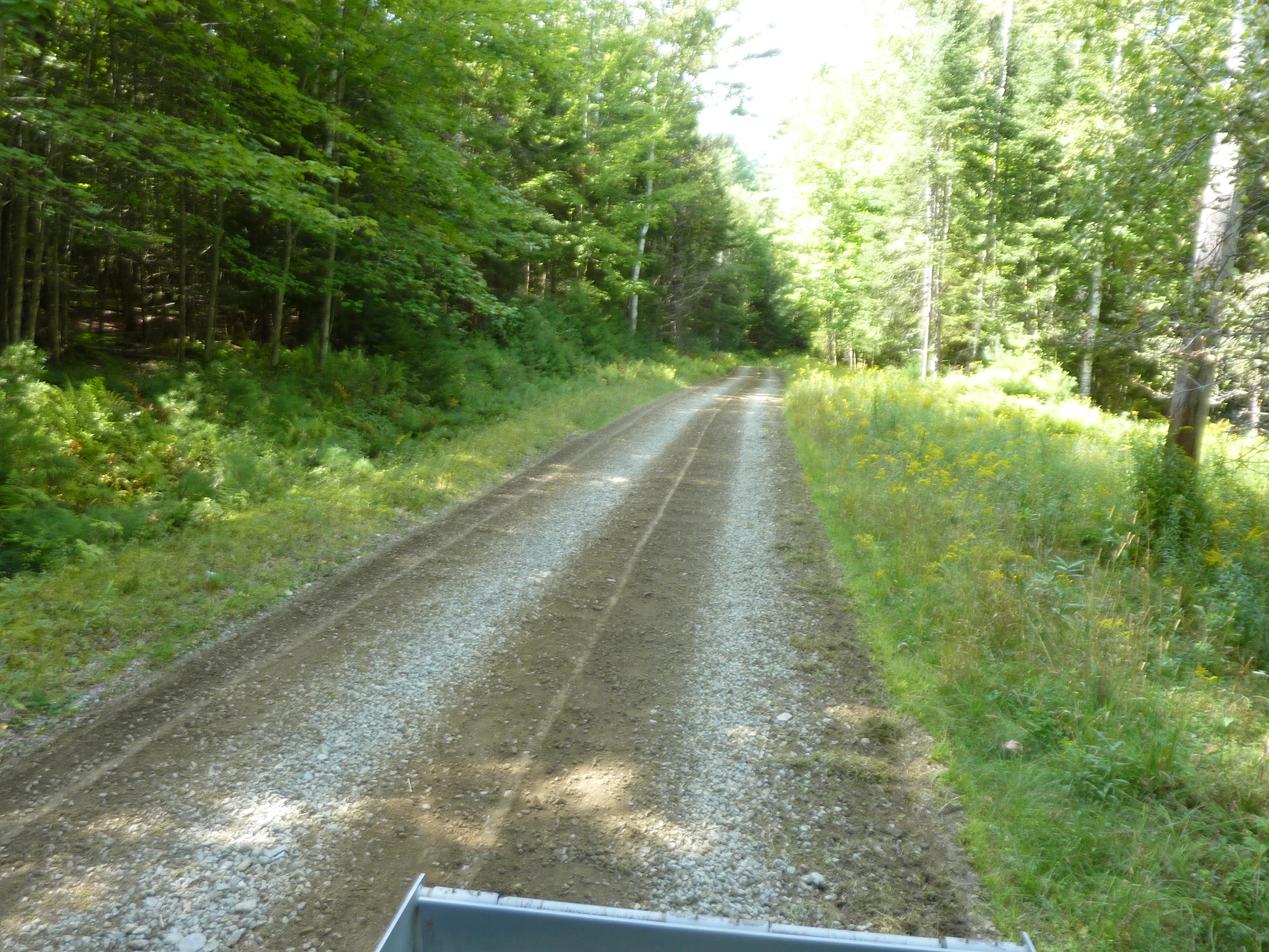

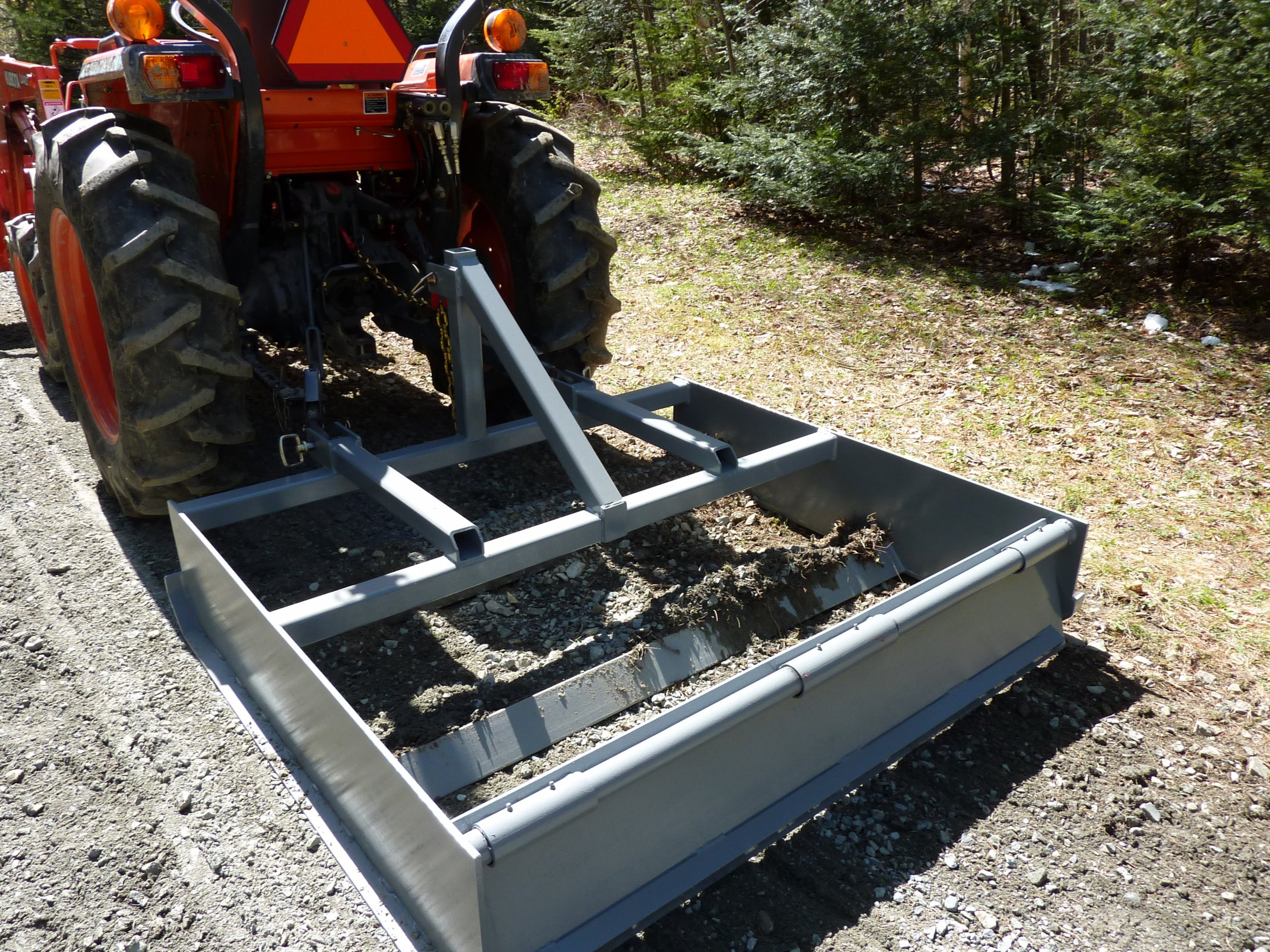

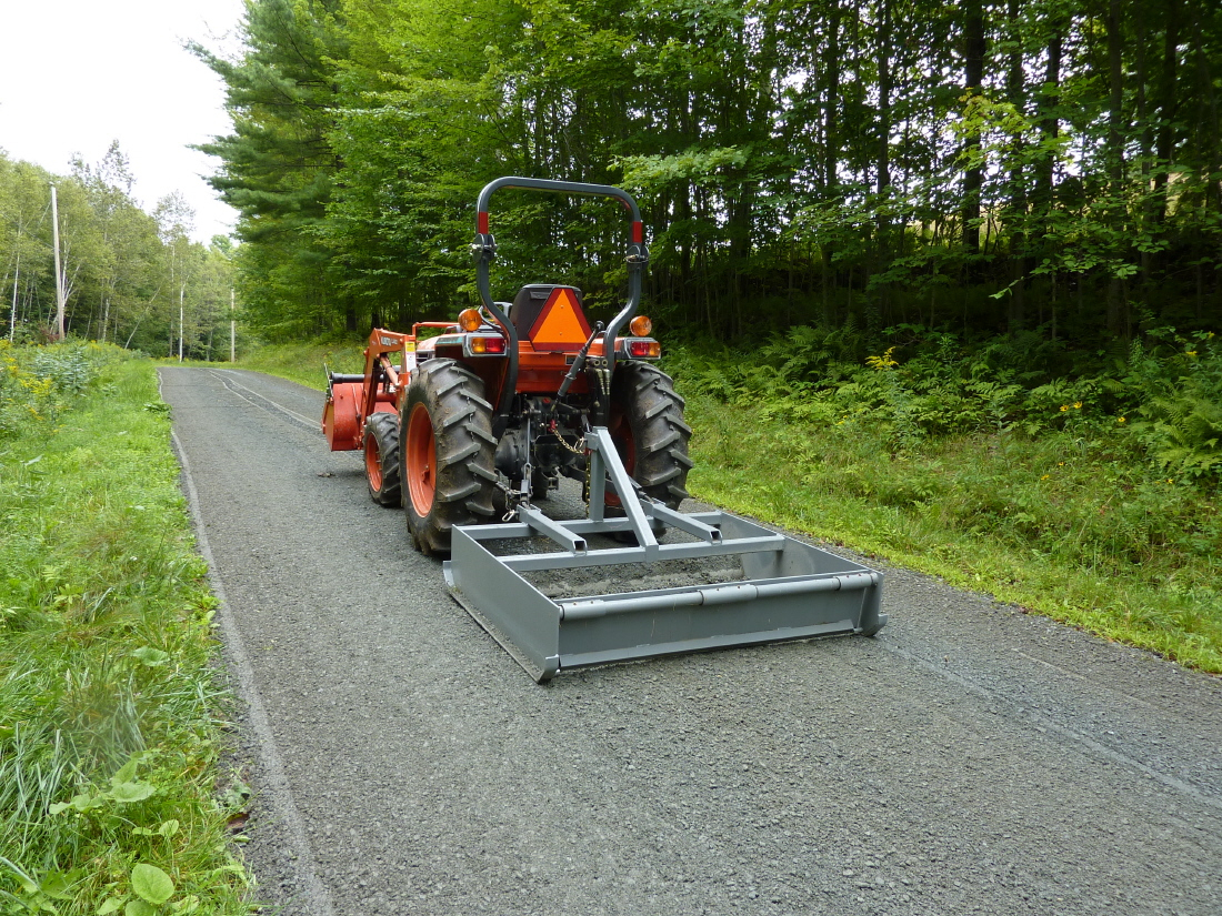

My L3010 is 5' wide and so is my land-plane (inside the box). This is what it does.. You only have to cover the tires. You don't need it wider but, I wouldn't want it narrower.
Here is one to show how close it is
gg

Thanks. I was impressed with your grader - liked the hinged back panel. Nice work.

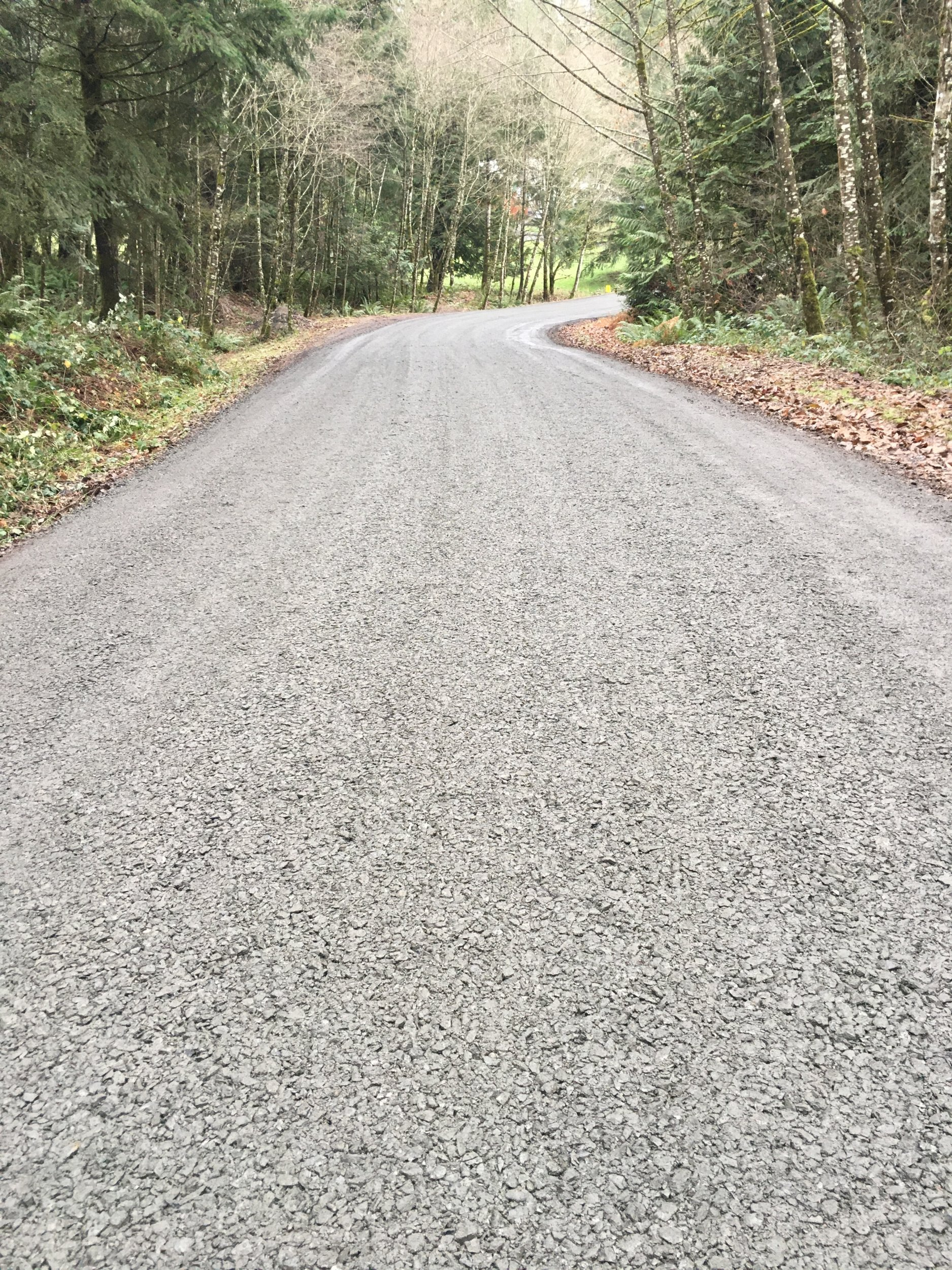

If you go with a rear blade, rather than land plane. Get extra width as you will want to angle the blade and still cover the wheel width and crown the road when width varies. Ours varies fro 20+’ down to 12’ wide
