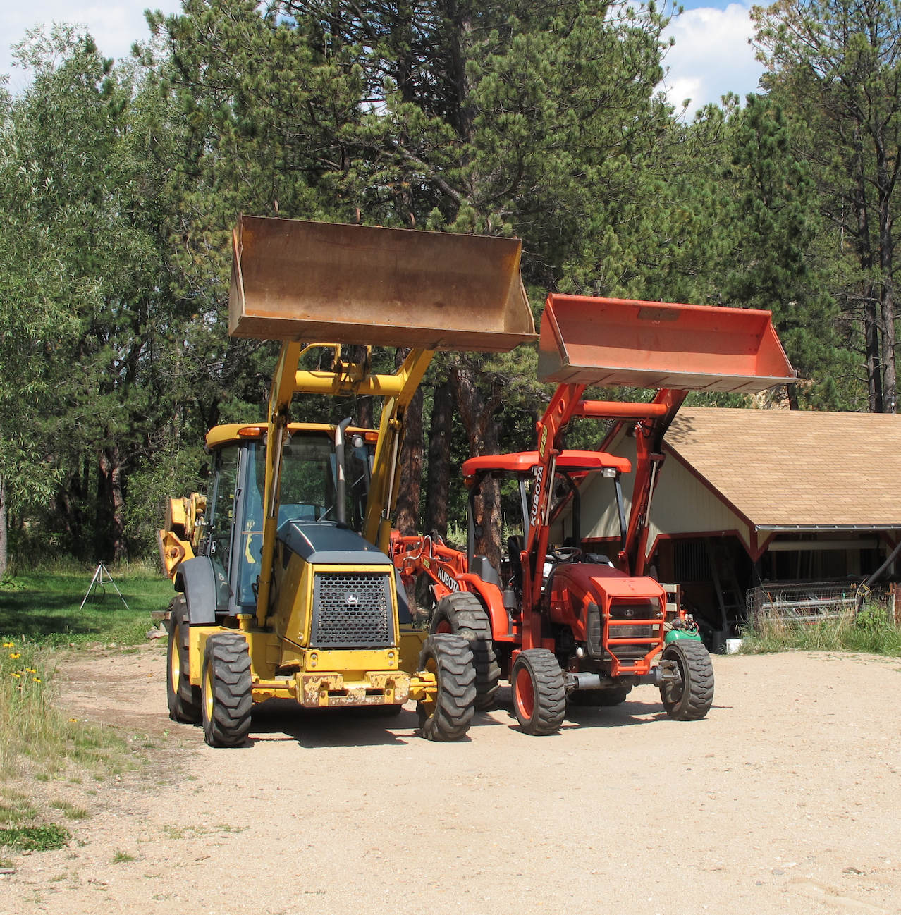

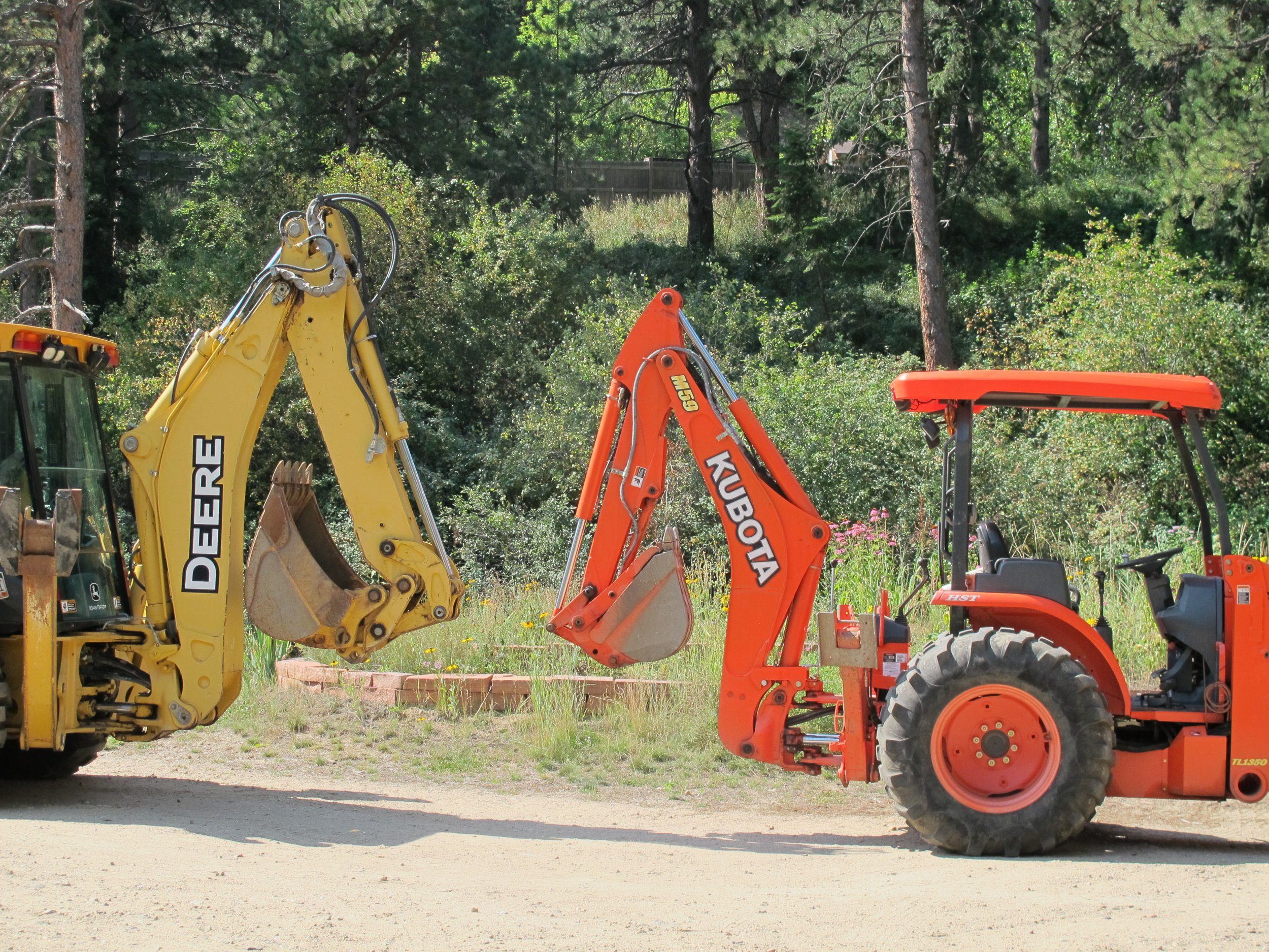

I too would like to know where the roll centers are on the M59 and have asked Kubota for that information with no response. Therefore, I am working from the position of every pound that I can place below the plane that runs thru the axels is a pound or percentage of total weight that is below the likely roll centers. I conclude the roll centers are probably above the plane that runs thru the axels based upon the significant bodies of weight ( backhoe, engine, front end loader frame ) are mostly above the plane of the axels. Since you have a M59, you know what kind of weights are involved. I consider moving 5% of weight below the axles to be a significant improvement in reducing the likelihood of roll over.
I have some idea of where the for-aft roll center is since I experienced a light rear end when grapple is maximally loaded. That is why loading the rear tires was a significant improvement in for-aft stability.
M59 travel speed is less than 5 mph when loaded and frequently 2-3 mph when really loaded so impacts are very low speed and there is little lost displacement. Kind of like gently squeezing a balloon. The tire carcass, when rolling slowly over a rock, bulges slightly at the point of contact and there appears to be very little internal pressure increase. However, I will afix a pressure guage to the tire stem and try a low roll over several different size rocks next time I am running the machine. Will be interested in learning the outcome.
Interesting. Let us know if the pressure spikes.
It occurs to me that although the center of mass of the liquid is very slightly below the center of the axle (because of partial fill), I'd be surprised if any normal fluid fill moves the CG of the fluid down very far - maybe not even as far as the bottom of that axle. My guess is still that fluid fill doesn't move overall CG very far either, and as far as the CG of the fluid itself goes, I wonder if that fluid CG might still be within the axle diameter. Not sure it matters, but at least that fluid CG calc is one we don't need Kubota for.
Do you you agree that the critical calculation for side tipping is the change in distance from the ground up to the CG? It also seems to me that as you say, most of that mass is above the axle - although I haven't gotten out there and really taken a look at it. Hmm.... not sure of the significance of the axle here. How did we get on to that in the first place? The axle is a convenient point of reference for working out the center of mass of the rear end is about all it seems to me.
Now for fore & aft tipping there is no doubt that more weight aft does help. Just like putting a 3000 lb boulder in the front bucket enables lots more backhoe abuse - probably enough extra abuse to break things.
BTW. ability to withstand deliberate abuse is THE BIG DIFFERENCE between the M59 and a real commercial TLB. Counterweighting an M59 could break things, but counterweighting the JD310 probably won't.

rScotty,
Thankyou for interesting point-counterpoint instead of flaming/ ranting. The mark of a gentlemen.
I have not taken measurements of the fluid level relative to rim and thus distance to interior of carcass in contact with ground, overall tire diameter when loaded (filled), nor carcass volume but based upon ratio of bare tire weight of 280 Lbs and fluid fill weight of 589ish Lbs, where CG of the bare tire on rim is certainly within the axle's diameter and the CG of the fluid fill is clearly below the axle's diameter by roughly half the distance of the unfilled upper portion. The next calculation involves the ratio of the masses relative to their centers of mass resulting in the loaded wheel center of mass moving below the axel diameter which I believe is roughly 2 inch but no more than 3 inch.
I will agree that the critical calculation is the distance from the ground to the roll center between port and starboard of the total machine in whatever dynamic configuration it is in. The machine's two roll centers do not both have to pass thru the CG point. One affects ( changes) the roll centers by changing the CG ( Center of Mass ). The axles are important and the plane that passes thru the front and rear axles is important because the action of tipping a machine onto its side has to act the axle which then loads the rim and then the tire carcass. Tipping only occurs when the port and starboard roll center is above and out beyond the end of the axle and or the point the tires make contact with the ground. This is what happens when people balance a car on two wheels and keep is upright. Notice they are controlling the roll center by steering the front wheel in contact with the ground.
I am meticulous about machine maintenance since a well maintained machine works better, is less tiring, and lasts much longer. Cost of ownership stuff and old adage about always work with sharp tools, you are less likely to hurt yourself by forcing it. It gets fed frequently with only molybdenum disulfide grease. My more used tractor tool is in pic.
I agree a JD310 and commercial backhoes in general are less likely to break when deliberately abused but they are also heavier and have higher working pressures so I could also be convinced they break at the same frequency as lesser machines given they are both worked to the same degree within or beyond their capacity.
I also know someone who bought a brand new 410, used it hard in gritty liquid environment, never greased any part of the machine including the swing frame main pin, and trashed a perfectly good machine in 6 months and it went for almost scrap price.
I will post back here when I am able to run the pressure test. Don't expect an answer on this until late July or early Aug.
