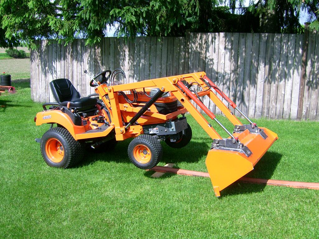

/ Why No Quick Attach Bucket on BX's? #17
Here is my homemade FEL with QA.
Click link below for more pics.
/ Why No Quick Attach Bucket on BX's? #18
Scarlo, I like your setup but the big difference between your setup (similar to JD's setup) is that there are two rams for curling the bucket. Because the BX series has only the one center mount HD cylinder, there is no way around a fairly beefy adapter plate.
I like the setup from AI2, but I think I am going to add change my curling setup to match yours (with two cylinders for the curl)
For someone who is not ready for such major changes to their machine, the AI2 setup seems a no brainer .....

I would think that by extending the bucket out that extra 6" would drastically cut down on the lift capacity. The lift capacity is only 500lbs and I would imagine almost everybody with a BX has easily maxed that out, but it is a good looking system. I like the first quickattach better, much cleaner setup, but much more work. It would be perfect if it was built to the specs of a mini skid steer then all sorts of attachments would be readily available.
/ Why No Quick Attach Bucket on BX's? #20
I think the mini skid steer quick attach is the way to go. Look at the Toro Dingo and other walk behind skid steers. They have three cylindars and still have around 1000lb lifting capacity. The strength in the quick hitch can be done without adding lots of weight. Whenever I get the time and if possible a cheap mini skid steer attachment, I'm going to try to work this out. Hopefully it will come together.
