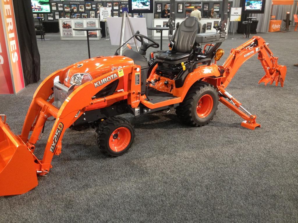

Well this thread was revived by spam... but it got me thinking on the topic.
FYI there will be a factory BX quick attach. It has been mentioned in the literature for the new BX25D. It doesnt appear to add much weight or offset either.
Something for those looking for a BX QA (like myself) to consider.
Anyone know when this will be available, I would really like to have that snow plow.
