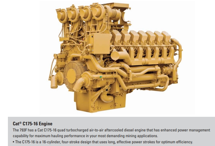

The Cat 793 haul trucks at the mines I worked at had V16 engines with 4 giant turbos on top:
The Cat 797F haul truck uses a V-20 engine!

Rob, they'd be huge I-6's if that made any sense, but you can only go so large on cylinder bore size before the thermodynamics get really wonky and you end up inefficient and stuck at very low engine speeds for operation (container ship diesels run at 100rpm rated power, for example). So above the 15-20L displacement range, you go back to V12s and above for anything that drives itself. Typically, anyway.

Looks like it’s the C27 engine that’s a V12.
It's a V-16, 8 cylinders on each side. Front one is almost hidden by thr box on the front corner.
