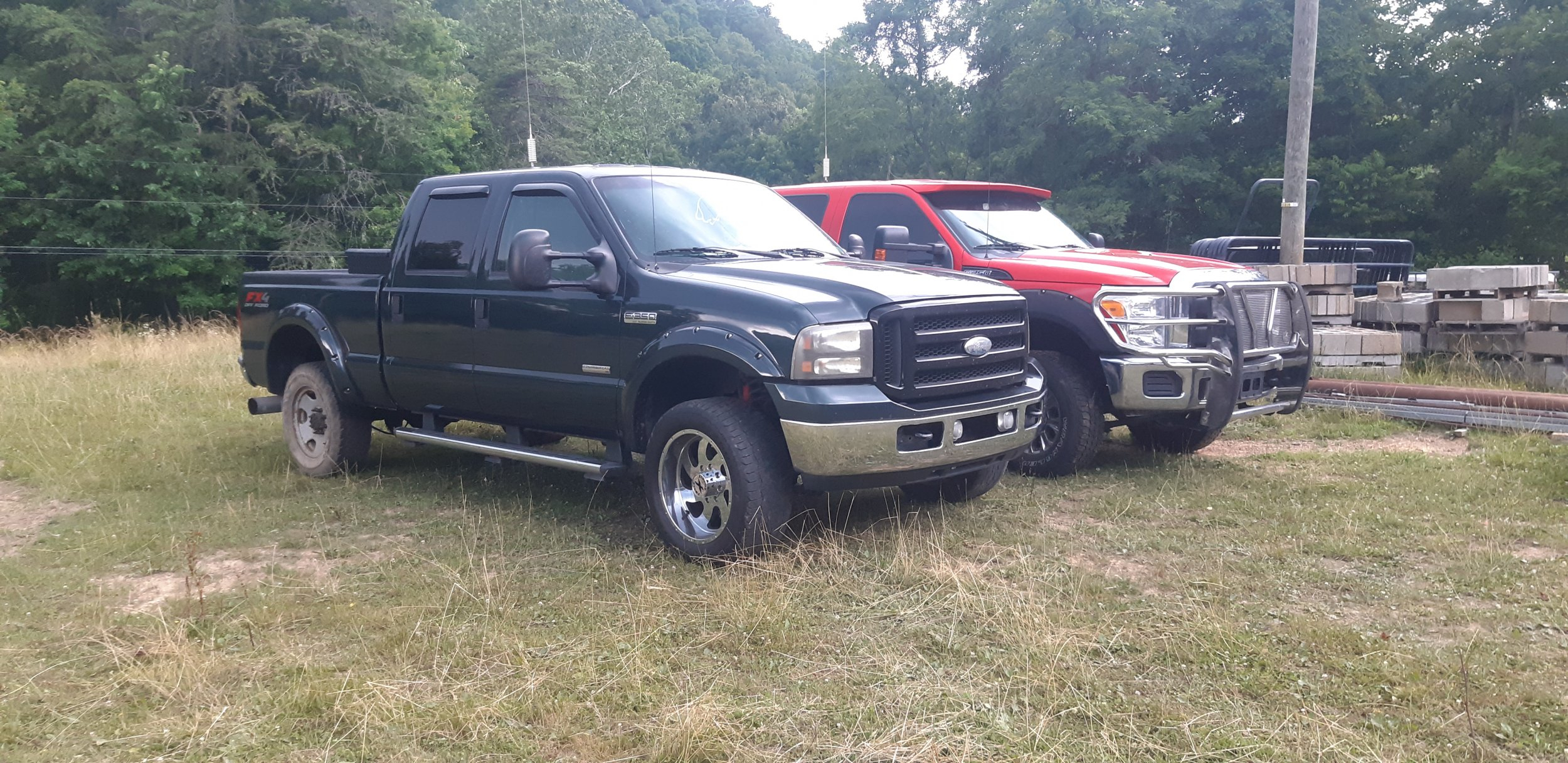

Excellent explanation of the gas vs diesel power outputs.
I'm a fan of diesel, but not opposed to bettering gas motors and fully believe that a turbo version of the 6.2L gas V8 would be an excellent option for the superduty platform. A EcoBoost big brother, if you will. Anything to up the torque, and lessen the downshifts at highway speeds that yield insane rpms... that was what turned me off to my 6.2L gasser. Still have it, wife drives it. I prefer my 6.0L diesel with manual trans. We will keep the 6.2L so she can comfortably hook up the GN horse trailer, load horses and kids, and go riding. Myself, I'll have my 6.0L ready to go if I'm driving or hauling heavy, it gets better fuel mileage towing than the 6.2L does empty, and 16-17mpg empty in mixed driving.
