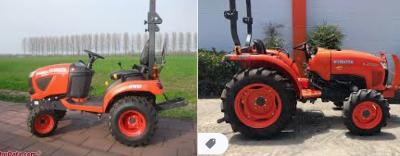

Weight matters. So does having a taller diameter tire. The two usually go hand in hand. Consider a tug of war between a
Kubota BX 2680 - 24.8hp - 1521 lbs - 26x12x12 R4 rear
Kubota L2501
- 24.8hp - 2601 lbs - 15 -19.5 x(40) rear
Anybody wanna guess which one would win? I really like larger diameter tires. Size matters :sneaky:
A larger tire footprint would have more weight bearing capacity per given tire pressure. Larger diameter (or width) would provide that. (Tracks, even more.) Footprint size has no relationship to tractive force. It does allow flotation though so you don't sink out of site while trying to get that weight to the ground. If a comparison were done on hard surfaces, then diameter differences would have little effect.
Think of something like train wheels - very high weight, very high tractive force pulling a long train, relatively tiny footprint on very skinny but extremly hard tracks.

I'm not sure I can explain the physics of a taller tire. I can only say that I grew up on a farm and the tractors with small diameter tires were always spinny. I think it is more than ground footprint, but also the geometry/leverage of a taller diameter. Those old John Deere B's didn't have much power, but they had a ton of traction with those tall rear wheels.
   / Why is Weight The Only Solution Being Offered To The Problem Of Traction? #40
All about leverage. A taller tire is like a taller gear. Ie 4.10 verses 2.55.
