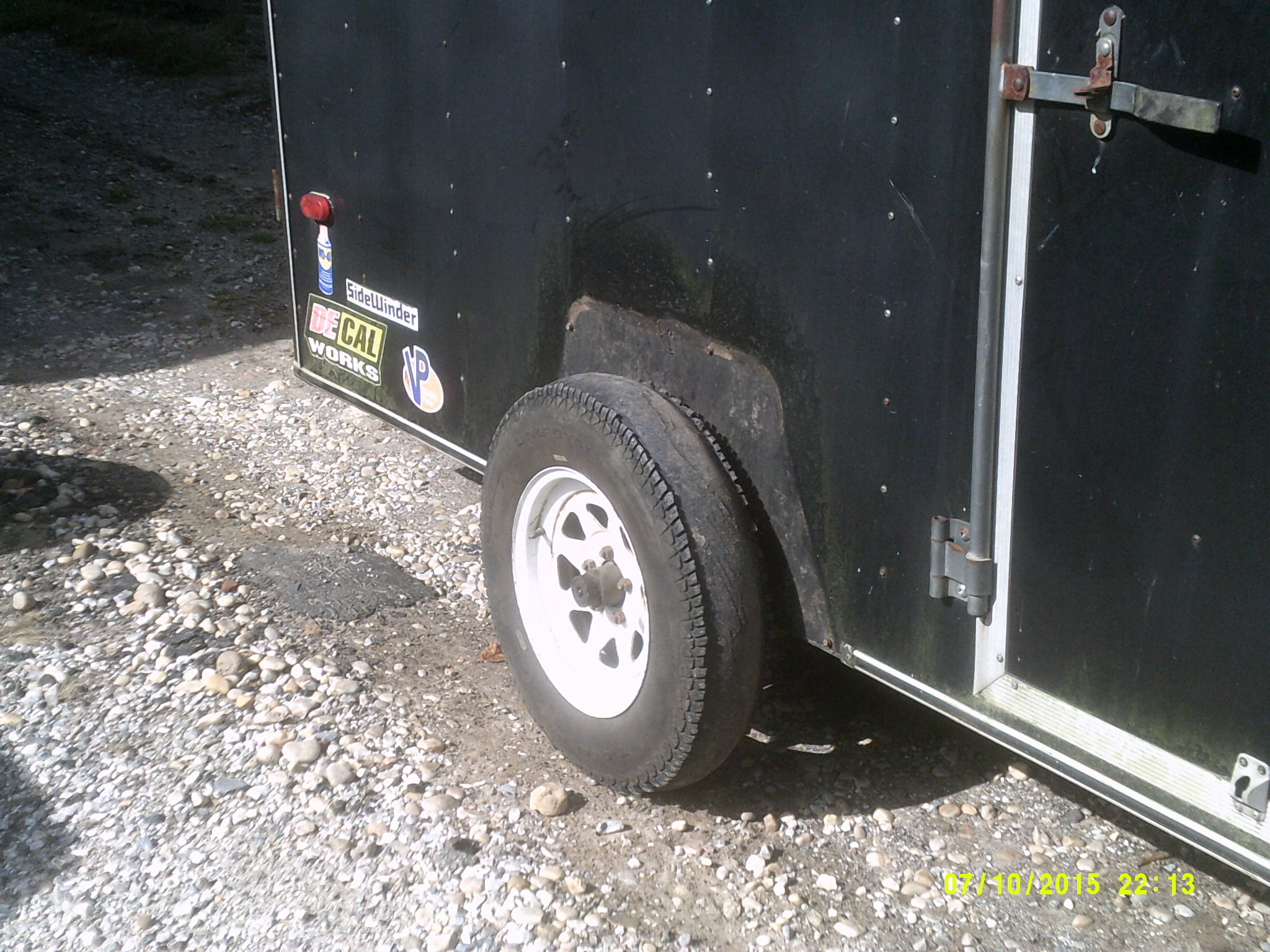

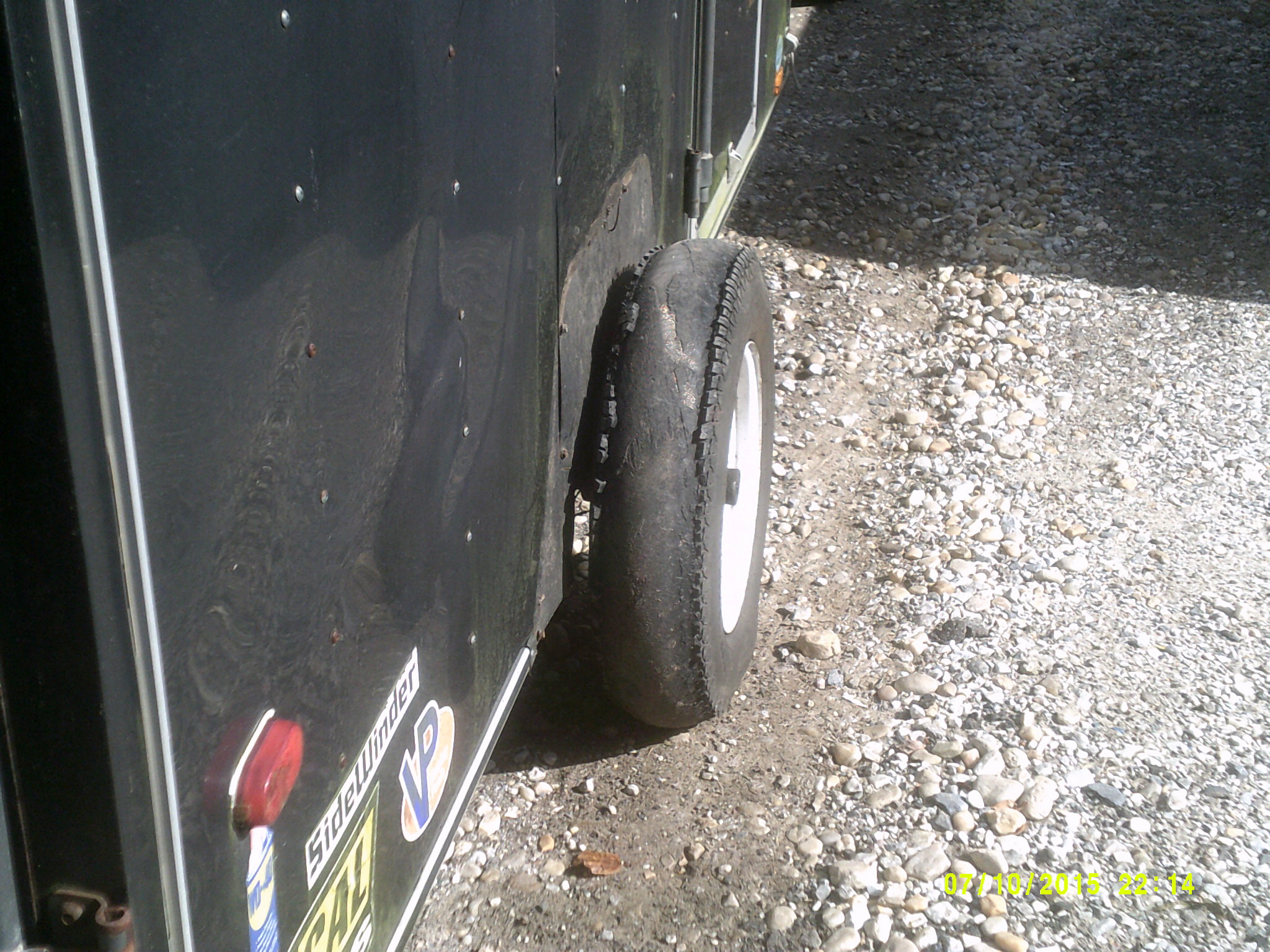

I was out today striping a parking lot about 20 miles from home . On the return trip I heard a noise and I looked in my passanger side mirror . I watched my fender fly off and the tread from my tire go all over . The one thing I didnt hear was the flop ,flop of a flat tire . I am DONE with these chinese trailer tires . Going all LT truck tires . Overloaded ? Not even close . Wrong pressure , nope tire still had 35 psi in it when I got home . Old tire , it was 3 years old . I The only good thing is it made it 5 miles riding on the casing
35 psi is the wrong pressure. I know of no ST tire 14" and above rated for anything less than 50 psi. Do some reading on running a ST tire just 10% below max pressure.
Chris
/ Why I hate ST trailer tires #4
Chris
Are you saying 10% of 50psi means there is a hazard at 45 psi? If so, should they be rated for road use?
/ Why I hate ST trailer tires #5
The tire volume increased when the tread blew off. The pressure was possibly higher seconds before the tread blew off.

The tire volume did not change significantly when the tread failed, the belts that hold the air envelope are in the casing.
This same thing happened to my wife two weeks ago with our trailer, I think it was a combination of tire quality and dry-rot, although they looked OK before she left and was correctly inflated.
As to inflation pressure, a Michelin guy told me 20 years ago the "rule of thumb" is that anything less than 75% of the "MAX COLD" inflation pressure is UNSAFE!

Tire primer... Lessons learned and advice from respected tire experts.
1. ST tires... If you cannot WEAR OUT the tread in 3 years, do not buy radials. Buy bias ply. Don't laugh, some can wear a trailer tire out in less than 3 years. I cannot.
2. Inflation... Inflate to nameplate PSI. 50-80 PSI may seem exaggerated. Don't think, inflate to MAX COLD, but only when COLD! Do not deviate.
3. Always check tire pressure before you travel, if low, see number 2 above. Life will be better if you do.
4. Number 1 failure of trailer tires is UNDER-INFLATION. Under inflation makes more friction. More friction makes heat. More heat makes tires shuck tread and blow out.
5. Every time you stop, feel each tire. If one is warmer than the others, investigate... There is a problem. Probably low PSI.
6. Check hubs too when you check tires. If one hub is warmer than the others, make a note to check or repack bearings before next trip. This prevents sudden bearing failure.
The ST radial vs bias ply debate. Trailers are not automobiles. They do not get used daily (most cases) like autos. Moisture from humidity seeps into tires. Infrequent use dosen't get tires hot enough to drive moisture out. Moisture breaks down the steel belts. When the belts separate, off goes the tread taking whatever is in its path with it (ie, fender).
The only thing worse than ST trailer radials for infrequent use trailers are used P and LT radials. Guaranteed to need at least two spares to go any distance. Not to mention the aggravation of swapping tires and finding your fender. Using new LT tires may or may not be any better. The same can happen to them. Do not assume just because they are P or LT that they are "better" than ST. It is the way trailers are used and maintained more so than the tires. 3-5 years is the longest a radial will last on a trailer loaded near or to tire nameplate rating.
Bias ply trailer tires do not have steel belts. They generally do not separate tread. They usually last at least 10 years. Early warning on a bias ply is when they start slow leaking or otherwise form nasty cracking on sidewalls and tread. Bias ply tires are more tolerant to overloading if inflated to nameplate PSI vs ST radials. Key is PROPER INFLATION.

Max pressure on the side of the tire is 40 psi . Checked it when I got back , still had 35 psi .
35 PSI hot or cold?
35 PSI (COLD) is 13% low of 40 PSI rated. If it's only rated 40 PSI I'd guess its a load range C (6 ply) tire. Ie: light duty.
If it was 35 PSI (Warm or Hot) you are seriously under inflated and subject to failure. Rated PSI (Cold) is when the tire is at ambient temperature in the shade. Doesn't matter if its 0* or 105*. It's a baseline. +5 psi is not a bad idea, if in doubt. -5 psi is. Recommended is (Cold) rated PSI exact for happy trailer tires.
Check your tires before each pull. When the temps drop, air gets denser. Your tire PSI will drop in fall and winter. You'd be surprised, but each tire can drop +10 PSI from 100* to 40*... Then BOOOOM! or SLAAAAP! SLAAAAP! Under inflated due to nature.
