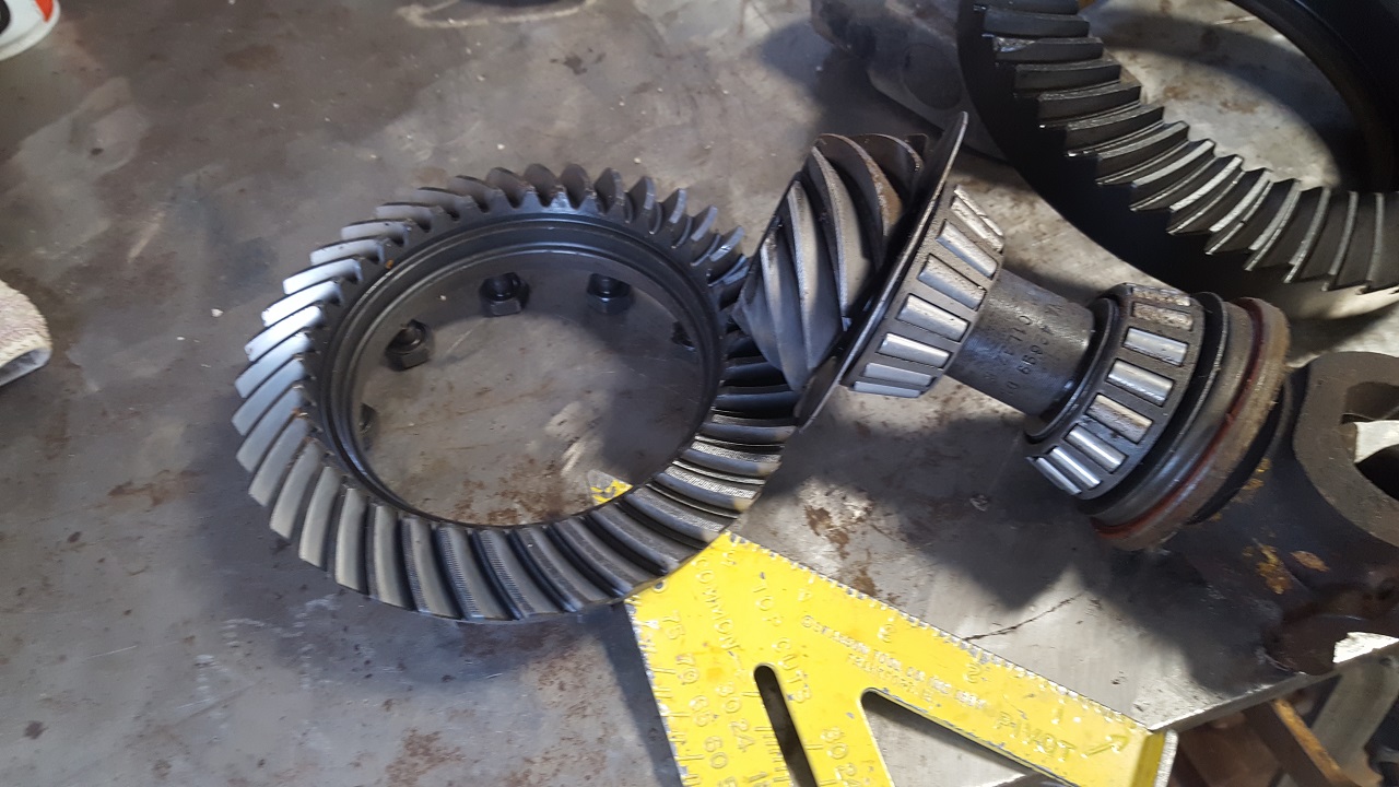

I dug around in my shop and could only come up with two ring/pinion sets. Sorry. This would have been a great thread to display 3 or 4 different sizes.
First is from a Dana 44 differential. It's a common size in 1/2T equipment and actually some autos. This set is 4.56 ratio. The larger the number, the slower the gear ratio. The larger the number, the smaller (less teeth) the pinion gear has and more teeth the ring gear has.
This set failed. They came out of one of my offroad buggies. I'll let you guys see if you can spot the failure.
I laid the T square in the pic to give an idea of size.

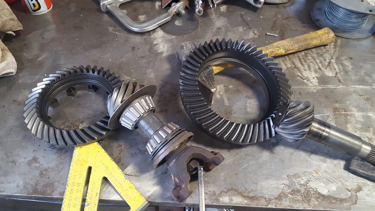

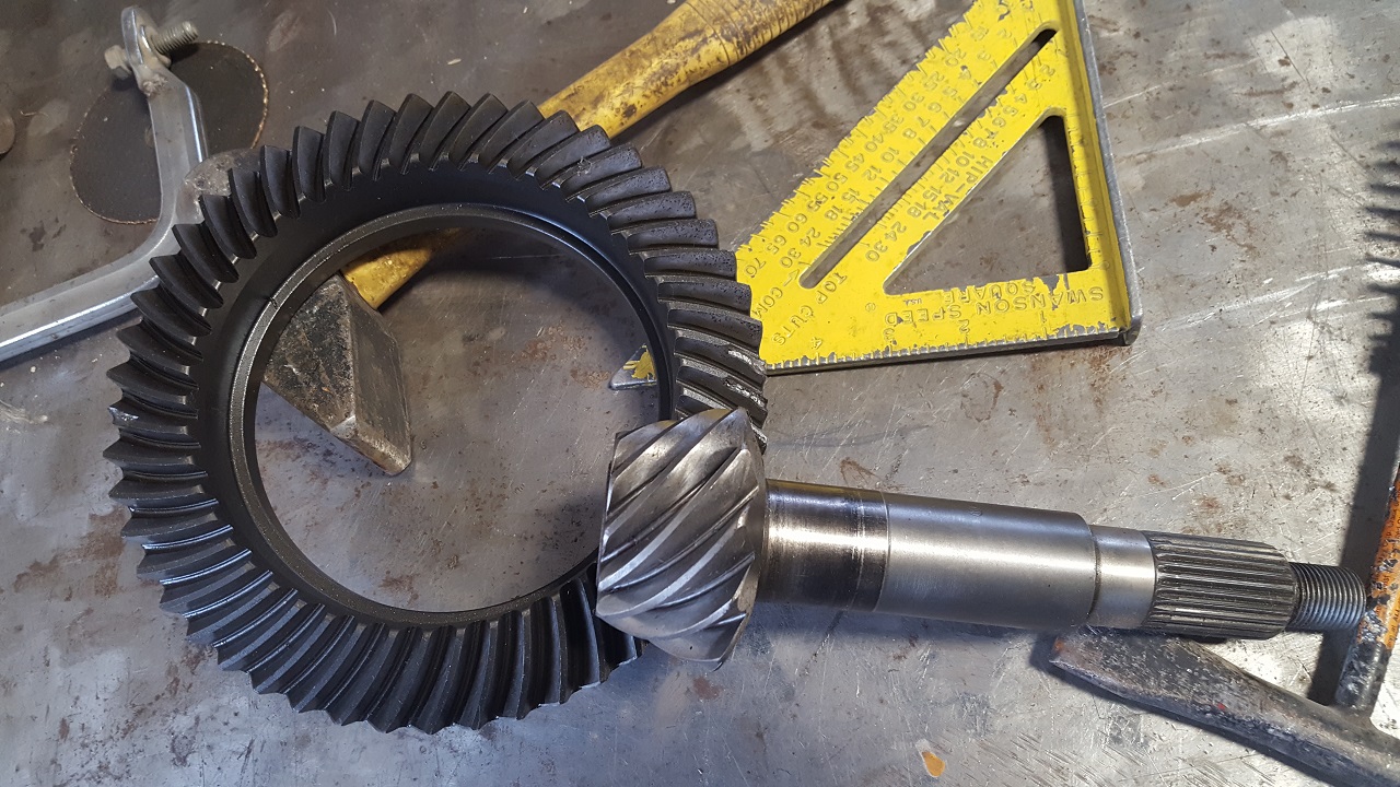

Second is a Dana 30 set. It's commonly found in the front axle of Jeeps and other compact trucks. This set is 3.55 ratio. Notice larger pinion count compared to ring count.
This set was replaced to get a lower ratio, slower vehicle speed, more pulling power.
Here's a comparable pic with both sets. Notice how much larger the 44 is over the 30.
My Son's run Dana 60 axles. Their ring/pinions sets are gigantic compared to these sets. Dana 60 size is what's common in 3/4T or 1T trucks.
Over the road trucks have ring/pinion sets that would make these look tiny.
Hope this helps explain the differences in strength that larger axles have. Wish I had gears from one of the vehicles you listed to show how tiny they are. :)
I see busted teeth all over that ring. Right above the pinion gear and then one directly across from it.

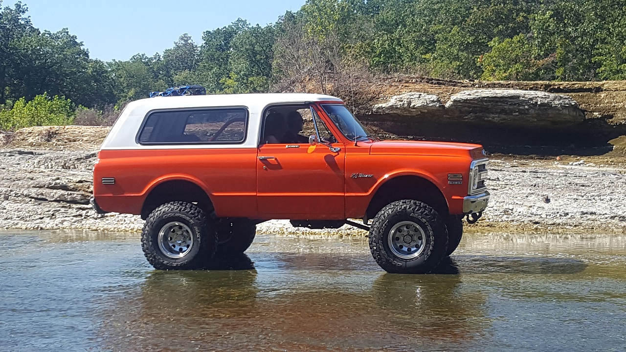

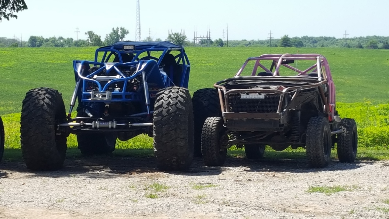

In my modified world here's an example of tire diameter differences. The more stress applied to the differential, the bigger and stronger the differential needs to be.
The larger buggy is on 48" tires and Dana 60 axles. The smaller is on 33" tires and Dana 30 front, Dana 44 rear.
And for those of us who know trucks that really shows perspective!! Esp since my k10 is sitting on 33s I know exactly how big those are!!

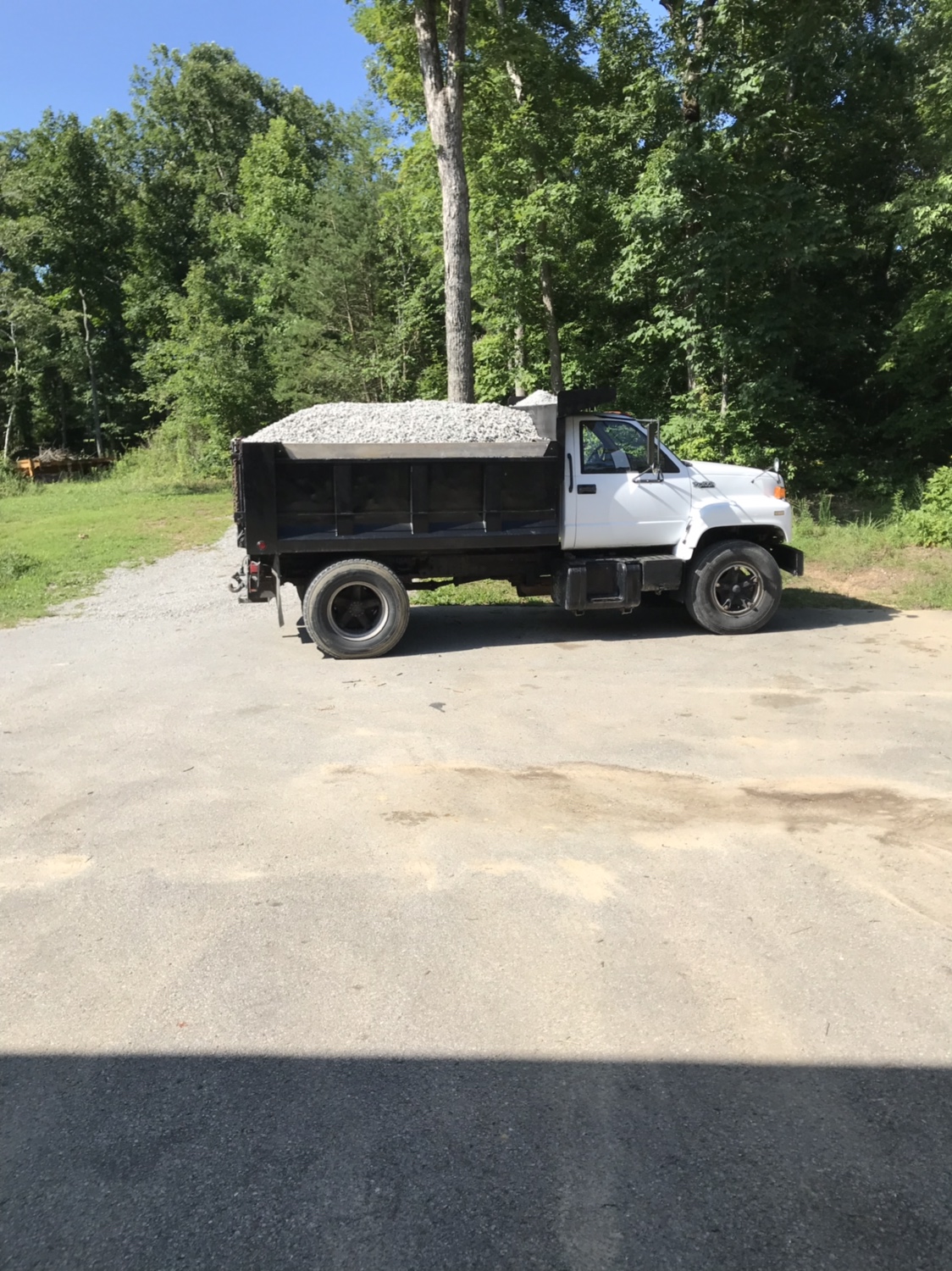

Hence the model number he kept saying of "6500" quite a bit bigger than your 1 ton 3500 pickup.
In the post I was reading and replying to, he said "my ton truck", so I didn't think he was talking about his dumptruck in that post. He didn't mention 6500, and I don't own a 1 ton 3500 pickup. ;)
/ Why huge differentials on trucks? #52
I’d already used the 4low gears in a previous calculation but my ton truck is 2wd. The 10mph in first gear is achieved in my ton truck using only the transmission gears and stock rear end gears. My 6500 is geared even deeper. Also note the 6500 has 40” tires so the driveline has to handle a lot more torque to move the same load a pickup would. Also note a manual trans has deeper gears than an automatic. The nv4500 in my truck runs a 5.6-1 gear ratio in first where it’s automatic cousin the 4l80 runs a 2.4-1 first gear ratio. I expect you’d see the same tread if you checked other vehicles.

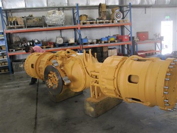

Wanna see a big differential ? Google mine haul trucks. Caterpillar factory in NC assembles them. Rear axle and diff in one housing. Shipped one diff per container or about 70,000 pounds. For a Cat 793F truck the rear axle fill is 260 gallons.
Cat | 793F Mining Truck / Haul Truck | Caterpillar
