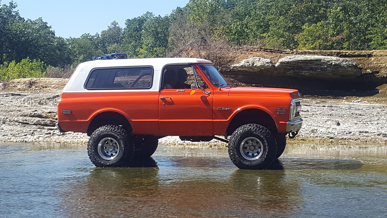

Definitely. This is the Blazer. My Son owns it now. It was freshly restored when Mike blew out the rear end. :D

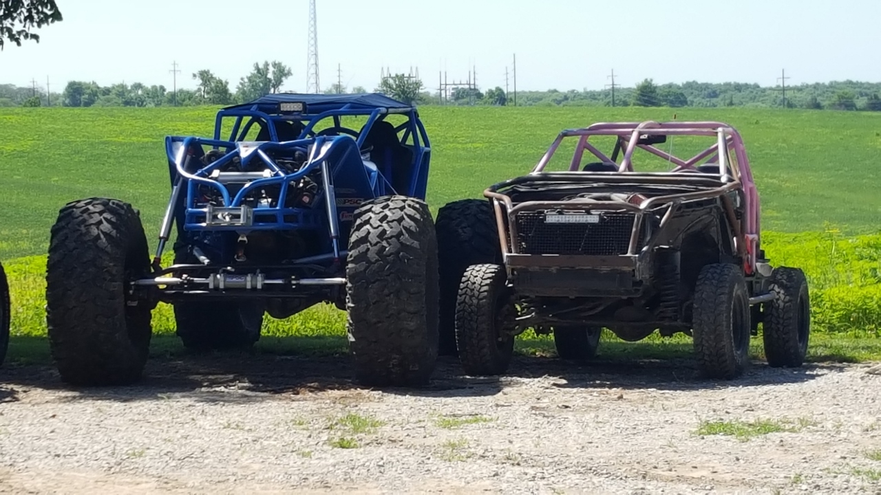

Anyone running a Miata axle in those buggies or rock climbers? I wonder why not.:confused3:
Because you don't want to hear a big loud sound when you climb up on a rock of the diffy letting go.
It'd probably more like a little "tink". :D
When you said "Blazer" I thought that you were talking about one of those little things the size of my Ranger. I didn't know that you meant a Blazer
