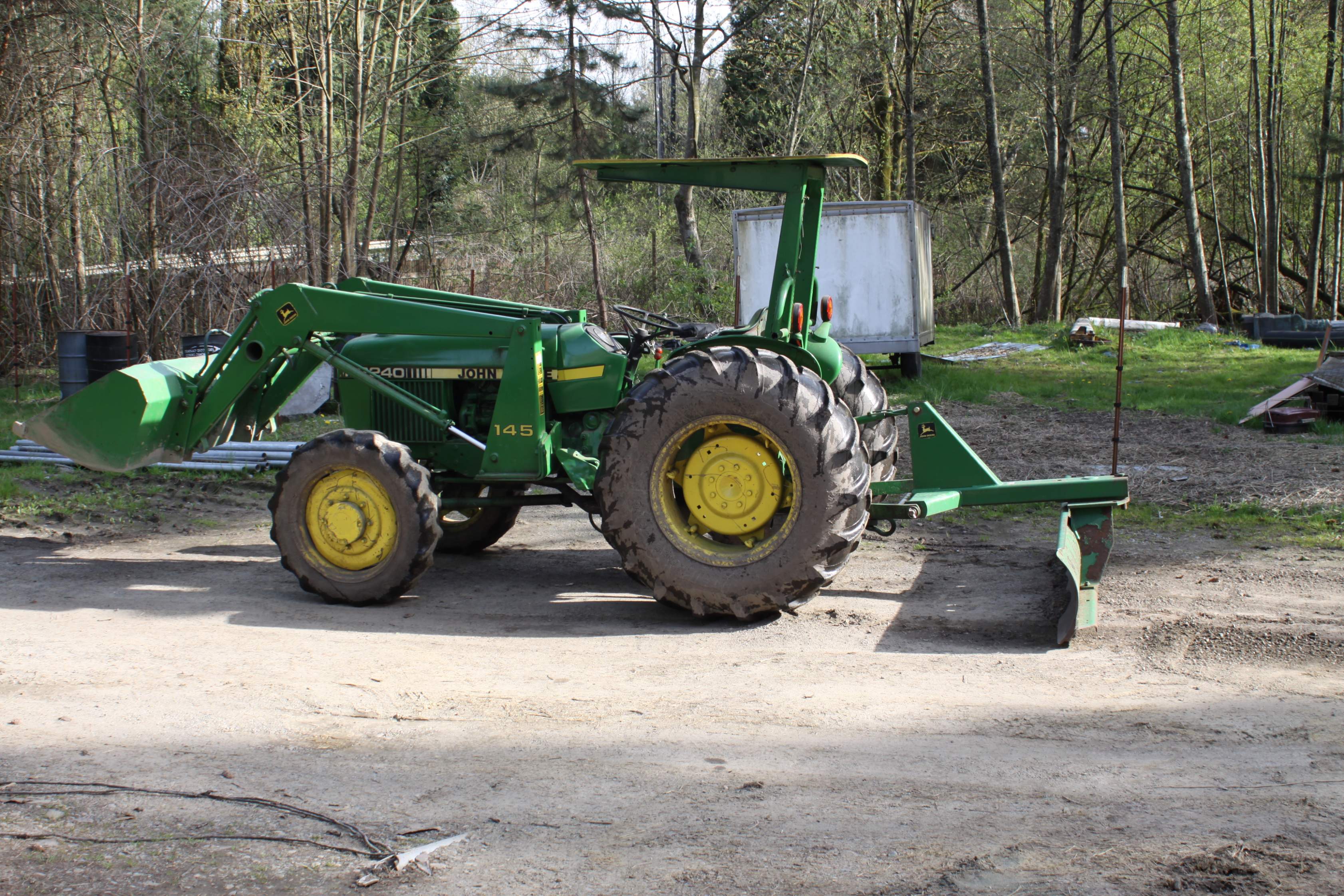

OK, got the mower swapped out for the rear blade tonight and tried some different things. The first thing I checked was the angle of the boom when I attached the RB. I had previously used it at the angle it sat when I attached it with the front support leg down. I mistakenly assumed that it sat level when unattached. The first picture shows that it actually sits tipped quite forward. I tipped the RB back and tried grading with it. It performed much better and actually would get a full blade of material.

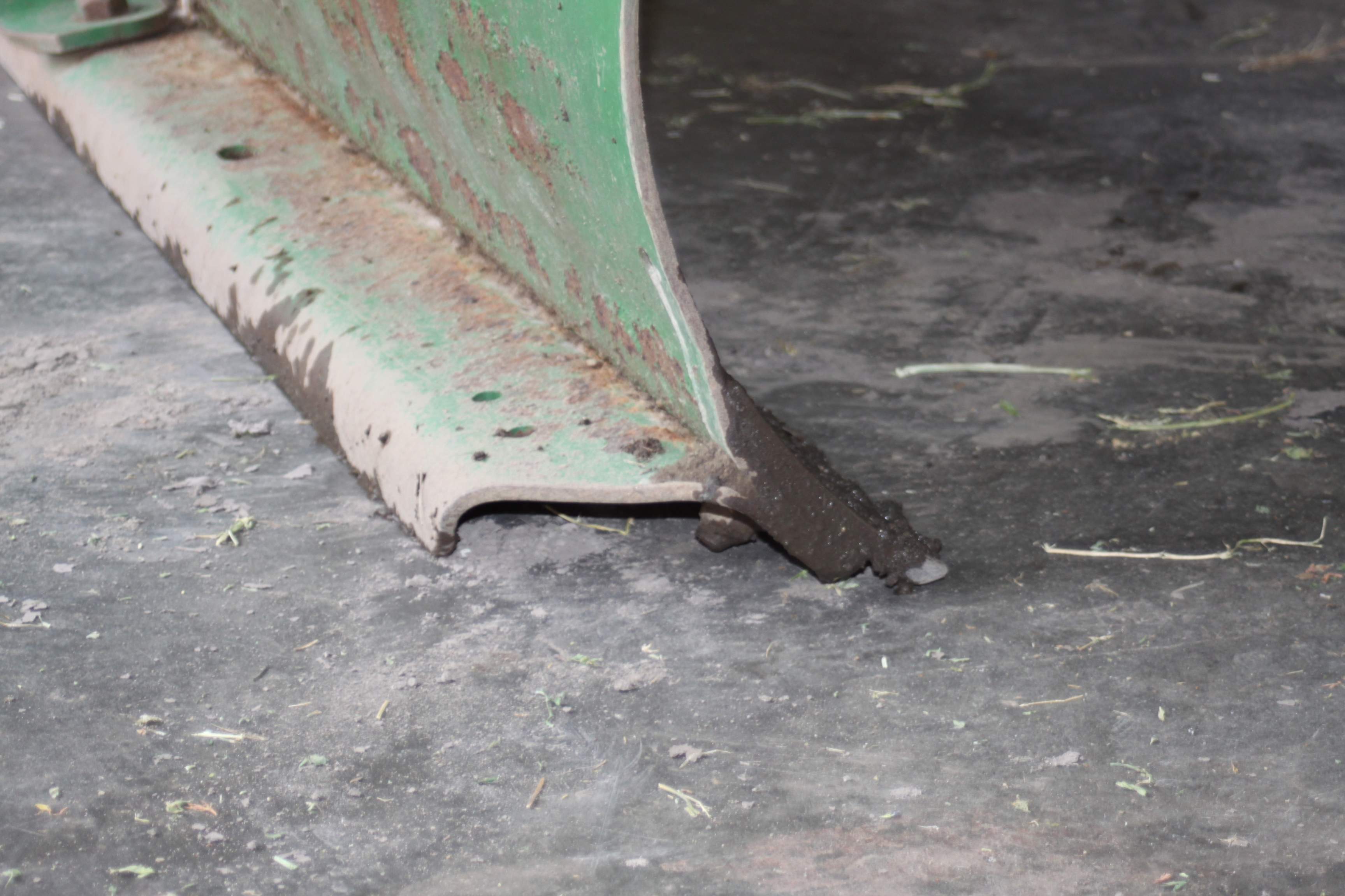

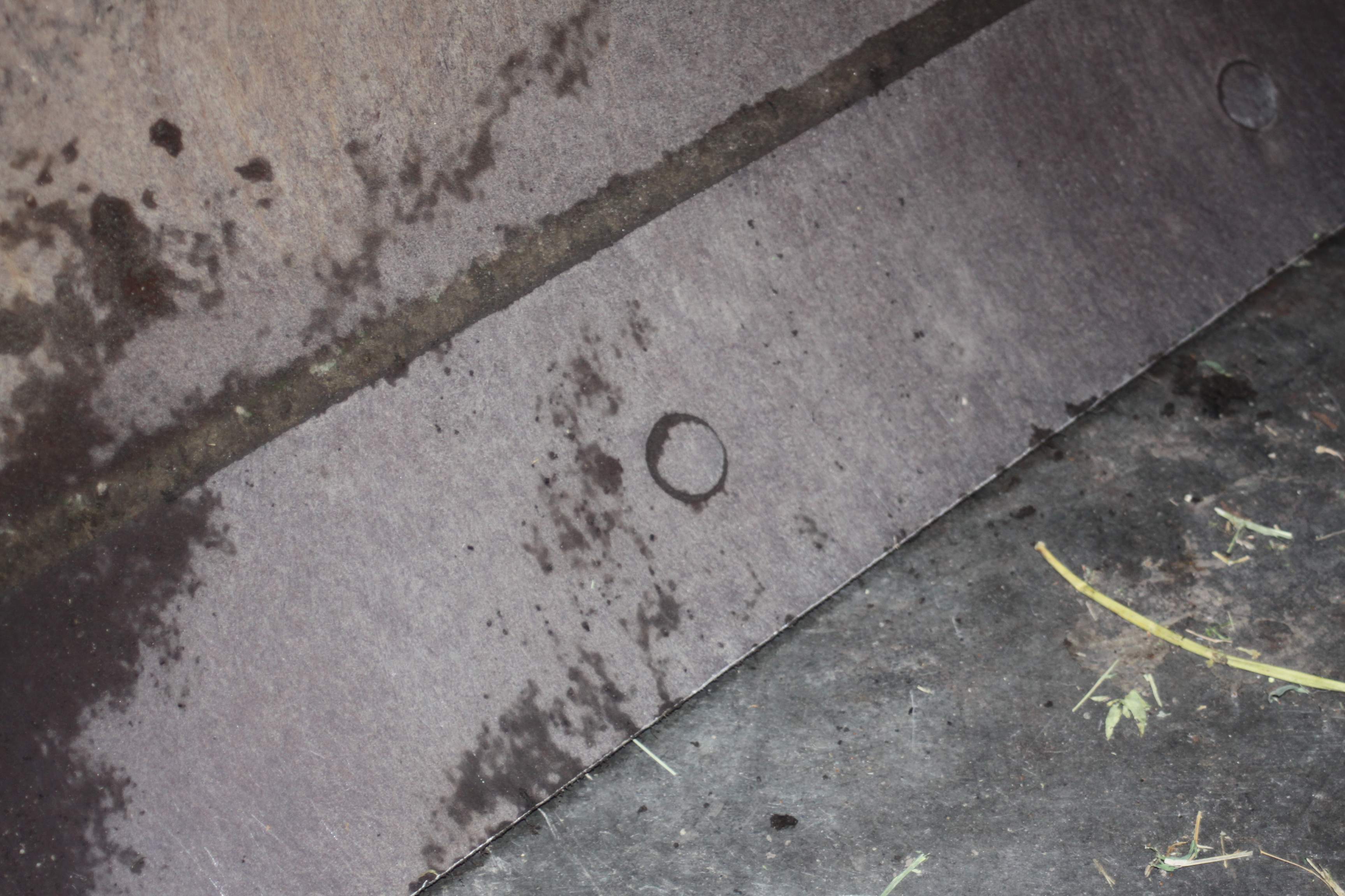

After I finished, I spent some time looking over the blade and discovered that there is 1/2" worn off the cutting edge and that it has never been flipped. Picture 2 shows an end shot of the cutting edge and picture 5 shows the front.
I also discovered that my blade is offsetable by 12" to either side by removing the blade from the boom and reattaching it in a different set of mounting holes. Picture 3.
I discovered that if I tip much past level, the rear edge of the blade draggs on the ground. Pix 3 & 4.
