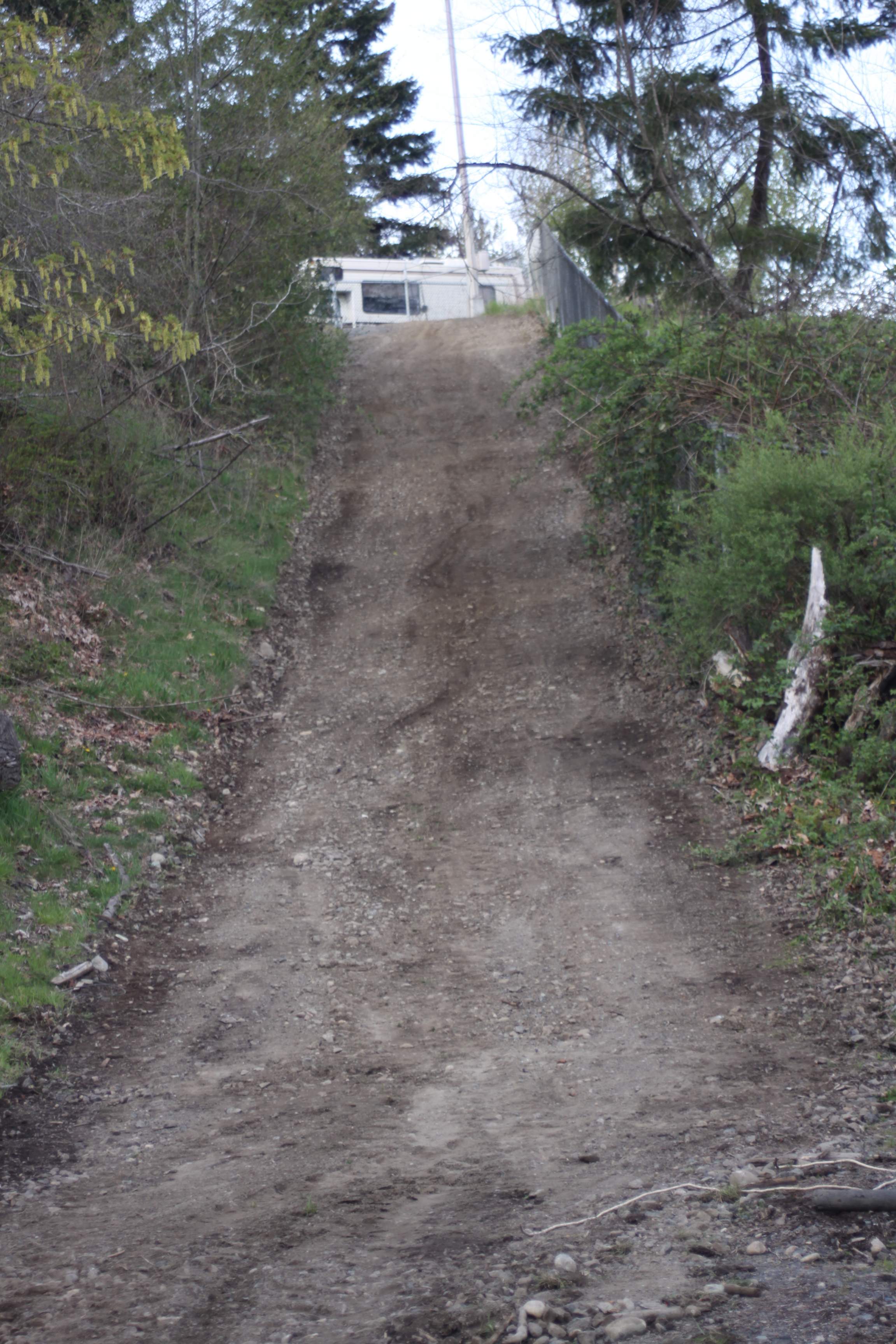

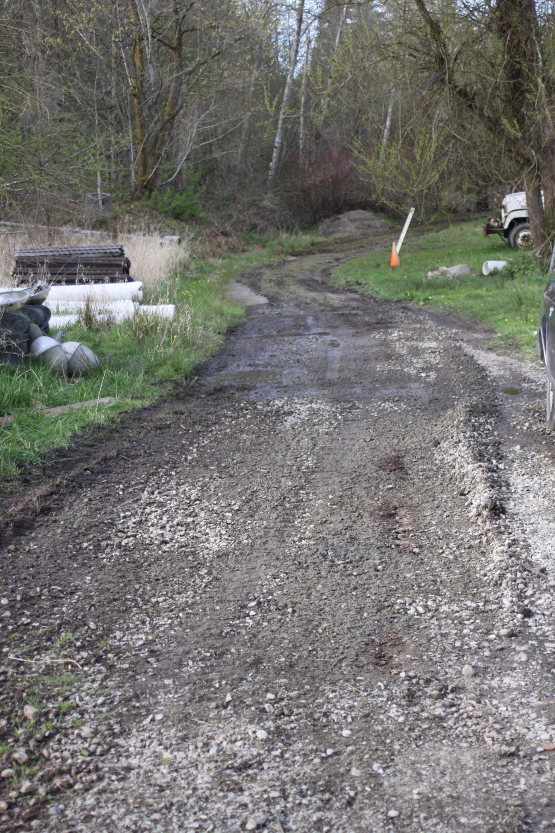

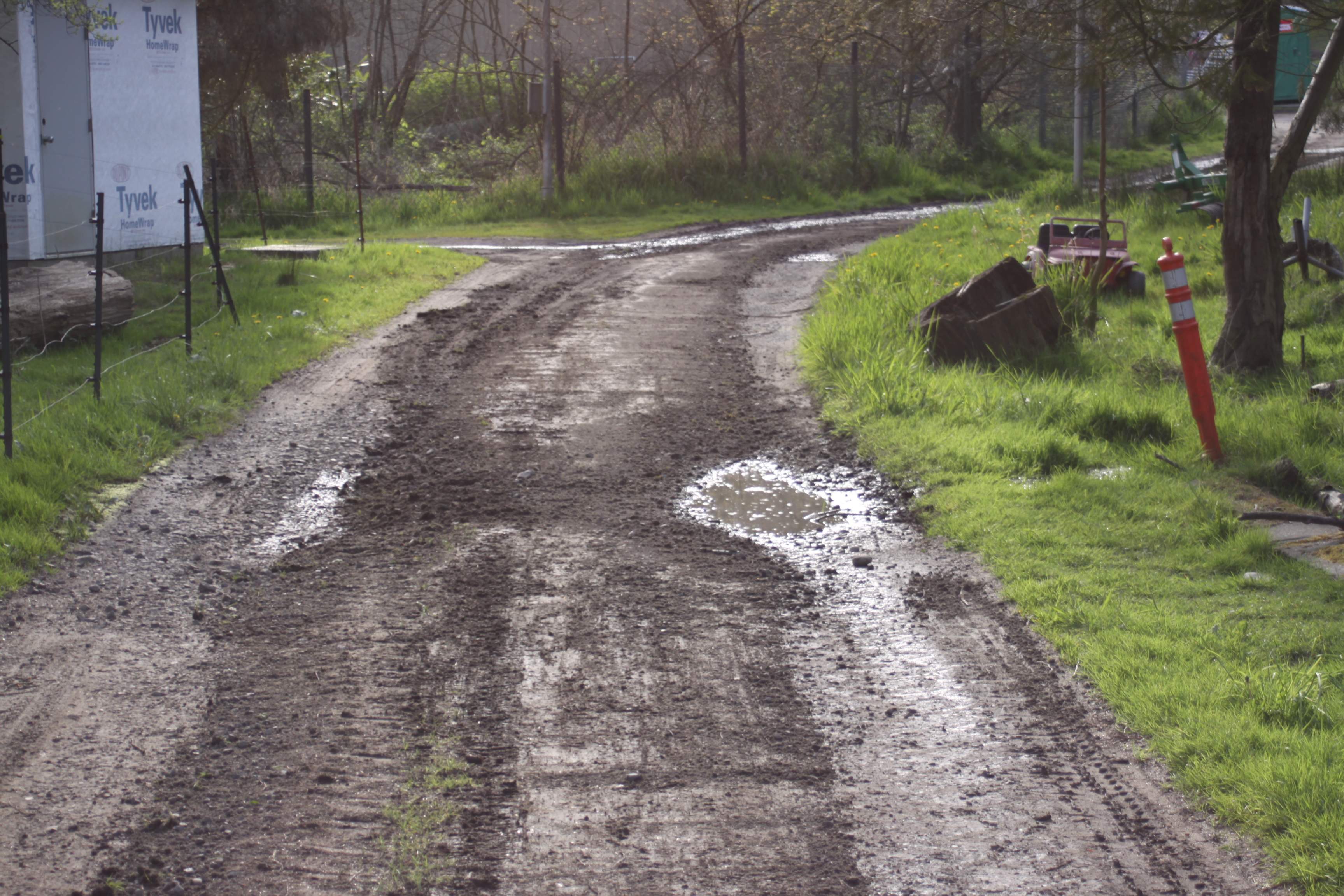

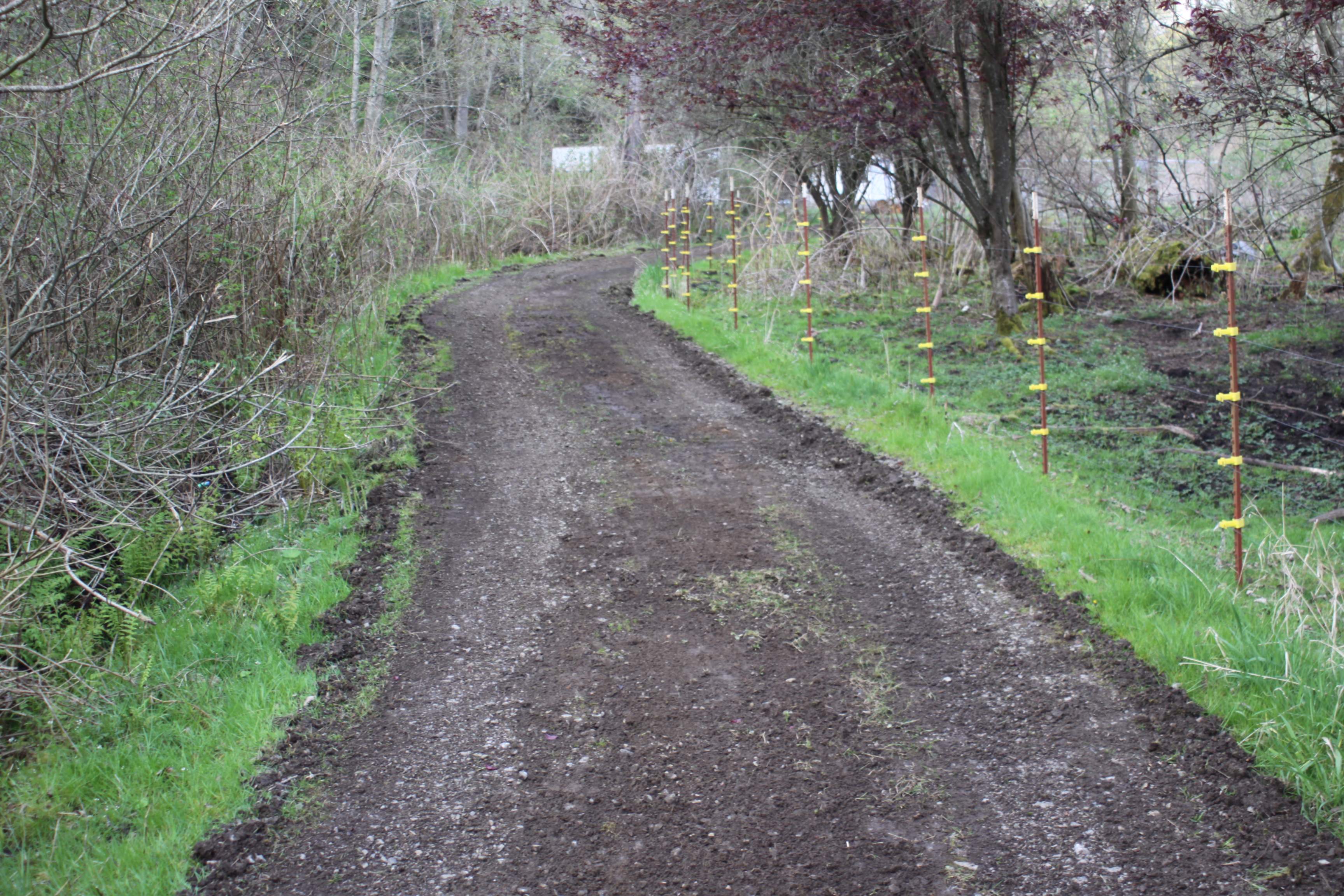

Here are some pix from after I tried some grading.

Cyril,
Looks like you are making progress. I find that the more I angle the blade (so it pushes the dirt to one side) the more aggressive it cuts. You can push the dirt to the center of the road then square up the blade and shape the road into a slight crown. Finally, spinning the blade around and pulling it backwards will smooth things out without accumulating dirt.
Also slowing down helps a blade dig in. Sometimes if the cutting edge is worn parallel to the ground it will actually help to shorten the top link to put the leading edge in contact with the ground. Of course flipping the blade for a fresh edge is best.

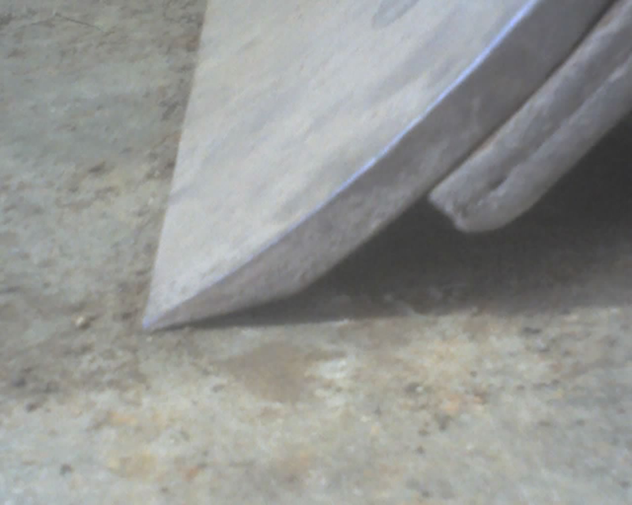

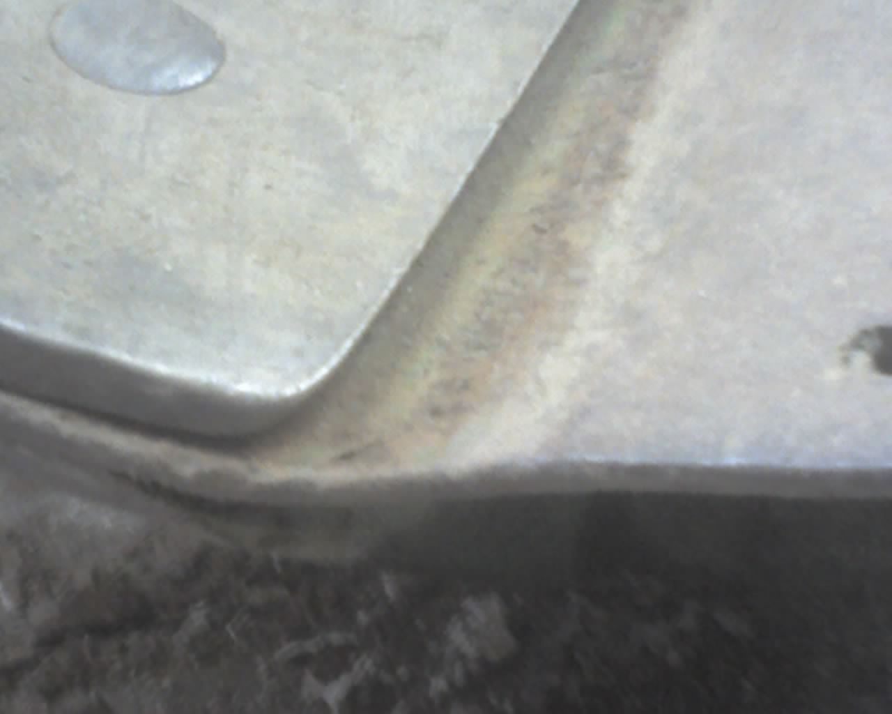

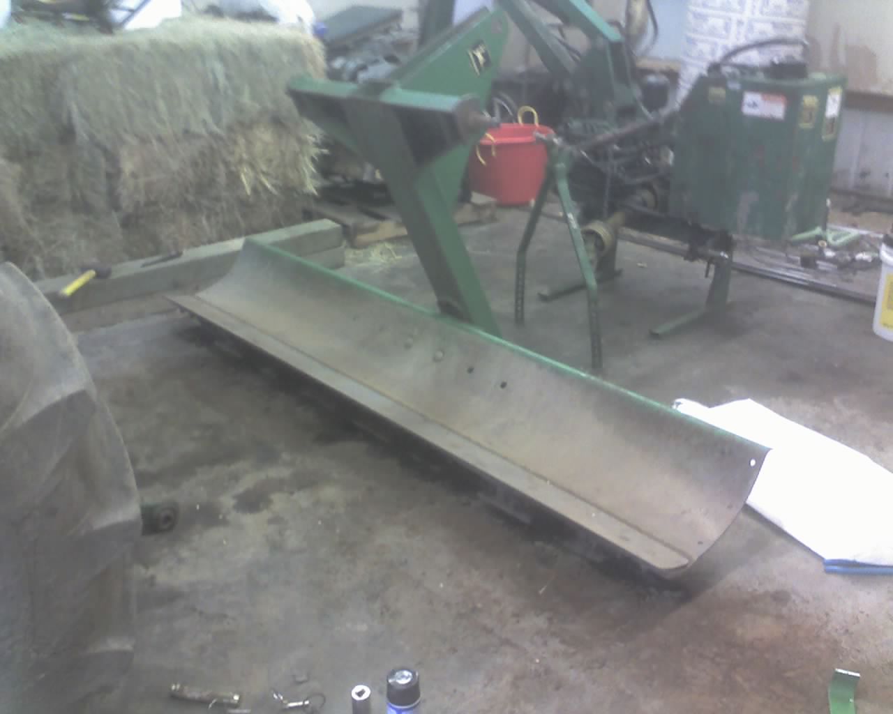

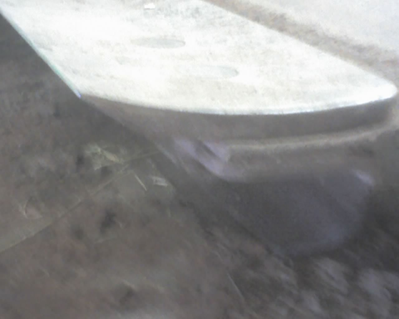

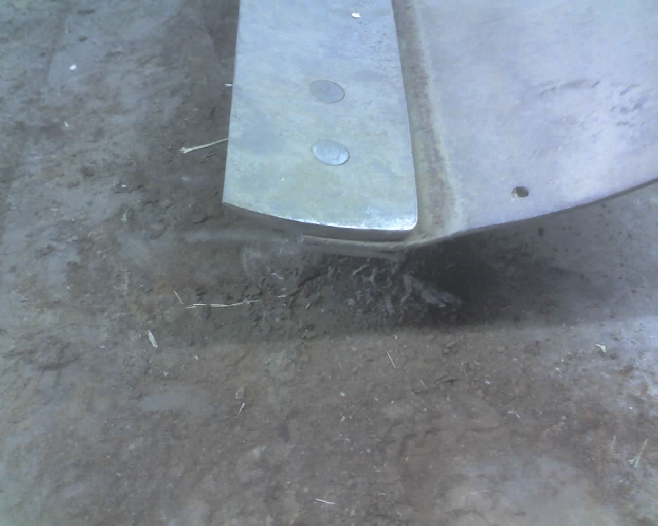

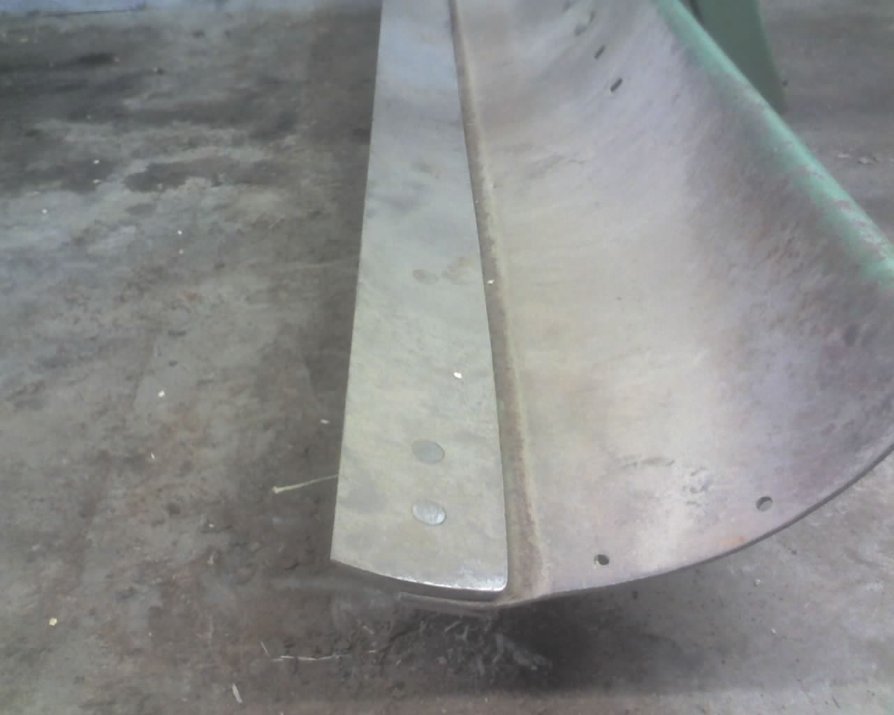

My question for play in the blade wasn't for side-to-side movement, but rather tilt side-to-side. In other words, if you were to put a block under one end of the blade and lower it, how much would it angle before the block supported the full weight? I found most of my problems tonight I think. With the exception of the bolts holding the cutting edge on, every bolt on the blade was loose.
I tightened the Cat 2 pins and that helped alot. I'm going to have to check them though, because the holes in the blade are much larger than the threads on the pin. In fact, the lock washer just fits inside the hole and is actually keeping the pin centered in the hole.:mad: The bolts which hold the blade to the boom are also loose, but were rusted to the point I could not budge them either tighter or looser so I sprayed them with YEILD snd eill try them again another day. I'm currently down to about 2" of tilt from 6".
I also flipped the cutting edge tonight. Those bolts were tight and are tight again now that it's done. What a difference looking at the angle of attack on the bottom edge of the cutting edge when attached to the tractor.
Here are some pix from my cell phone while the blade was off the tractor and the cutting edge had been flipped. Sorry for the poor quality. The lens get so much dirt on it that it just doesn't clean any more. Scratched I think.

I think that you are going to be surprised at what a difference all of this makes. Now I can hardly wait for you to bend it while rolling all that dirt. As you know, there's a thread that can help you out deciding on a new one that will work good for you. ;) Now you're going to get us a picture similar to that one of mine that you posted, right? :thumbsup:
