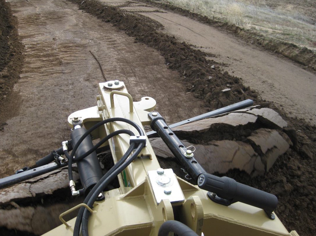

The main area I wanted to attack, was where I had a dump truck tailgate spread 10 yards last year. I discovered that I'm not 20 any more and said scr*w this and put the shovel away last year. I regraded that area Saturday with the front bucket in two passes. The rear blade just slid across the top of it when I tried last month, yet it was still soft enough to dig with a square point shovel.
I figured I'ld better post and figure out what I'm doing wrong after looking at pix in another thread and seeing Mtnviewranch post this picture.
   / Why doesn't my rear blade cut? #17
That Woods rear blade, which has hydraulic blade tilt, offset, and angle, weighs in at a whopping 1100 lbs plus. I'd dig too if I weighed that much...
Chilly
#18
Chilly
I'm not sure what my old JD 65 blade weighs, but I'm guessing around 500#. It's built solid so maybe I'll see if I can figure out a way to add about 500# to it and get it up around 1K# and try again. LOL
