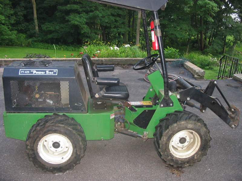

Mine's mounted on the right FOPS/ROPS post. It is a general-purpose, Type ABC, good for either electrical or flammable liquids.
PTRich had just used duct tape to tape the wall-mounting bracket to the post. I've simply refreshed that duct tape, and wrapped the whole post with electrical tape (similar to the way we used to tape the handles on baseball bats), since I also ran wires to canopy-mounted lights up the inside of each upright.
BTW, in this pic you can see the proximity of the clear (actually opaque white) plastic gas tank to the Kohler engine on my 2001 model. The hydraulic tank is under the seat, at the front of the rear tub, but there's several hydraulic lines in the engine compartment itself, where they attach to the pumps, rear wheel motors, front PTO solenoid valve, etc.
The newer PT's moved the engine farther back, with all the pumps in front -- but unfortunately, that puts the hot muffler up front, closer to the gas tank. On the Kohlers, the exhaust is on the rear of the engine, above the PTO and steering/lift/tilt/Aux PTO pump. The tram pump is on the other end of the engine, underneath the gas tank.
